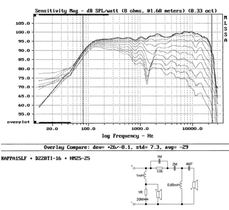

Here are some measurements of a 15" + 1" box: http://www.prodance.cz/protokoly/taurus_152-1_uprava_ladeni_megaton.pdf
What would be your opinion about this? I see some issues there - there are two dips off axis - but the directivity does not look too bad, does it?
I am not going to build these, but I would welcome any comments to learn what to look for in a good design. Prodance does measure everything they sell and even more, so it is a nice source of information for me.
1-2 kHz is a pretty critical range to have a massive off axis dip in. The response is tilted the wrong way so equalisation will have to be used to avoid it sounding overly bright. Only 95dB/1W. Cumulative spectral decay shows evidence of resonances. As the drivers are stacked vertically the vertical polars will be the most distorted, however I think only the horizontal is shown.

The 15" is crossed so high that the cone is in breakup so directivity differs a bit from a piston, this is likely to be the case for all 15" drivers around 2kHz.
The BMS4554 looks great, very high efficiency and advertised low crossover point. I use a P-Audio BM-D466 (1.8kHz recommended crossover) which has the same voice coil size and run it down to 1.5kHz at 'war' volume by using a 4th order (electrical) crossover in my tops. It may be possible to run the BMS a bit lower if you also used a 4th order crossover. Only a bit though as excursion quadruples every time you half the frequency even ignoring horn cut off related issues.
Already explained why 15"+1" (or 1.4" or 2") is a very bad idea.
