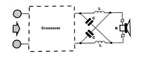

(here a quick example). You can stack those as well to introduce more "delay".

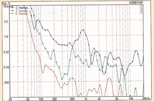

This is a distortion plot from the W4-1137SA variant @ 90dB (so that is NOT the ferrit SDF variant), tested quite a while a go in a german magazine.
Based on this graph, I wouldn't call it that great.
Could be that the newer SDF variant is better?
Personally also not fan on the looks (especially for that price!)

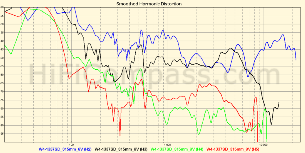

https://hificompass.com/ru/speakers/measurements/tb-speakers/tangband-w4-1337sd
HiFiCompass shows pretty good performance for the W4-1337SD, basically very similar in performance to the SB15NBAC
Do you mean the SB15 (5 inch) or SB12 (4 inch) ?
Because compared to the 5 inch, I don't agree
Also keep in mind that at hificompass, we are comparing voltage levels, NOT sound pressure levels.
So a 4 inch is gonna do less SPL at the same voltage in most cases.
I would find it extremely odd if a 4 inch driver like this would perform so close to one of the better 5 inch mid woofers out there, while having a lot less surface area.
edit: when we look at 90dB, the graph looks a lot like the one from hobby hifi if you recalculate the values to % THD.
Here the 1337 @ roughly 94dB
And the SB15NBAC ar roughly 94dB

Is that in comparison to other aluminum cone drivers? Titanium should not oxidize, so if it oxidizes easily, then I am not sure what is going on.Also of note, that the w4-1337 has an extremely fragile cone. Do not touch it, as it will deform or oxidize easily.
I should have been more clear when I said "basically very similar in performance to the SB15NBAC"... I was looking at both of them at 4 V, where they both produce approximately 90 - 92 dB, and I meant that both meet my HD criteria. Yes the SB15NBAC is superior. But I am not sure it is meaningfully superior.
