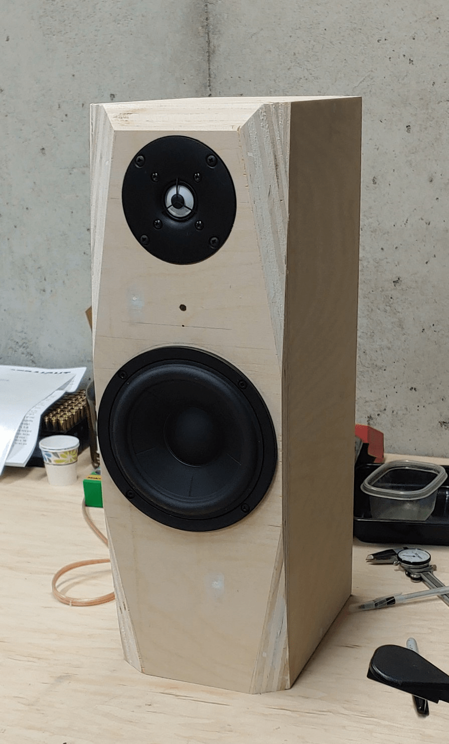

I did a quick survey of my friends and acquaintances who might build a copy of this speaker. There was a lack of enthusiasm for using a router guide bushing to route an elliptical recess. Much more enthusiasm for making a tapered bevel...
Just circling back on this. When you say tapered bevel, is this something that you had in mind?
How does one decide on where the taper starts and at what angle should it be?
In there a simulator that does it?
Intuitively I would say start a far away from the tweeter as practically possible, and go as close to the tweeter dome as practicality possible. And the facet should be 45 degrees. But intuition is fraught with danger.
Yes that is the general idea of a tapered bevel.
Heissmann did a study where they showed that anything from 30 degree to 45 degree was a good chamfer (bevel). This is relative to the baffle, so 0 degree no bevel at all.

I tend to use 33 to 35 degrees relative to the baffle.
The taper angle is mostly driven by the geometry of the cabinet. If the box was significantly wider than the woofer, we would not need to taper the bevel.

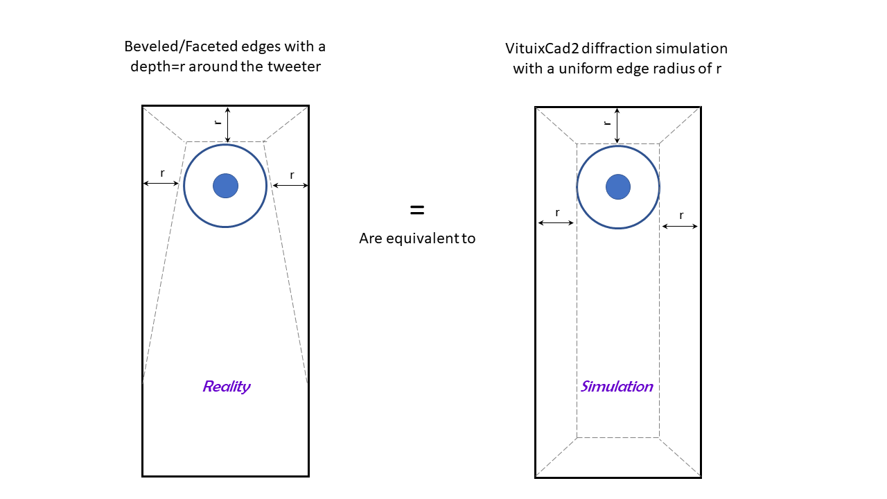

I did a study where I showed that a tapered bevel can be simulated in VituixCad as if it were a straight chamfer. I will try to find the link

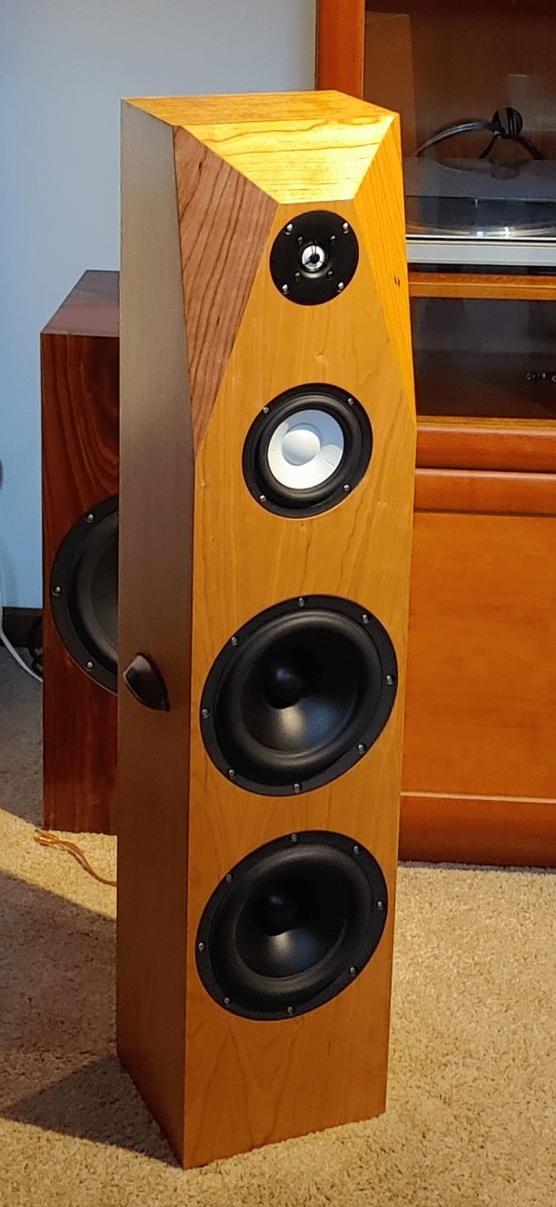

Here are some recent examples I have done.

Here is the link to the study I did. I built some prototypes from XPS foam board to see how tapered bevels compared to simulation.I did a study where I showed that a tapered bevel can be simulated in VituixCad as if it were a straight chamfer. I will try to find the link
https://www.diyaudio.com/community/...ations-with-ideal-drivers.380658/post-6986539
Posts 211 - 225 show how the measured data compares to VituixCad diffraction simulation.
The final conclusion of this is

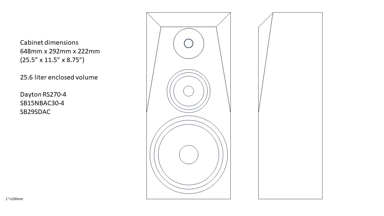

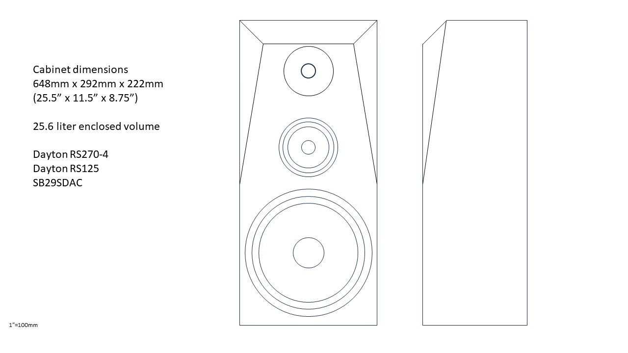

Here is a concept sketch for this project. The design is not finalized, but things are coming together. I have firmly decided on the Dayton RS270-4. The SB29SDAC has the right combination of directivity and low-crossover capability, and the price is within budget. I have not decided on the midrange driver yet, but the two leading candidates are Dayton RS125 and SB15NBAC30.
j.

I would suggest the RS270P-4 with the paper cone instead of the RS270-4 metal cone. You get another 2db and much smoother breakup. I just used it little brother the RS170P-4 and I'm quite happy with it.

Re: RS125 vs SB15NBAC
RS125- wider dispersion, good looks (consistent with R270), smooth top end roll off.
SB15NBAC-narrower dispersion but more Sd, lower distortion and potentially better (particularly if you extend the speaker with dual RS270!),
Tough call!
Either way, I think you’re going to have lots of builders, I think for this high performance, high value, active hybrid.
