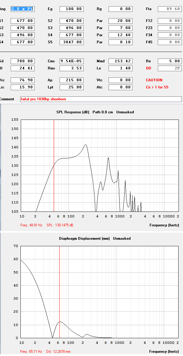

faital pro 1030 hp probably would have been a good fit. giddily awaitin ups to drop my first pair off here in a minute.
notice I shortened the port a bit. stronger motor (and lower vas) seems to maintain the LF output even when this is done, and tuning (displacement minima) is only about 5hz higher

Yes, looks like the Faital Pro 15 1030 hp works in a small box too.
Your simulation Fb is around 46 compared to 39 Hz, (almost 1/3 octave higher), using double the 1000 watt AES power rating, using a driver with a lighter weight cone than the Dayton PA385-8. Drop the power to the rated 1000 AES and tuning to 39 Hz and there is not much difference on paper.

yeah, 100v would probably make them angry :p I raised the port tuning because they still hit similar (filtered) spl at 30hz as the daytons, even with the port raised.

The faital hits xmax at 75 volt in the mini othorn. I'll pm you for details on how to measure distortion (I have smaart 7, but very little skills in using it). I can measure the mini othorn, but the RS15 imitators (straight ported) are in brooklyn, so I doubt I'll be taking any measurments off them any time soon.
It hits xmax at 80 volts in the dual 15 BR enclosure (that's not extremely undersized).
the faital has an extra 2.5mm of excursion, thus the greater output capabilities (excursion limited) even with higher port tuning. If it can take the power thermally is a different matter.

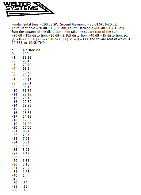

To test distortion with Smaart, you can simply run sine wave tones (Smaart has a sine wave generator) at the voltage you have decided to test at, then "save" the resultant RTA trace.
The difference in level between the fundamental (test tone) and the harmonics generated (distortion) can then be compared to the graph below to determine the distortion %.
Obviously, systems like LMS or REW that read out distortion directly are far less work, but I still find it interesting to see how the harmonic distortion content looks on an RTA, the relationship between all orders of distortion can be seen at once for each test frequency, examples for various subs including the PPSL ShoeHorn are in the OP.
