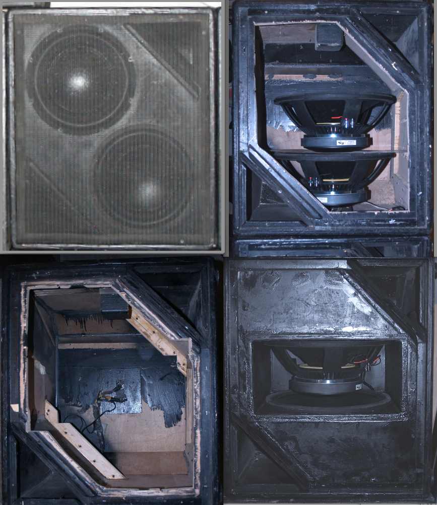

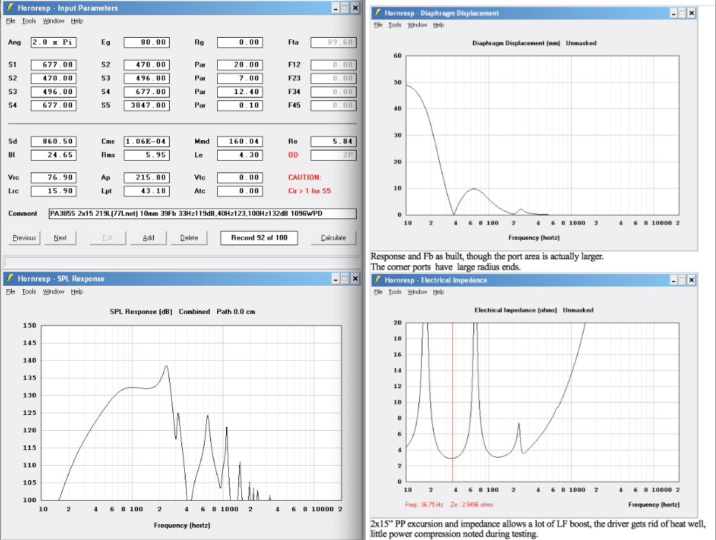

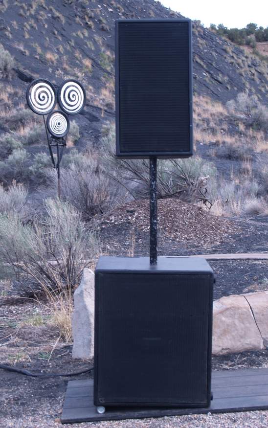

The 15" Dayton PA385-8 driver makes a very compact bass reflex cabinet with very high output and relatively low cost possible. Although this cabinet is considerably undersized, reducing potential low frequency output, the high power handling and relatively high Xmax make for good output down to 30 Hz, with actual measured output at 60 Hz over 130 dB at one meter, comparing favorably with commercial cabinets rated at 140 dB peak output. With EQ, a very wide range of 30 to 200 Hz is quite usable, the LF boost required to flatten response is done at frequencies where the speaker excursion is normally at minimum. The EQ used for the "PPEQ2" chart below was a DBX DriveRackPa set with 24BW filters at 30 & 100 Hz, PEQ +9 at 31.5Hz with a Q of 2.63, -12 at 67 Hz with a Q of 1.57.
Having a pair of empty 26.5" x 22.5" x 22.5" cabinets available, but wanting more upper bass than previous Lab 12" speakers they were designed are capable of, the Dayton PA385-8 looked like a good choice, a Hornresp simulation showed as much 40 Hz output and almost 9 dB more 100 Hz SPL. Fitting 2 x 15" on a baffle that just barely fit 2 x 12" required using a slot (plenum) to fit. However, my first simulation was based on an overestimate of the actual interior net volume, which is only about 77 liters net, after accounting for the ports, handle area and push-pull plenum reductions. After test results showed less low frequency than expected, re-figured the cabinet volume and adjusted the Hornresp inputs, the resulting simulation match the LF response closely. The response of the upper end differs a bit from the simulation, the upper peak is lower in frequency and level. To achieve the 39 Hz Fb with the smaller cabinet volume required installation of a 5.75" long 3/4" thick plate with a 22.5" angle each end into the existing triangular corner ports. A 1.875" plate was added to the rear port entrance for more symmetrical port operation, the plates also brace the rear of the plenum.
Originally I had planned to test the cabinet both as push-pull and push-push, but physical size restrictions only allowed the push-pull arrangement. The driver with the exposed magnet structure is connected reverse polarity, both drivers provide positive pressure with a positive signal. Push-pull orientation cancels much even order harmonic distortion, which for the Dayton PA385-8 is probably a good thing, as distortion still came in higher than any of the pro PA drivers I have tested, the push-pull pair showing over six times the average distortion of a B&C18SW115-4 at similar LF output levels. The Dayton PA385-8 forward and rearward excursion offset (cone position forward or rearward from at rest position) was quite visible during testing at various frequencies, the cone position can be quite inconsistent with single tones, though with pink noise or music it was not so apparent.
The PA385-8 has very little power compression, the venting design gets rid of the voice coil heat very effectively with very little noise, though plenty of lingering adhesive curing stink was evident during (and after) each high power outdoor test. There seems to be more port and slot compression than power compression, the response falls off slightly at both ends of the passband, while almost linear midband at the maximum pink noise output available from the SpeakerPower SP4001 used for testing. The magnet structure only rose a few degrees over ambient temperature in any of the tests.
On a cost per output ratio, the Dayton PA385-8 scores really well, though if low distortion is a high priority, this driver does not fare well compared to more costly alternatives, as can be seen in the examples below.
These small cabinets won't win any sensitivity awards, but given around 1000 watts per driver, the output is quite good, the walls of my shop made flapping noises during the tests from 22 meters away. At about 115 pounds, they are not lightweight, but the weight makes for a very stable base for pole mounted top cabinets. Loads of kick for the size, and upper response that can go high enough so pint-size top cabinets can be used and still have plenty of low mid "grunt".

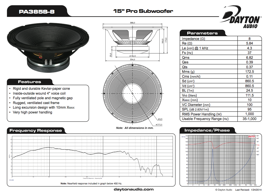

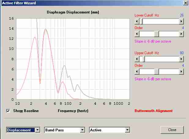

Chris,It looks like you're boosting around Fb. Any worries about burning the drivers with high power and minimal excursion?

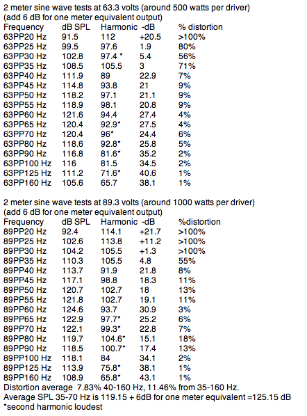

Dayton claims "RMS Power Handling (w) 1,000" for the PA385S-8, which if correct may be equivalent to an A.E.S. rating of 1200 to 2000 watts depending on the frequency the power is applied at.
As I don't generally play sine waves centered at 39 Hz (the Fb, excursion and impedance minima) the cone will generally have plenty of movement at high power to pump hot air away from the voice coil, and the power amp I am using with the drivers is only capable of a little more than 1000 watts per driver. For heavily compressed program material with sine wave like content, limiting RMS voltage to around 75-80V would be prudent.
As a comparison, when running sine waves of equivalent of 400 watts to the Eminence Lab 12 (rated at 400 watts AES), the magnet structure would be hot to the touch after a suite of tests. The same tests using around 1700 watts in to the B&C 18SW115-4 (rated at 1700 watts AES) resulted in a slight warming.
The same tests using around 1100 watts in to the PA385S-8 (rated at 1000 watts AES) resulted in little warming of the magnet structure, and minimal power compression, a confirmation that the voice coil temperature is not extremely hot.
That said, enough heat is generated to make the adhesives used stink far more than I have noticed in testing any other speakers, hoping that the curing process is finished before the drivers are used at high power indoors.

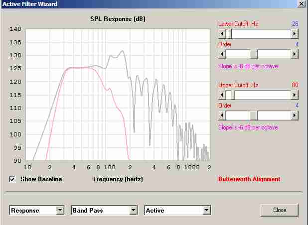

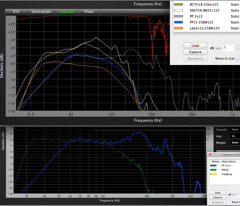

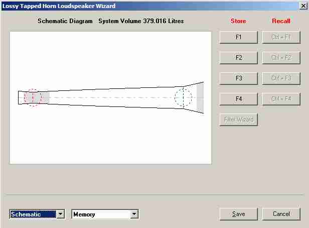

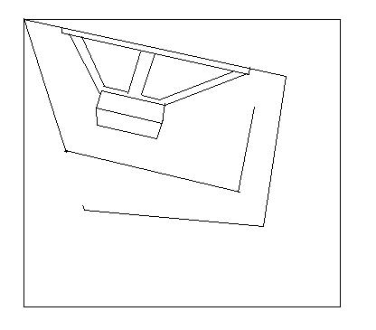

I'd work out a fold, and get out some inexpensive wood, and try to build this TH:

For "solid" (meaning -3dB at 40 Hz) response an increased net volume from 77L to around 180L with a 36 Hz Fb would increase output at 40 Hz and below by about 3 dB, reaching X max at 68 volts instead of 80. If you don't care about distortion, you could reduce gross cabinet volume dispensing with the PP plenum, but with a larger cabinet volume the plenum volume becomes relatively smaller, and a good portion of it is taken up with the volume of one of the drivers that otherwise would be displacing chamber volume.
If floor space in the clubs you might work in is as limited as it is here, my suggestion would be to use a 22.5 x 22.5 base dimension, make the vertical plenum offset to one side at the bottom of the cabinet so weight distribution is still centered (and the cones won't sag), use a large venturi shaped slot port on the opposite side, and increase the vertical cabinet height by the appropriate dimension to allow for the net volume increase.

Thanks for taking the time to come up with the tapped horn design in HR. Very nice looking frequency response, with some serious low-end! I will have to play around with that myself. I see you had S1 larger than S2, which is untypical. I had also used approach in some of my HR designs. Is there a particular T/S factor of the Dayton PA385 that makes that necessary? Thanks.

Xoc1 did a nice job w/ his SS15 style TH-18, that general fold would be a good starting point.

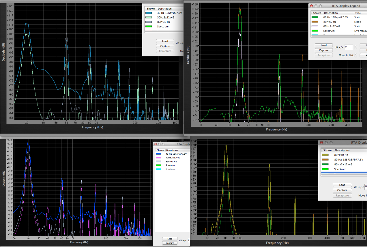

As to consideration w/ distortion @ high output, there are quite a few different distortion mechanisms, and the TH addresses some of those. PPSL mounting addresses some others..
Tom Danley uses a larger S1 in many of his TH designs, the Xoc1 TH-18 is a good copy of the DSL TH-118, the SS15 is similar but does not share some of the attributes.
In every TH I have measured, distortion has been higher per given excursion than the same driver in a BR, what "different distortion mechanisms" are you referring to?

What are typical distortion values that you end up getting for the TH and the BR? I think for the same displacement, the TH is more efficient and produces higher SPL so do you normalize for equivalent SPL output? Is 0.5% THD at 95 dB for 2.83 volts at 1 meter a good value to have from 40 Hz on up? I am just wondering what people consider is "good" and what the state of the art "good" is?

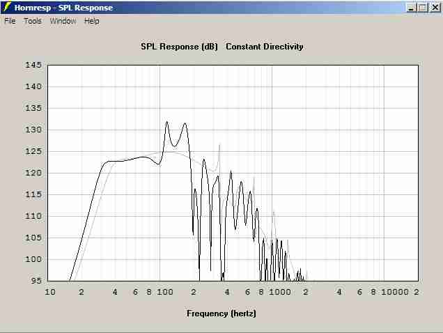

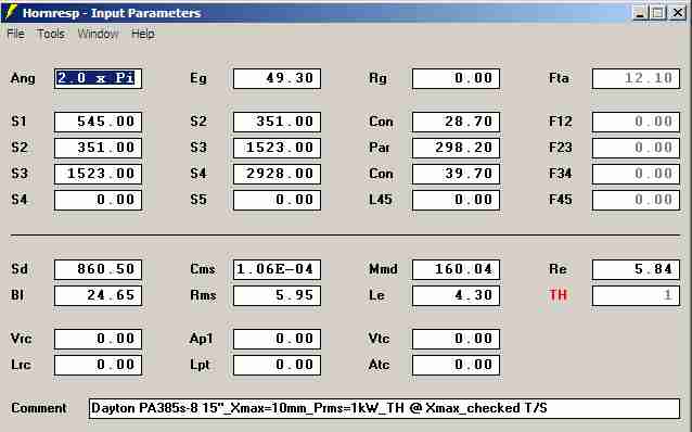

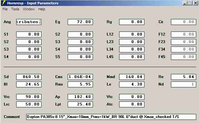

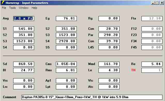

I'll attach two Hornresp simulations which (by accident) ended up @ about the same SPL around 40-70Hz when driving the PA385S to Xmax.

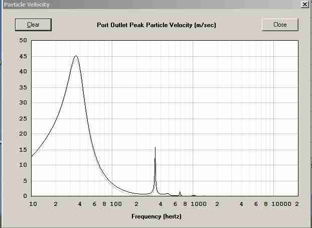

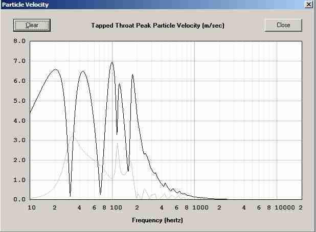

The BR needs Eg=72V to reach Xmax, and the TH Eg=49.3. @ 40Hz the Br's port particle velocity (input and output) is still quite high (~41 m/sec), getting below 15 m/sec around 60Hz. The TH throat/mouth particle velocities never get past 7 m/sec. We can safely assume that there will be higher losses in the BR that the simulation does not show.
At the impedance minimum around 39Hz the BR consumes 863 W. The TH needs 408 W @ 30Hz and 192 W @ 65 Hz. The reduced power input should result in much improved thermal behaviour for the TH, and the TH should have superior cooling characteristics through the placement of the magnet assembly in the mouth. There should be higher power compression in the BR as it is using more power to get to the same SPL, this in turn leads to even higher power needs when we are looking @ actual measurements.
While the BR is free from throat compression (distortion) it does have port compression (distortion), the TH does have much more favorable particle velocities.
The size of the radiating surfaces is much larger in the TH which should provide it with improved radiation resistance over the BR.
Anyway, those are substantial differences which should favor the TH, but, as Tom Danley has said measurements trump simulations. Have you had a chance to measure the distortion of the TH-118?
