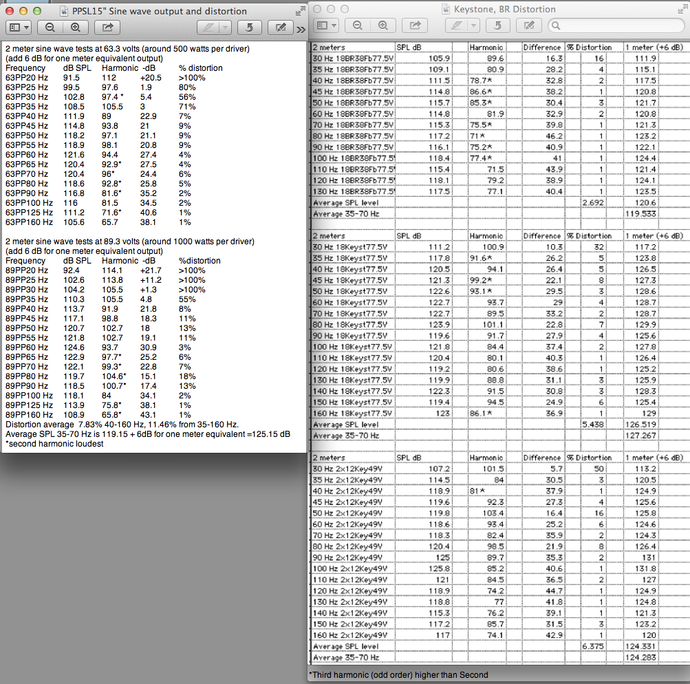

No, I have not measured the distortion of the DSL TH-118, but have measured the distortion of my Keystone sub using a BC18SW115-4, which has nearly the same frequency and phase response of the DSL TH-118. I would expect them to have similar distortion, loaded with the same drivers.
You simulations show a single 15" TH of 379L and a BR of 90L, my compact sub uses 2 x 15" in a net 77L chamber.
I would expect the much larger enclosures to have less distortion for a given SPL output, and a TH of the same size as the PPSL "ShoeHorn" to have more distortion.

All the designs I have tested are primarily for PA use, since no one likes to lug around more cabinets than needed, usually PA subs are used near their limits, so I have never bothered with one watt measurements, but one can assume distortion would be far less than my tests carried out at (or above) full rated power.
The tests include a variety of speakers, used in both TH and BR, (examples of the actual measurements are in the OP) and although the larger TH have as much as six dB more output, the distortion has always been higher than a BR with the equivalent SPL, so a pair of the BR would have similar output but lower distortion.
As you can see below, the B&C18SW115-4 output goes up around 6 dB from the BR to the Keystone TH, and distortion almost exactly doubles, though to tell the truth, I can't hear the difference between 2.7 % and 5.4% distortion. When <100 Hz distortion gets above around 10%, it may start to impinge on the quality of "clean" music sources.

The PPSL ShoeHorn (not very efficient, but small for a PA sub capable of over 130 dB measured output at 1m) does 85 dB at 2 meters at 50 Hz outdoors with one watt, I tested it at about 1000 and 2200 watts, power levels in line for it's intended use.It was at 85 dB at 2 m quite a bit louder than a clock radio 🙂
