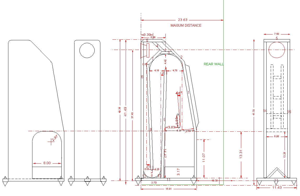

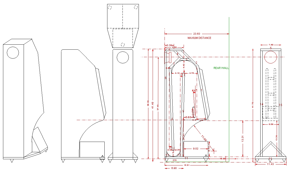

A126 Side firing design.
Hi Scott.
Ron provided 2 options for the Austin A126 design, the omnipresent back firing one, and also a side firing version.
Both were discussed at length at James' site, but if I remember correctly the back firing one had a revision over the side firing one. The plans sit together at the Frugel Horn site.

Actually it doesn't. It vents to the rear, the deflector being to smooth the expansion out onto the rear boundary, where it is then reflected forward.

Gaston: I may be wrong, but that may well have been a thought exercise - i.e. I'm not sure of how many (if any) builds of the side firing version were executed, and/or how they might compare to the rear-firing.
I can say that a slightly modified version (i.e. larger coupling chamber) of the rear firing version remains after several years now the most overall satisfying enclosure design I've yet* encountered for the FE126E.
(*IOW, Scott has been a busy boy)
Ron provided 2 options for the Austin A126 design, the omnipresent back firing one, and also a side firing version. Both were discussed at length at James' site...
I know. I was there.
...but if I remember correctly the back firing one had a revision over the side firing one.
Not exactly. As Chris notes, the latter was never finalised.
