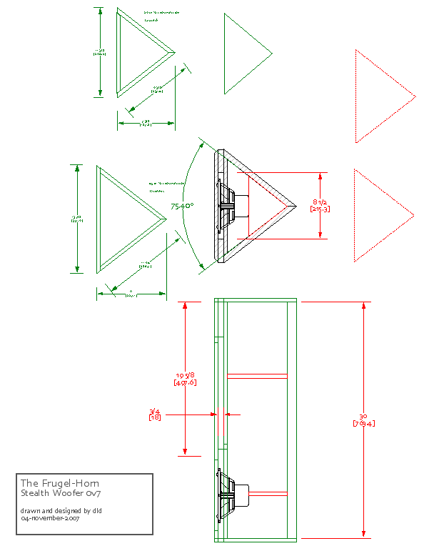

The idea of the stealth woofer came up even before the original documents were released.
There is at least 1 picture of someone turning their rectangular subs 45 degrees and using them as FH deflectors.
Attached is an early (vented) idea. Note that the depth is increased to get the cross-section up.
With the discovery of how good the SDX7 sealed was... useful plans for a FH Mk1 Stealth Woofer
http://www.diyaudio.com/forums/full-range/138884-my-frugel-horn-build-13.html#post1779987
The taller FH3 means more volume to work with. So more woofer choices.
dave

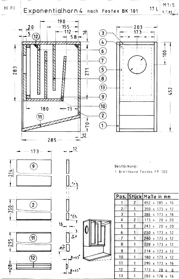

On another note: I've read that you still have your BK101 in your workshop. I wonder what's that like since at one stage I had some notions of building the later version (BK10). (I've read someone stating that he retired his Spendor 2/3 after getting the BK101).
Do you mind veting an opinion about the BK101 (and how you think the BK10 will relate to it)? Many thanks in advance, AM.
The BK101 are OK. The key to my really liking them is that we put the posts on the front so it is easy to hook/unhook them.
dave
