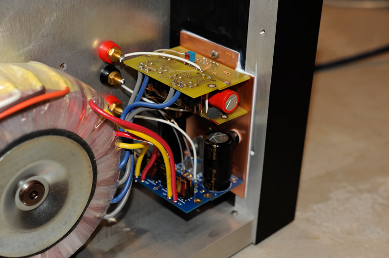

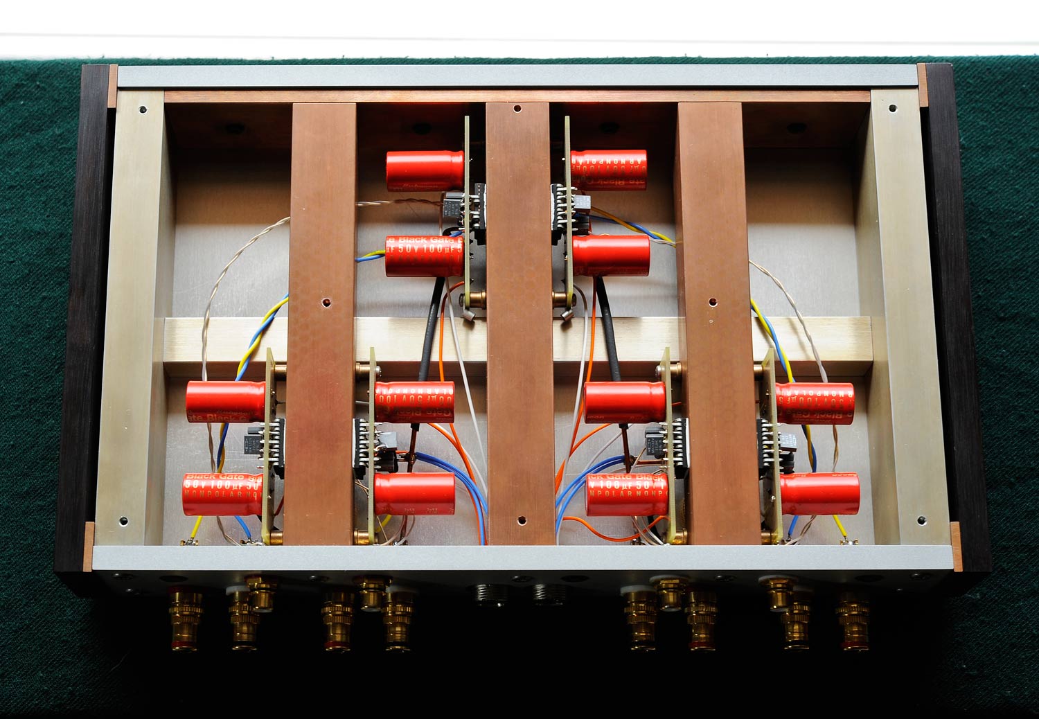

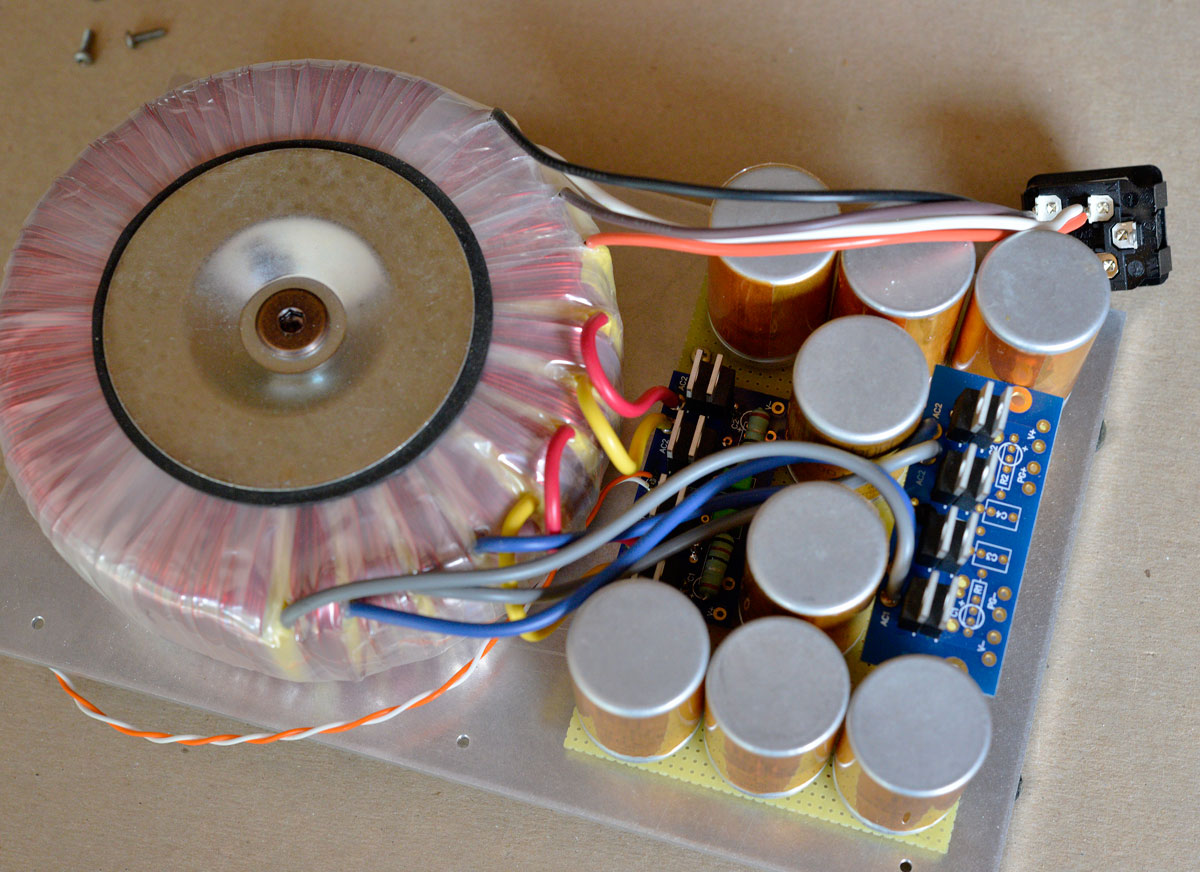

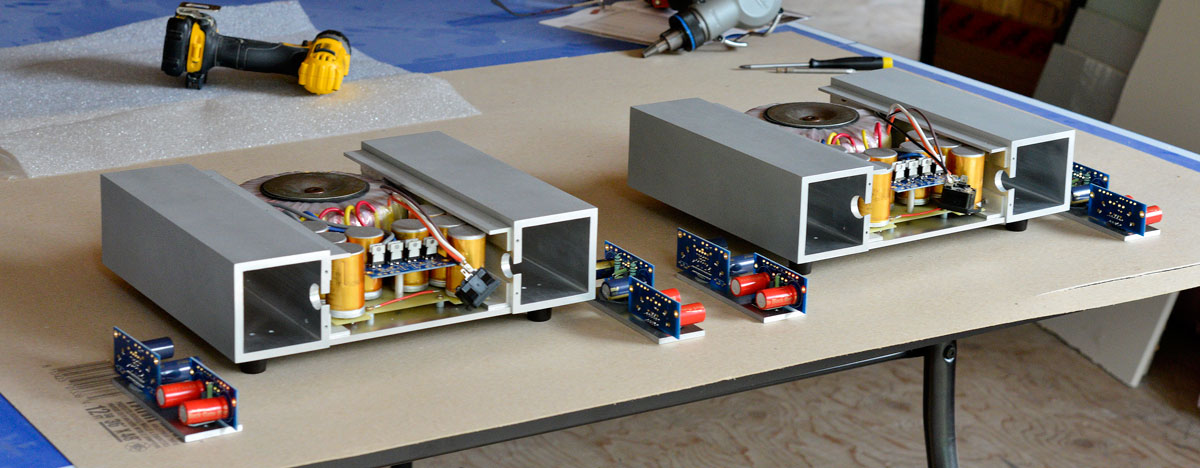

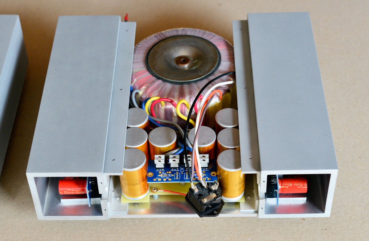

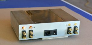

I would attach the chips to the front panel directly and use some angles to connect front and sides for improve heat transfer. In that way the chassis becomes one big heatsink and it should be enough to dissipate all the heat.
While what Andrew says earlier is all valid, it relates more to a typical SS amps, which Gainclones not really are. I've built numerous amps in some weird enclosures with very little metal parts and it all proved to work correctly.
For instance: 6 channels in an enclosure much smaller than yours.
Cheers Peter, I was just going on what I've read with the higher heat from higher voltages. Bolting it to the front plate sounds like a good idea but I won't be able to sleep knowing I've got longer signal wires, the case is quite big, I wanted it to be a chassis for all occasions. Still, i dont want any unnecessary bits of iron i dont need. What do you think about running multiple 3875 boards? I would like to keep it simple but I don't want to connect my powered subs to a single board if it could compromise the performance. The spare boards came from a friend who has decided not to build the amp.
The heat is mostly generated by speaker loads and how loud you play, higher supply voltage does not really matter if you don't push the amp.
I wouldn't like long signal wires neither, so why not attaching the angles to side panels, You may add additional small angles to the front.
If you plan on subwoofer, using separate channels for that purpose is definitely a good idea, it also doesn't need to be a premium version.
Here's an example of another design, with two main channels and two sub channels.
I also used a transformer with two separate sets of windings: 2 x 20V for main and 2 x 25V for subs. This allowed me to separate PS components: 100uF BG N for main channels and much more capacitance for sub channels. Not mixing those two bank of caps was very critical to achieve specific tuning of the sound.

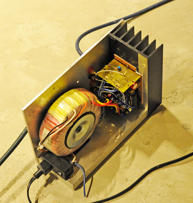

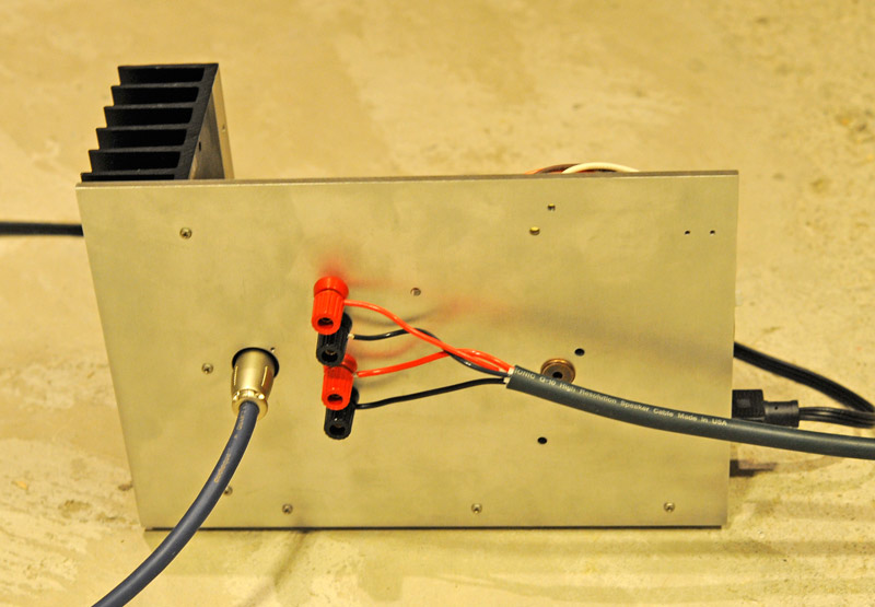

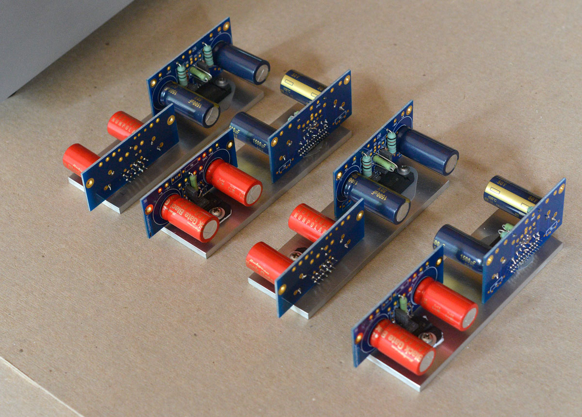

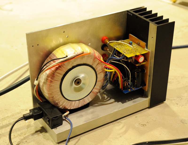

The main, full range channels should have very low capacitance with quality caps. BG N 100uF are perfect for that, but they are expensive and hard to find. Some people complain that the amps might not have enough "juice" for the subwoofers, that's why in that case I suggest more capacitance, up to 10,000uF, but only if the main and sub channels are separated, each having dedicated power supply.
Here's one other amp, I've built for my personal use powering Altecs. It is completely balanced with LM3875 for full range and LM4780 for woofers. I didn't add any extra capacitance in low freq channel as the speakers are very efficient.
BTW, the heatsink gets barely warm and those are monoblocks.

I like the vertical arrangement. The slim enclosures can be stacked side by side for a neat installation. Or stood behind a speaker and not take up much space.
