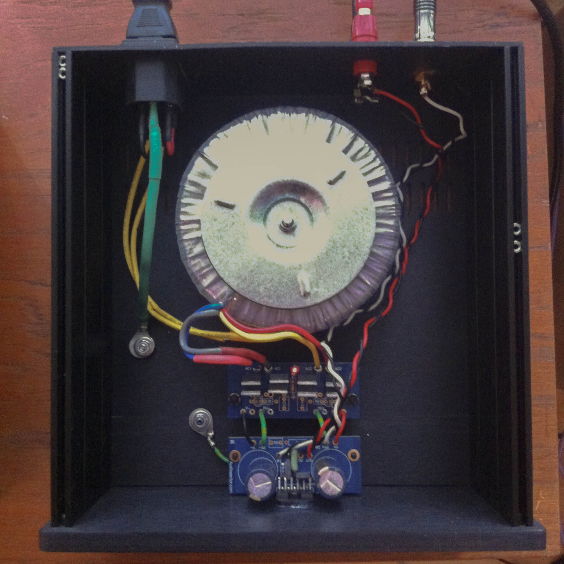

one amp reconfigured. finally.
one to go...
NO hum this time.
but still some very low radio frequencies are coming from the speaker.
this time it is so low that maybe putting on the chassis top-panel will make it dead quiet?
* picture attached.
should I shorten down the cable going from the MEM ground to chassis?
green/yellow wire connected to chassis : is connected to signal ground pad on the side not seen on this picture.
Thanks for all help so far- it definitely has been a long quest for me; this exact amp build. the amp sounds really REALLY good.

try to find a piece of Green/Yellow cable and replace that green cable from PE to Chassis.
Green lloks too much like a ground and could confuse some less experienced Builder that looks inside.
What are the two yellow wires that disappear under the IEC?

The two yellow wires are the two power wires going to the toroidal transformer.
they were originally one layered ( white in color ) , I put on sleeves for safety reasons.
The two yellow wires are connected to the end of the MEM - with ON/OFF switch / fuse holder and a IEC socket on the top.

Double insulate the mains wiring.
Since the aluminium case looks to be anodised, (a very good electrical insulator) I suggest you interlink some of the panels with bolted connections and stranded insulated wire.
Maybe the back panel to the side panel, next to the IEC and the floor panel under the IEC. These three panels are the highest risk, if a mains wire breaks loose.
Twist the mains wiring to reduce emi.
Twist the two sets of secondary wires.
Reduce the size of the loops in the audio in out wiring.

I would also move the input wires as far away as possible from the transformer, they appear to almost touching the transformer.
I have used long twisted pair interconnects in unbalanced connections in many orientations around, over, under transformers and along along mains cables, even those feeding digital components and could not hear any deterioration in the output at the amplifier.I would also move the input wires as far away as possible from the transformer, they appear to almost touching the transformer.
I also tried star quad as long interconnects using the same rigorous subjective testing and again found no deterioration.
As a result I have become a firm believer is LOW LOOP AREA as one of the best ways of minimising interference. And recommend it to Members (repeatedly).

Andrew, Your advice is, as always, sound and practical. I would agree that a well constructed (tightly) twisted pair offers very good immunity to interference. Nonetheless, I consider that routing signal cables away from transformers and mains cables is good practice.
Your advice regarding making good connections to anodised components is something that often causes problems to the unwary, I usually use tapped holes or self tap screws to ensure continuity.

TEST of one monoblock:
HUM+NOISE at the output ( speaker terminals ) = 1.2mV AC
I have no longer any issues with radio frequencies :
* twisting and double isolating the two wires going from the MEM to the transformer.
* rearranging the signal + signal ground wire ( shortening the wire + twisting the wires + installing the RCA on the front panel )
* rearranging both speaker terminals ( shortening the wires + installing both speaker terminals in front )
1.2mV AC is too much - what to do next?
PS: I have a 2X25V , 300VA transformer. Chassis Ground is still connected to SG ( signal ground ) - NOT the CHG pad.
I consider >1mVac as too much.
I expect every power amplifier to be <0.3mVac and most of mine are <0.1mVac

Why is my output on both amps ( 1.2 mV AC ) so wrong?
Does anyone have an idea?
I measured the amp with still starground and with rca + speaker terminals on rear panel.
This amp also measures 1.4 mV AC
