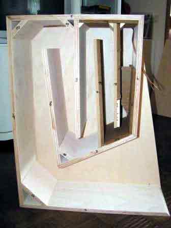

I was busy again on the weekend and added another small TH to my website. I used the Tangband 6,5" again in a 38Hz single folded TH. It will make use of a 4,7mH coil to even out the response.
I'm still waiting for the coils and some spare time to set them up. But once again it was a pleasure to design and build them (we had nice weather here and bbq and some cold beer was available al the time :spin: ).
Some more pics and the plans for this TH are on my website as usual.

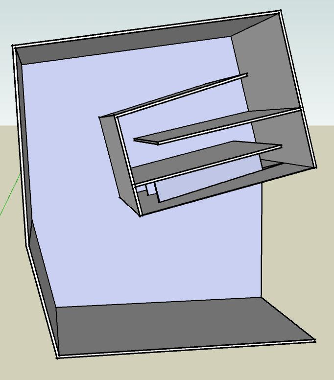

I have played a little in google sketchup and came to a folding, which looks kind of like an old backloaded horn or a th115. What do you think about it? Is this folding scheme worth a try? I came to this, since i would like to use the horn up to relatively high frequencies. I had to keep the individual segments rather short, since when an internal dimension is 1/2 wavelength in length, a standing wave occurs.
The driver sits directly at the mouth. In the picture, the membrane would face upwards. The first segment expands only in the width dimension and looks like a V between to plates. It is the same as in the dts20. I use it to get a smooth transition between driver width and horn width.
Hm, i realize that it is really difficult to describe. I hope the picture adds some sense to my words :cannotbe:

I really like the way you used the "V" ramps in your throat plates. Yes, it is just like in the DTS20. Your folding looks good to me. If you do not like, or need the tall and skinny box look, then this is how I would fold it too. One piece of advice for you; since your woofer will be so close to the mouth, you will get quite a bit of direct sound off the back of the cone. If you use a pro sound style woofer and not a car subwoofer type, you will get a surprising amount of high frequency off the back of the cone. While this may not be the best HiFi, it may help you cheat with a higher crossover point.
You want them to be < ~WL/pi of Fh until the bends have enough area for them to pass unimpeded, maintaining the expansion around the bends (i.e. cross sectional area WRT distance from the throat) to minimize reflections back to the throat or develop standing waves between folds.

I think the folding is fine :up: . Especially the way you did the throat is clever.
One thing I have always tried to avoid is to have a horizontal driver in order to avoid sag of the cone after some time. Since it is hard to say if a driver is prone to sag I tried to bypass this question by keeping the driver vertical.
To do so in your design you could move the mouth to where is bottom of the cabinet is now and turn the entire box by 90°. Alternatively you could design your box that it allows two positions for the mouth by introducing two removable panels. Then you could inforn us if it makes a difference then the mouth is on axis (what you have now) compared to off axis (what I suggested) ;) .
Add a significant amount of bracing. I was surprised to see how much power a 6.5" is capable to apply to the enclosure (even on a tapped horn which is an open duct in contrast to CB). The stiffer the better it is.
Erik

Hi all, thanks alot for the constructive comments.
GM, i dont know if i understand correctly. I try to repeat it in my words: First, the segments should be smaller than one wavelength / 3.14 of the highest frequency that should be reproduced. Second, i should pay attention to the expansion around the bends, so that there are no steps in the horn. Third, i can ignore the WL/3.14 rule if the horn is big enough to let the waves travel without problem. Do i understand it like you meant it?
JLH, i can use steep crossovers, so this will be no problem, as long as it isnt distortion that comes out of the driver.
Volvotreter, i remember Dan Wiggins of adire audio writing a paper about a similar problem and he had a formula to see how far the membrane will deviate from its normal position. This was pretty basic, just looking at the gravitational force, the membrane weight and the suspension. He came to the conclusion, that with his drivers, the xmax is only made smaller by a percent or so. With pro drivers and their hard suspensions, i think this will be no problem at all. One could also lay the box on the side and the problem is solved. But with "to sag" you probably mean something different - that the suspension loosens up over the time by the constant force which is applied to it. I have indeed not thought about this problem at all. The DSL TH115 has the same driver orientation, so i think it could be ok.
I will try to see what i can do in the final design, your hint about designing the box with two mouth positions is a good idea.

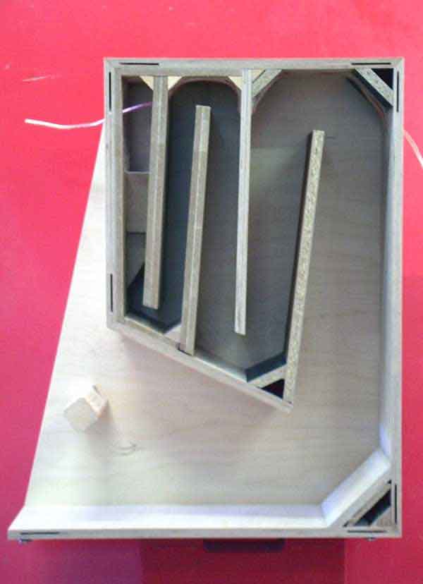

Hi MaVo: This is just something I drew when I was wondering what the inside of the TH-115 might look like. I just approached it from the outside dimensions. I do like the concept of being able to increase the horn length by raising the height of the box without adding additional 180 degree bends. Glad you find it interesting.:)
