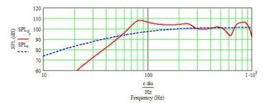

Peaking around 80 Hz is fine, but 1.5 dB won't even account for baffle step, which will probably 3-4 dB, much less any 'slam' gain. Then there's how the room will affect it, so no, a 1.6 dB peak/81 Hz probably isn't going to cut it.

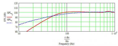

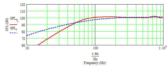

Half space sim of undamped cab:

It's a max flat impedance alignment without any stuffing. Did you get my PM regarding THs? I haven't seen any response.

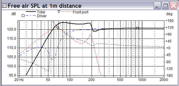

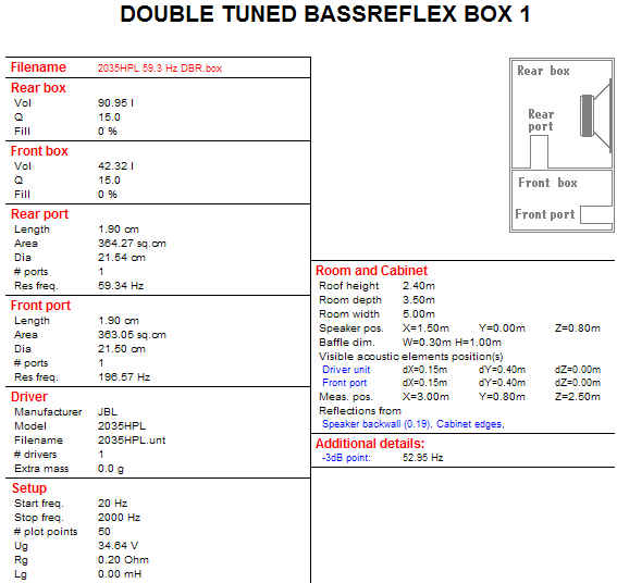

here's q quick 2035H sim in AJ for long vent reflex- what did U do above to peak it that loud? Freddy
http://img86.imageshack.us/img86/8862/quick2035ro8.jpg
ps - I've not had pleasure of MJK"s propgrams
Greets!
Please PM me with details.
Didn't do anything special, just a large, simple reflex, ergo no real cone control, but then at his desired peak SPL it's moot. You should get similar/same results in AJ using what I posted. Vent is 3/4" long.

that little scoop was 98.5 liters including a huge vent - wow GM - that predtion you did looks similar - how big is its chambers, how many vents and what tunings?
