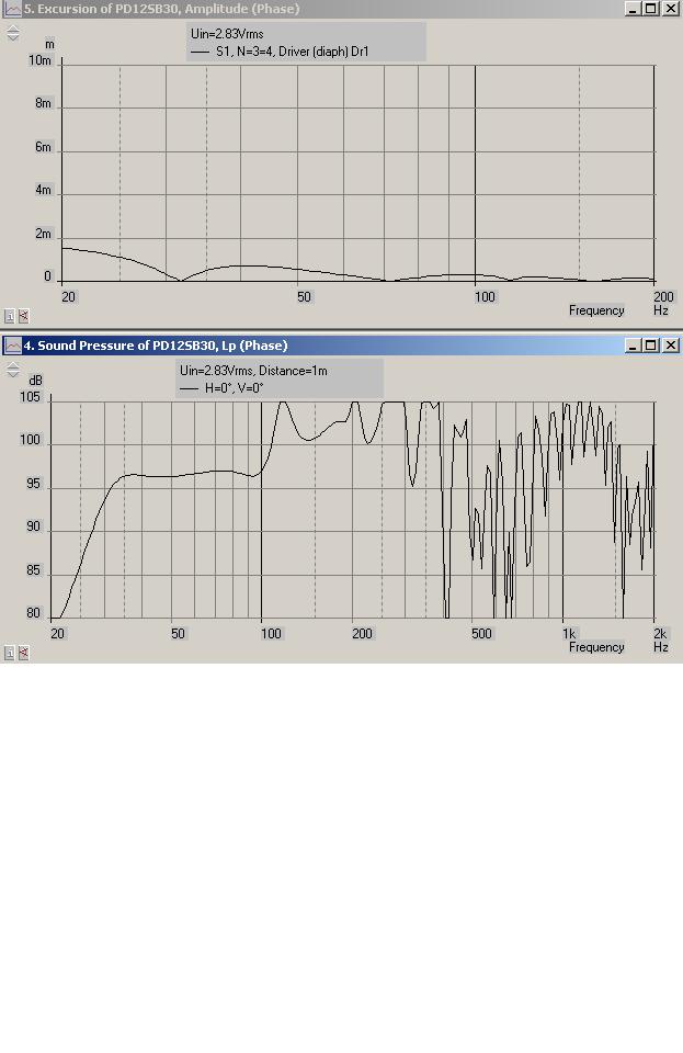

Here's a good one . Precision devices 12" and it's a flapper with 7mm xmax
Anyone else have any decent models going ?
cheers
316a

that PD12 does look noisy and climbing in the hit region.
here's sim on AJ as 3.2M "BIB" with driver offset 0.2* path length - might be a bit smaller (?) - look at power dip AJ predicts around 50Hz
PD12 BIB
http://img153.imageshack.us/img153/2325/pd12bibdr4.gif
PD12 180 sq.cm throat, driver at 0
http://img87.imageshack.us/img87/2650/pd12bibvs180sthdp1.gif
the Z curves must tell some story
