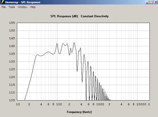

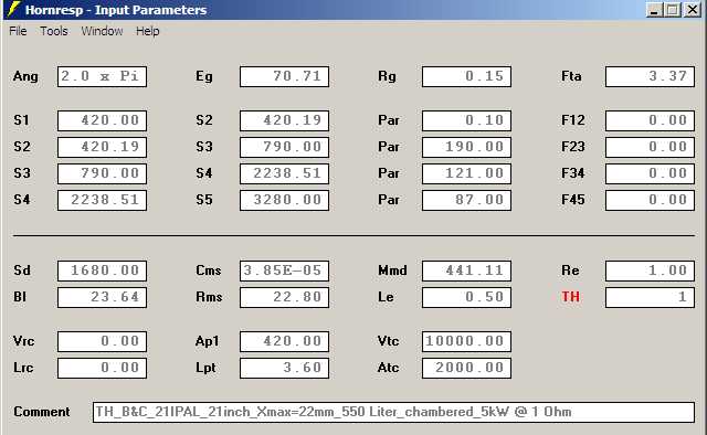

cannot get a nice sim for a th ,for this speaker ,unless i use verry high compression ratio😱
"cannot get a nice sim for a th ,for this speaker ,unless i use verry high compression ratio"
The Qts is almost too low to be usable.
It really is a crazy driver, huge output but very hard to design any kind of box for because of the huge BL/sqrt(Re) (30% higher than the 18sound 21NLW9600 which is the previous champ) and Mms -- a Qes of 0.22 with Fs=37Hz says it all, really.
You'd get almost exactly the same maximum output, efficiency and Vd with a couple of good 18" drivers like the BMS 18N850V2, which might even cost less and would certainly be easier to drive and design suitable boxes for.
I think this driver is a case of seeing what happens if you push driver design to the extreme rather than than something with real advantages over existing solutions -- unless you want to drive massive currents into a 1 ohm load from a class-D amplifier (which can use efficient low-voltage output transistors), like the custom Powersoft module...

two tapped horns, side by side, mouths forward:
1.22m high, 1.33m wide
from bottom up to 42cm forms rectangular horn mouth, full width. response of tapped horn about 40 to 140hz
simulating this to 2pi and having real difficulty figuring out exactly how much directional gain in the upper register im going to gain, because of the extra 80cm above the horn mouth and large width.
some attempts with this Online Baffle Step Calculation
questimating 6db level "corresponds" simulation to 1pi in hornresp. some rule of thumb would be useful.
You may be able to make a reasonable estimate from the empirical data collected in these threads:simulating this to 2pi and having real difficulty figuring out exactly how much directional gain in the upper register im going to gain, because of the extra 80cm above the horn mouth and large width.
http://www.diyaudio.com/forums/subwoofers/204472-multiple-cabinet-combined-response.html
http://www.diyaudio.com/forums/subwoofers/184986-horn-extender-wave-guide-th.html
The short answer is from 2-3 (near Fb) to 4 dB upper end forward gain. To find out the exact amount will require measurement.
