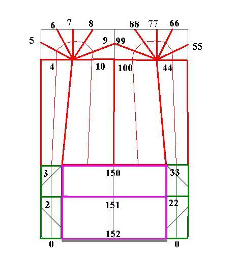

Here's a quick sketch of what I am trying to model . the 2 spkrs front load into a common cavity (what I called the horn) The rear of each spkr is kept separate from each other, as I want to investigate the effects of different resonant lengths being summed inside that common cavity.
I hope this makes sense.
OK, this is how I would start.
I have marked the nodes on the picture to make it a bit easier to understand. The thicker lines outline the individual segments, and the thin line is the distance to use. The green segments are ducts, red are waveguides, and the purple two are ducts or waveguides depending on whether there is any expansion to them in the dimensions not shown. The gray line is the radiator.
This "simple" model will not take the drivers physical displacement in the horn path into consideration. As that is a harder nut to crack.
Hope this helps.

The essential point is to understand that AkAbak allows you to split and merge ducts and waveguides. Remember to match the areas - if you are joining two 100 cm2 mouths to a single throat, the throat has to be 200 cm2.
Here's a basic 4 segment tapped horn schematic using Hornresp-like areas (S1 to S5) and segment lengths(L12 to L45). Exporting a design from Hornresp should produce a similar schematic.

soho54,
Thanks, I think I've got it based on how you defined the nodes. What I think is going on is, as a snippet:
Waveguide 'W3' Node=10=150 .........
Waveguide 'W4' Node=100=150........
Duct 'D5' Node=150=151.......
And, yes, I am radiating from the front, not down.
I guess what I was missing is setting up node 150 for WG3 and WG4 may have an area of 1000 each but D5's node 150's area could be at 2000 (example only). The ducts I used originally were intended to keep the areas constant, that was the only use. For whatever reason I assumed the areas needed to be constant
I tried this out in AkAbak with success.
Knowing this is going to go a long ways in my modeling. Thanks!!!!!!!!!

Don Hills, Thanks for the post. Must have come in as I was writing response to soho54.
You directly stated what occurred to me while looking at soho54's markup : the areas of multiple outputs can be summed into a single input. That is HUGE.
Now I will go back and read balance of your post.
Finished reading.
Yup, I got it. Makes sense. I can mash things together any 'ol way I wanna knowing this fact.
