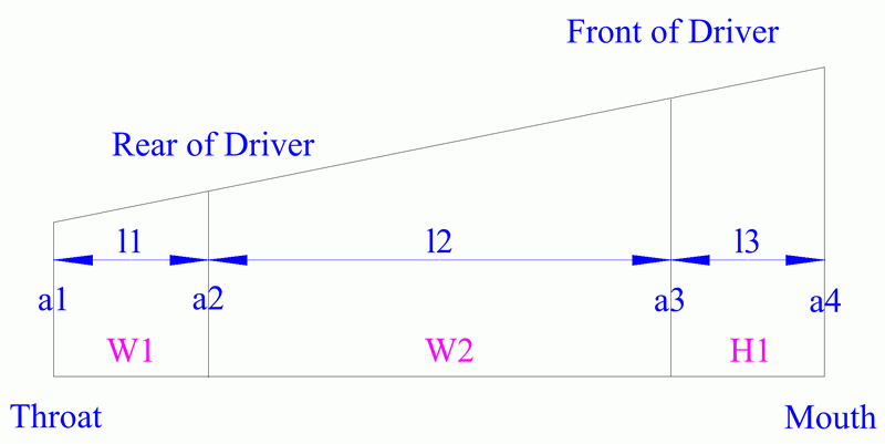

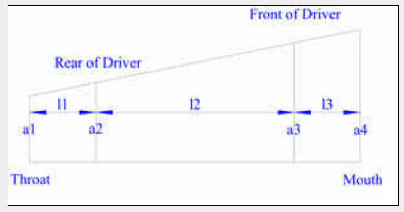

one more thing William - might you sometime clarify the TH model drawing and its nodes? - its a bit small to see.

Nodes? What nodes? All I see on his site is a dimensional drawing, which blows up nice n' large when clicked on.

Hi GM this one didn't seem to enlarge for me:
http://diy.cowanaudio.com/images/akabak.gif
a larger drawing and more labeling might help
FI
FI
G'day Freddi
Try this one. I didn't realise some people would have trouble reading the original image. I'll link it to a larger version. It's a little hard arranging the content on a web page because everyone has different screen resolutions, and the lowest possible screen resolution needs to be catered for.
Cheers
William Cowan
Cheers
William Cowan

A TH is a 1/4 wave horn, and as such, the geometry is not based on driver parameters. The length is based on desired tuning, hence tuning may in fact be lower than driver fs.
You have to decide on the following:
1. Line length
2. Mouth and throat area
3. Driver offset from throat (if any)
A different driver doesn't require a different box. It is not like a vented box where another driver requires a different box volume or tuning point with a closer connection with fs.

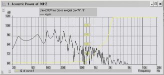

Monolith -= way coll looking driver but looks like 30Hz horn needs to be adjusted
http://img112.imageshack.us/img112/6657/30hzmonolithjk6.gif
I´d guess that this doesn´t count as a candidate for TH, since the "horn-part" isn´t really a horn, it´s too short to act as a horn considering the low frequency we are dealing with. More like a tuned enclosure with a widening port and the driver put slightly backwards. Because of the different phase addition there should be an increase in SPL compared to the same box with the driver on the front. The widenig port reacts slightly different then a straight one in a conventional reflex-design, tuning is higher (comparing lenght) and the Q-Factor should also be higher, yealding in a wider response of the port.freddi said:Thanks William.

look at the range, thats 10dB !
Could someone verify this? I just started to dig my way through in finding suitable drivers and pinpoint the paramters most important.
