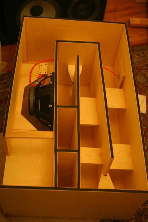

Thanks for the glue suggestion guys. I've used titebond wood glue with MDF before with excellent results and I'll use it for everything but the "lid". I'd feel better with something that will fill any gaps just in case.
The other idea I had was to line the top of the box and baffles with speaker gasket and screw the lid on.. screws every 8 inches or so. That way I can gain access to the horn if I need to add any additional bracing or hunt down a rattling bit of wire etc? Any reason why this wouldn't work?
Something about sealing up $260 worth of ply without testing it first is a little scary.
Foam gaskets work, but are not cheap when you need that much, maybe $20 worth or more to seal a big box.
For testing, you can even lay it open end down on the carpet without sealing it at all. It will sound considerably different than it would with a sealed panel, but it's a quick and easy way to test for rattles.
On one project, I "glued" the "lid" with silicone so I could remove it later. I was able to later remove the "lid" but not without considerable damage to the wood (cheap mdf) from prying and such. I wouldn't recommend trying silicone for this purpose. I am fairly confident though, that silicone could be used instead of glue in a pinch, although I can't imagine in being in THAT much of a rush.

I'd need about 737cm (24ft) of gasket which I have left over from a 50ft roll. This stuff should do the job at a reasonable cost, no?

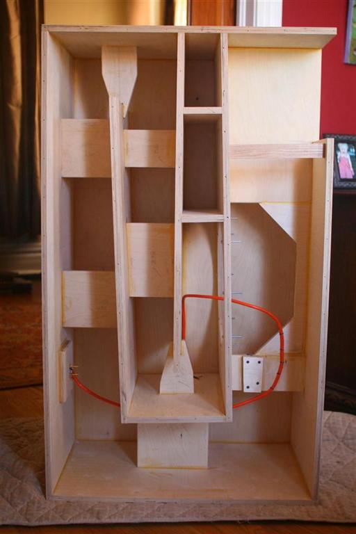

The box is a double folded TH which is about 133(w)x 82(d) x 50(h). which will take two 4x8ft and one 5x5ft sheet of (void free) BB to build. I bought the ply today and the total cost was a little less than expected - $215.
I really should make a proto out of OSB, but I don't have the time to make two boxes. Most DIY'er here seem pretty satisfied their horns are close to what HR predicted, hopefully mine will be no different... otherwise it'll make a great coffee table, right? 😀

Does the driver need to be flush mounted with the front (inside face) of the baffle? Since it's a doubled folded horn, it's a lot easier to just mount the driver on the back of the baffle, but does this offset S2 by the thickness of the ply (18mm)?
Mount it the easy way.
I've mounted drivers both ways, does not seem to make much difference, though one direction is usually much easier.
I doubt that the 18 mm is that critical. S2 and S4 would not really change that much - the driver hole only adds a small amount of area to S2. If you're really worried - glue/nail the cutout piece opposite the driver - that should mitigate all but the saw or router kerf.
Just make absolutely sure that the mounting hole is clean, the surface is smooth, and the gasket seals well (some well-known high-quality drivers have gaskets with gaps in them that cause leaks).
Oh - and be sure that your t-nuts are installed pointing in the right direction. (not a fun thing to find out...)

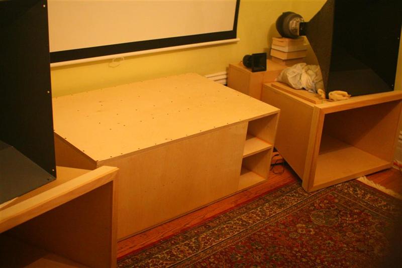

Sorry about the delay in getting back with some pics and impressions. My in-laws and parents were visiting from Australia and everyone was getting quite sick of my time hogging speaker building projects 😀.
Anyway initial impressions are quite good (80hz to 20hz). This TH is replacing two VMPS Larger subwoofers driven by two bridged crown XLS 402D amps. The VMPS subs were supposedly capable of 115db @ 20Hz. Sounds a little optimistic 😕.
As for the TH, the thing that stands out to me is the sound quality. I'm getting cleaner (less woolly) sounding bass than either the VMPS subs or my old B&W Matrix 801 sII speakers. It's almost as if you can count the pressure wave cycles below 30hz. Quite an obvious improvement, not something you have to listen for.
However, as a home theater sub I feel that a driver with more x-max would be nice. The new THX intro (the one with the mushroom) has my B&C 15PS100 coming awfully close to bottoming. I really should add a 16hz high pass filter since I'm running the sub wide open. Don't get me wrong though, it's an amazing HT sub that is more dynamic and solid sounding that the VMPS subs. Ridiculous performance from a single $200 15" driver with 8mm x-max! The down side is of course the huge size.
I'll post more impressions and the horns resp data when I've had more time with the sub, but for now here's a few pics. Aside from the midbass horns which my father inlaw did most of the woodworking on (I just watched and learned) , this is my first DIY project. Criticism and comment welcome.
