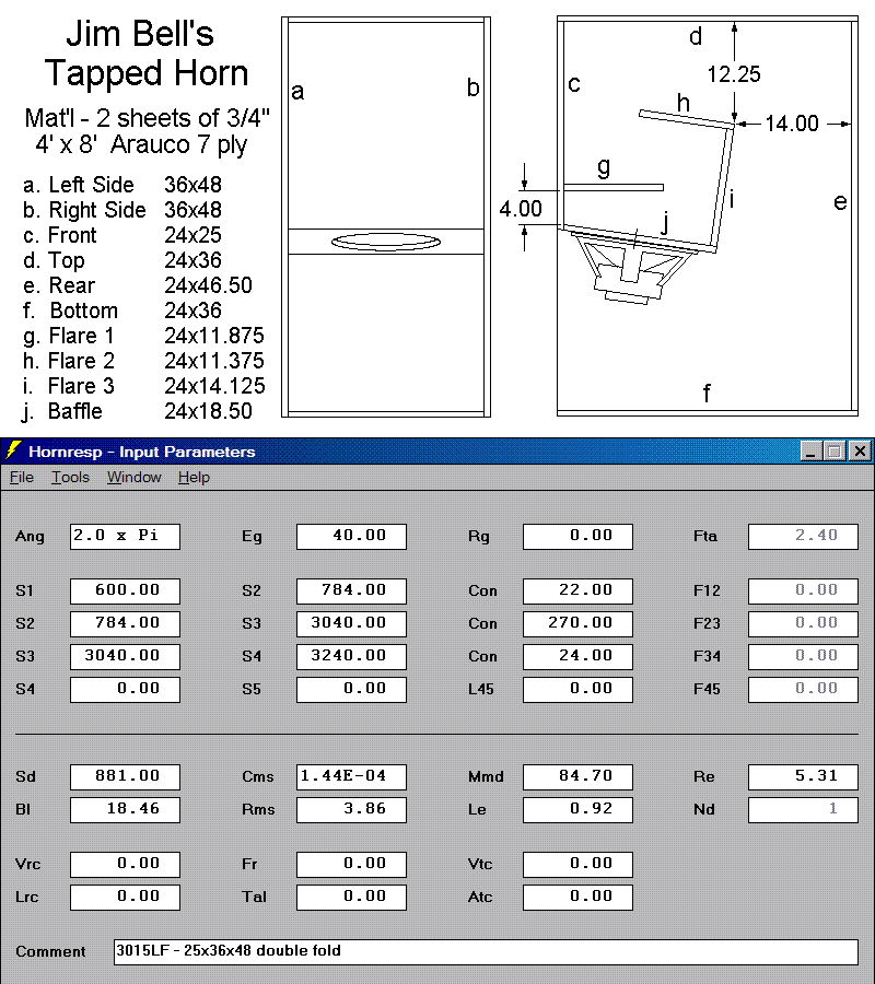

Here's my version of Jim's Tapped Horn. I ran this by Jim, and he suggested that I share it with the forum. This thing is BIG, over 600 liters, but that's not a problem for a fixed install.
The average guy should be able to get all of the saw-work done at a decent lumber yard, and complete it in an afternoon. If all the 24" cuts are actually 23 3/4", and cut with one set-up, he can even use PVA and everything will fit perfectly. If he's got a router and a laminate trimmer bit, he can even make it pretty.
The angle cuts on the front and the baffle are a little over 8 degrees, but Jim said he left them square and used PL Polyurethane expanding adhesive. No bracing is shown, which is either brave ... or foolish. Jim put triangles in the two back corners (see pic in <jbell's set of four tapped horns> thread).
Oh, and the driver is centered on the baffle.
~Don

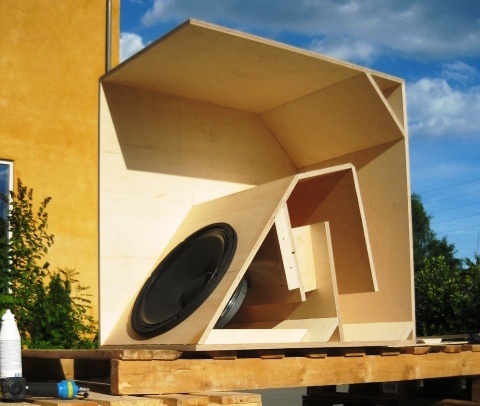

I finished the second and final tapped horn today. This one will be used by my younger brother in his dorm room XO'd at 60hz to his dayton refrence MTM's. I wont be able to hook them both up at the same time until this summer. One did sound cleaner and more authoritative than 2 sealed and 1 ported sub playing at the same time though. I can only assume that 2 of these tapped horns will be even more impressive.
Eventually I will have these XO'd to an OB midbass array of 8 10's per side (l @ r)at 60hz that will go up to 150-200hz.
