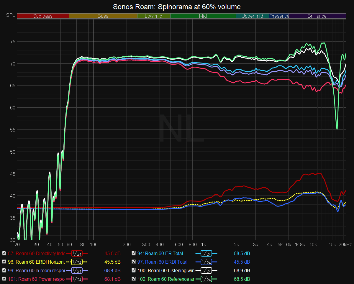

I'm sure planet10 is a far more reliable source than say genelec, sonos, ascend acoustics, harman, etc....
Insults? Wiggins did some good work for Sonos, but they make shlock, Genelec does some serious work but driven by ts specific market. Harman have a range from crap to superb, again heavily driven by the markets it serves. each has its own experiences and expertise.

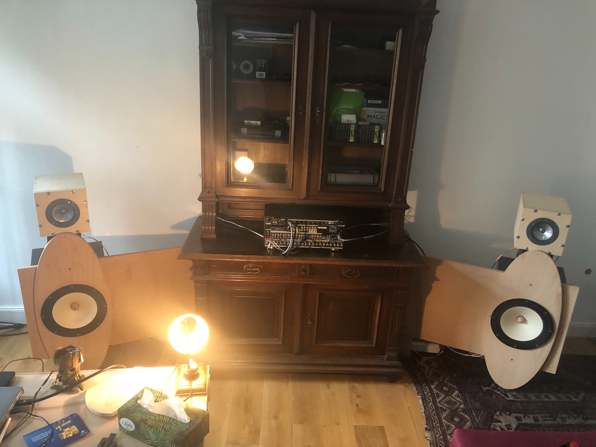

Hi there,
i have made some testing with measurements and listening tests for FR and coax
for budget there is a 8 inch FR chassis around that is unbeatable, lot of threads here for this one
https://www.soundimports.eu/en/sb-acoustics-sb20frpc30-8.html
i tested a lot with the Sonido SFR200A, other price point
for the coax i was lucky to buy some pairs of KEF in France where they were sold for a while as spare parts without the need to show the serial number of the old ones that you need to replace
actively driven with plate amps unbeatable sound quality / price ratio
with a miniDSP 2 X 4 HD with the Dirac Live plugin and an old receiver as 4 channel power amplifier and a woofer / midrange - highrange KEF coax with a simple passive crossover for coax midrange to highrane CO you can get a very nice system for an unbeatable price far better as with a fullrange chassis in the same regoin of budget
here a thumbnal of the test construction of mine
but as always this is only my personal opinion, Stefano
P.S. as of now in the second quarter 2025 for the KEF coax you need to find a decent pair of used KEF speakers and use the chassis, but to find for a decent price you need to be lucky

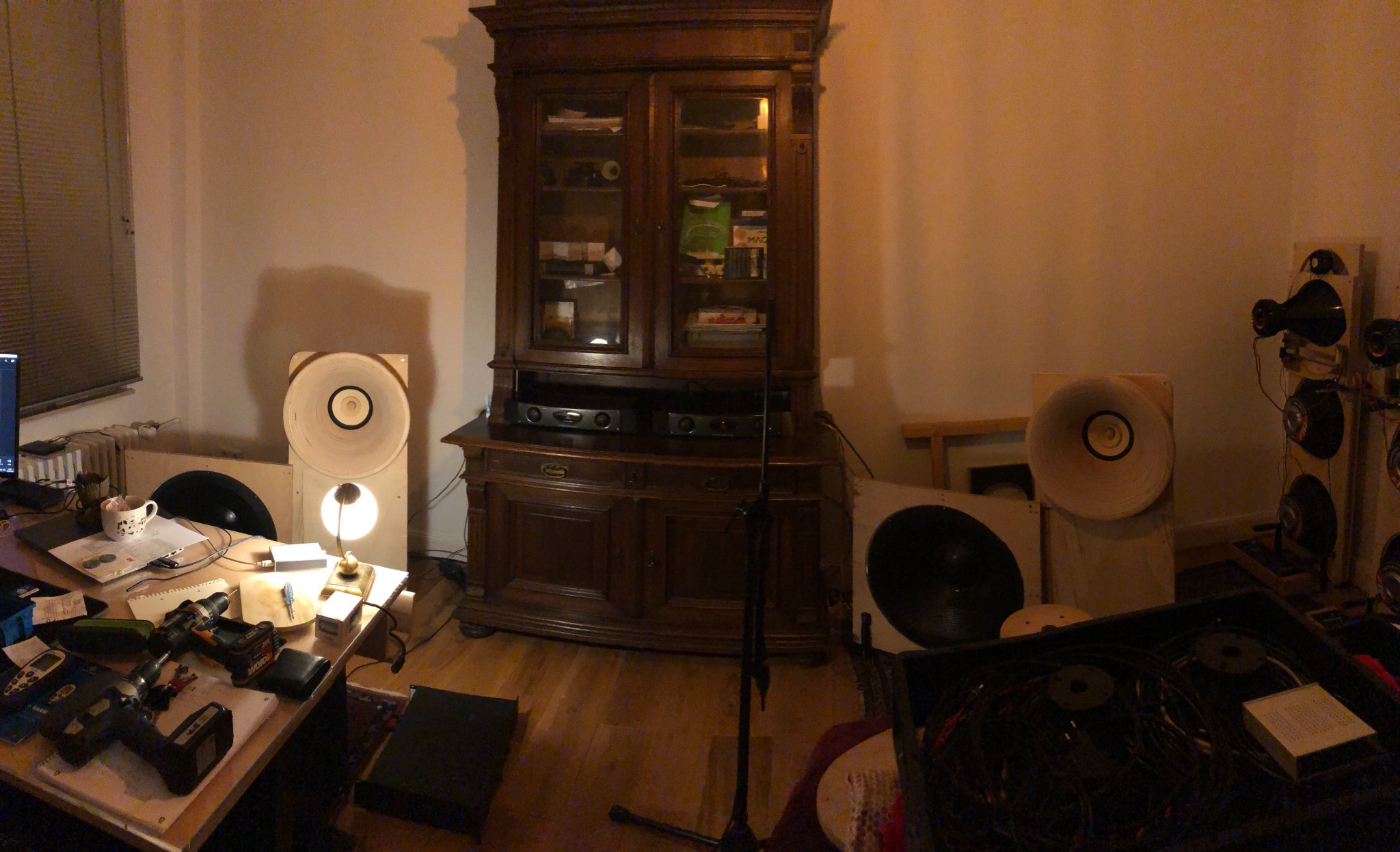

Could you share some feedback on that driver? I'm eyeballing it as well, mostly for its high sensitivity (& Sonido's good reputation and pricing)i tested a lot with the Sonido SFR200A, other price point
Hi there!
My best setup from the result of extensive listening tests with an older pair of Sonido SFR200A with the old basket (replaced some years ago with the standard 8 inch basket coming from 3rd party - presumeably chinese) was this here
with the front horn to reduce midrange distortion level and to tame the distinct double peak surrround resonance about 400 Hz ( Sonido use a completely undamped textil surround, with the heavy resonance but the Rms value is almost as high as the value of the legendary Siemens 6ruf lsp 22c 8 inch FR chassis) and a little bit of all over EQ at the listening position done with ROON via software the soundstage was amazing already at very low listening levels and the amount of coloration acceptable ( some people speaks from the characteristic Sonido sound )
hope it helps, Stefano
