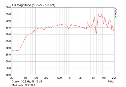

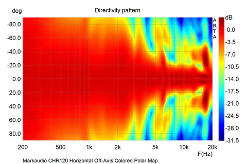

What about the extremely non-flat frequency response of fullranges? Like these (from the same Joseph Crowe link):
Note: Frequency response is heavily smoothed with 1/3 octave!
And what about fullrange cone resonances?
Frequency response can be made flatter with extensive use of DSP, but waterfall diagram can not possibly be corrected in any way.
Reactions: Arthur Jackson
You are right about the frequency response that must be corrected using a single driver with the help of a dsp . A WiiM pro or Ultra is perfect for this. Its ironic that many users of single driver speakers uses tube amplifiers and no eq at all making the sound very colored.
The directivity is not perfect either with a single driver , the speaker narrows at higher frequencies which actually can be beneficial in a very reflective room. So there are tradeoffs .
