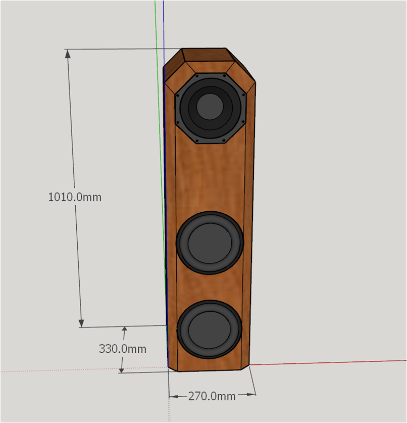

I like that driver also. Its got the smoothest HF I've seen on a coaxial. Vituix tells me it would work well with a pair of Dayton UM-8s but I need Faital to share their directivity measurements with me to be sure. No response to my request yet.
I sketched this up to see what it might look like augmented with a pair of UM8s:
attachment.php
If only I had Javad's wood working skills!

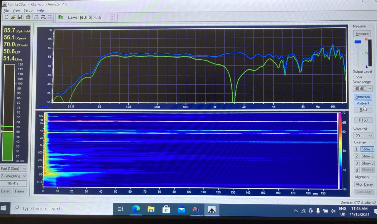

Available and indeed it seems to be workable. However, large Vas, high Qts, not really for the use I have in mind.
The sica only needs 0.7 liters to have an F-3dB of 225 Hz. That would be perfect for the enclosure I have in mind. But I would love to hear the Radian, which judging on its parameters, would seem to be more for theatre use as surround speakers.

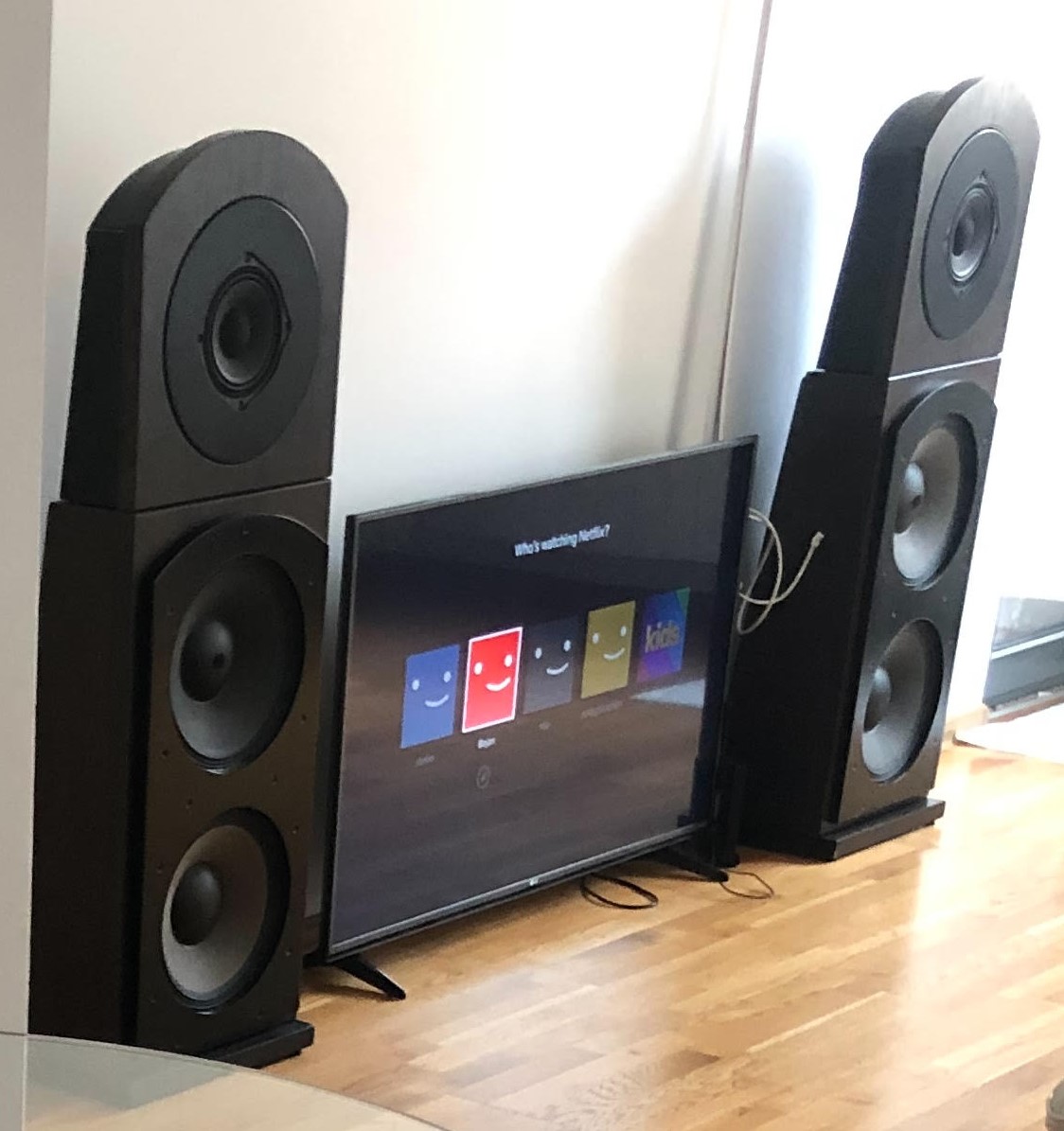

Yes, I have them in a temporary box of 12L, eq-ing the crap of them, they are taking it! But no real bottom end of course. I have plans to make a sphere for them complemented with some bass support, but someone is laughing at my plans...
I think they suffer from the protruding voice coil dip as any other similar coaxial drivers, but I would say it's not obvious when comparing with my Genelec's. The compression driver is more enjoyable than the metal dome in my 1030A
Some narrowing around 2.5kHz and they were difficult to get where I'm today, but enjoyable now. The sound is stable when moving around in room, pretty happy with them in general...
