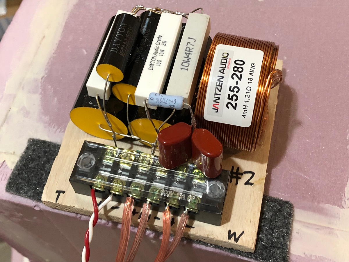

Got the crossovers finalized and tested today, I ended up tweaking the lpad once I had components soldered in place on the board.
I increased R1 to 2 ohms and R3 to 5.6 to get response back to where I wanted it.

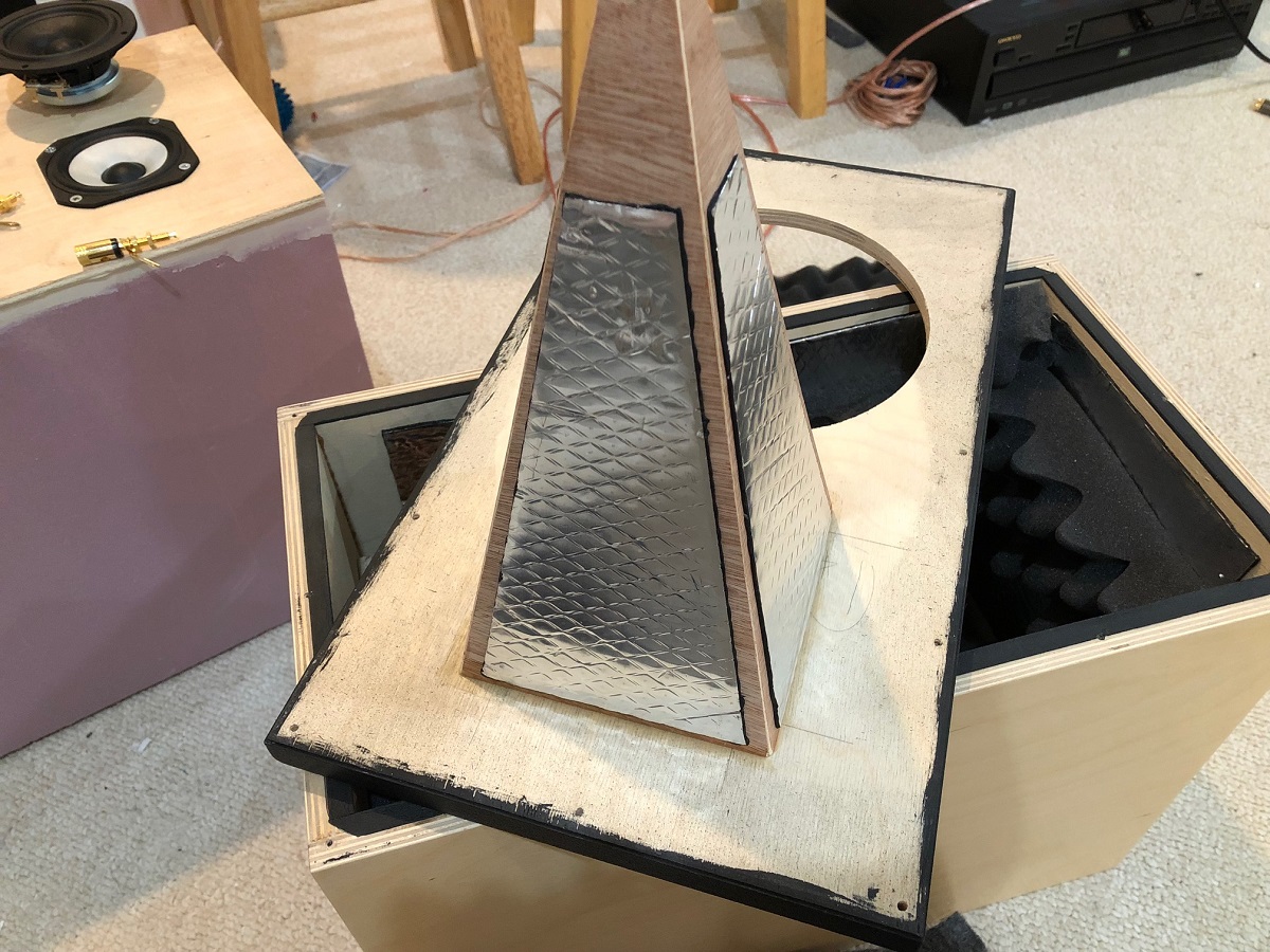

Sorry for the length between posts, been getting a lot done! Here’s where things start, enclosures stripped back down and ready to finish. I did a final pass with 220 to perfectly smooth things out and get a fresh layer of wood. Glad I did too as in the month or so since the last glue up a few seams crept settling a little (like maybe 1/100th” and I got a chance to smooth them back out.
I’ve never used it but been hearing good things about Rubio Monocoat. It’s an oil finish with a catalizer that reacts with the oil and creates a hard finish that bonds at a molecular level to the wood fibers. It initially came out for hardwood floors which gave me confidence to use it on speakers, and I was looking for a matte finish like with Danish oil but something a little more advanced and durable.
You simply mix the two and wipe it on sparingly (no need to flood the surface), then wipe it lightly 3-5 minutes later, then let it cure for 3 days, super easy and idiot proof. And man does that grain pop!
After curing for 4 days I began final assembly, more to come!

Before final assembly I played around with the crossover one last time (for now lols), my one sticking point after extensive listening was a lack of detail and top end response, I rolled off the top of the tweeter to deal with the hump at 2800 but this rolled off 5k more than I wanted to, so I experimented with some inductors across R2 and a .025mh brought up response above 5k nicely and brought that air and detail back that I felt was missing
I heat test all my crossovers and found the temp of the mid lpad resistors was getting to about 105F after extended play at peak volume, some heat sinks brought that right down to a max of 80F (in a 70F room) which I was very comfortable with. Heat sinks attached with heat sink glue
Crossover boards installed with stapled adhesive Velcro and a single screw to secure it

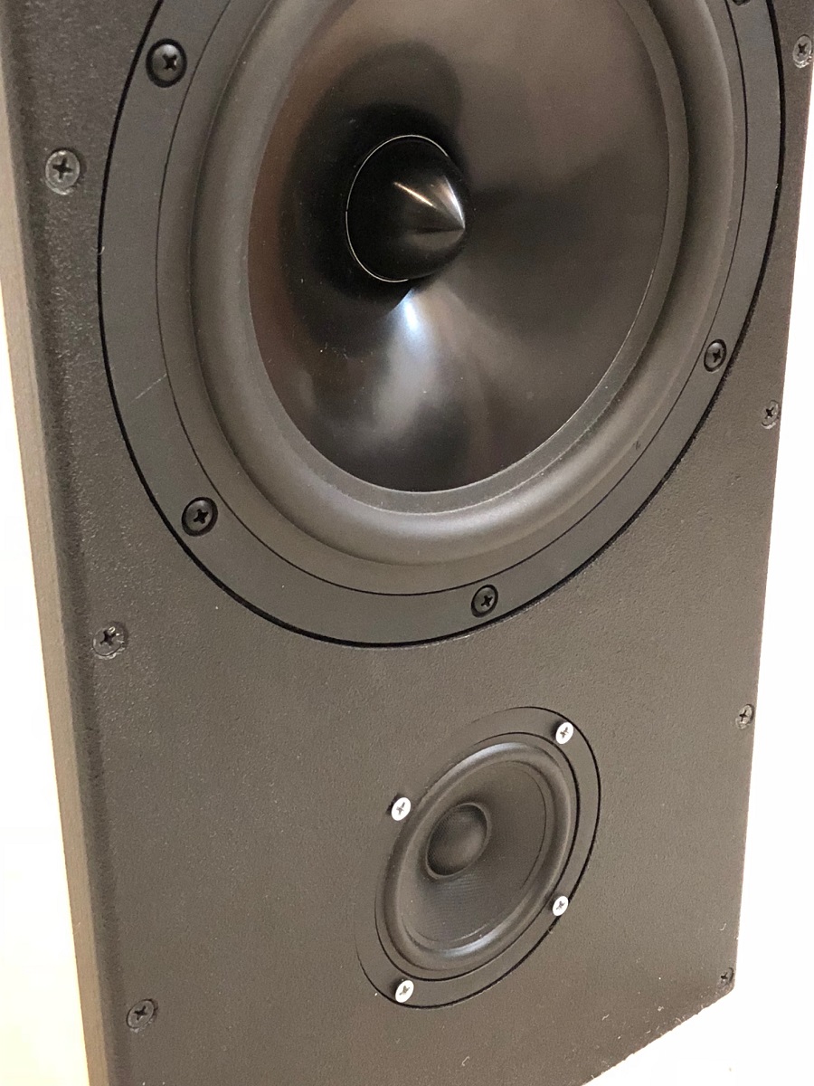

All buttoned up and lots of listening to do!
Will do a nice photo shoot and post pics next week
