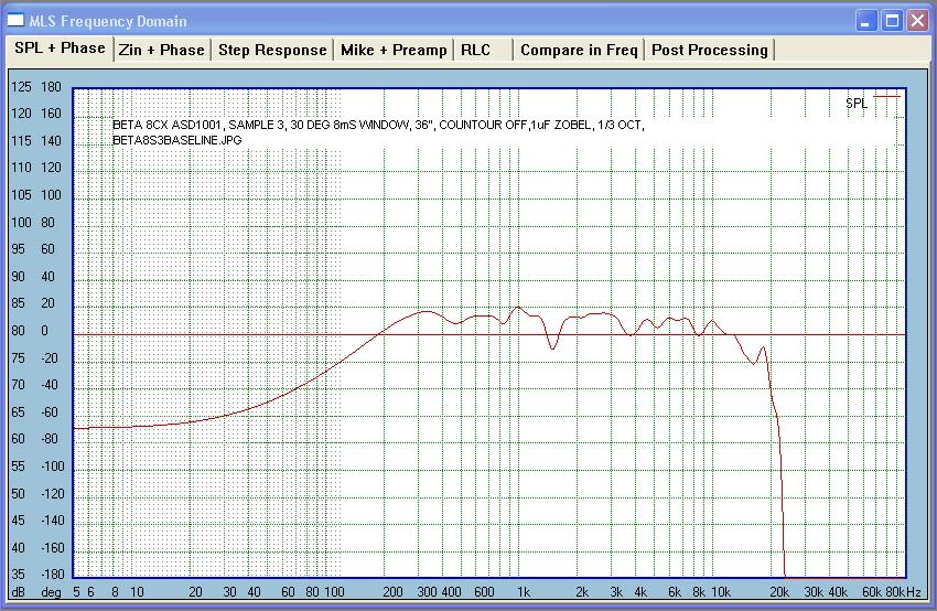

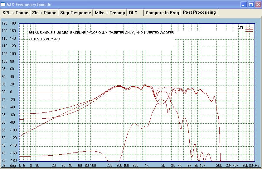

Eminence Beta 8 / ASD 1001
I have been very happy with Eminence Beta 8 & ASD1001. Get about 18 dB null with polarity on tweeter reversed, so in phase. Flat impedance curve. Respectable FR curve. Good sensitivity and dynamics.
