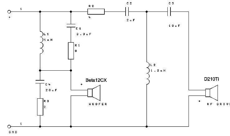

Here's some info I collected a while ago (through ol' Thorsten):

View attachment Seas H1144 Box and Xover.pdf
View attachment T18RE t speak.pdf
