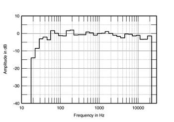

If the BSC of LS50 is ok, how can Atkinson's in-room measurement be so lean on bass and even midrange?
I don't know how speakers were located, but lean bass is fully expected if small bass reflex speaker with rear port is located on stand at 70...120 cm from front wall. In addition, BSC of LS50 is quite irrelevant due to high humps at low treble. Evaluation of BSC is much easier and makes some sense e.g. with my Q100 which has smoother frequency response up to mid treble, and magnitude of front port signal does not depend so much on measurement distance.

He doesn't tell the exact location of the speaker though. In photographs we can see them in typical "hifi-location" almost 1m away from front wall, on a pole/stand. Avarage of 120 measurements with different standardized mic locations. Sometimes he publishes measurements at someone else's room.
This is the in-room response that Atkinson calls "typical"

^120 measurement points won't help if speaker position is not compatible with mechanical construction and sound balancing. Results of different speakers could be comparable but still worthless for people who can hear and are able to make proper listening setup. I suppose decent and valuable speaker measurements must be done someone else than stereophile also in the future.
