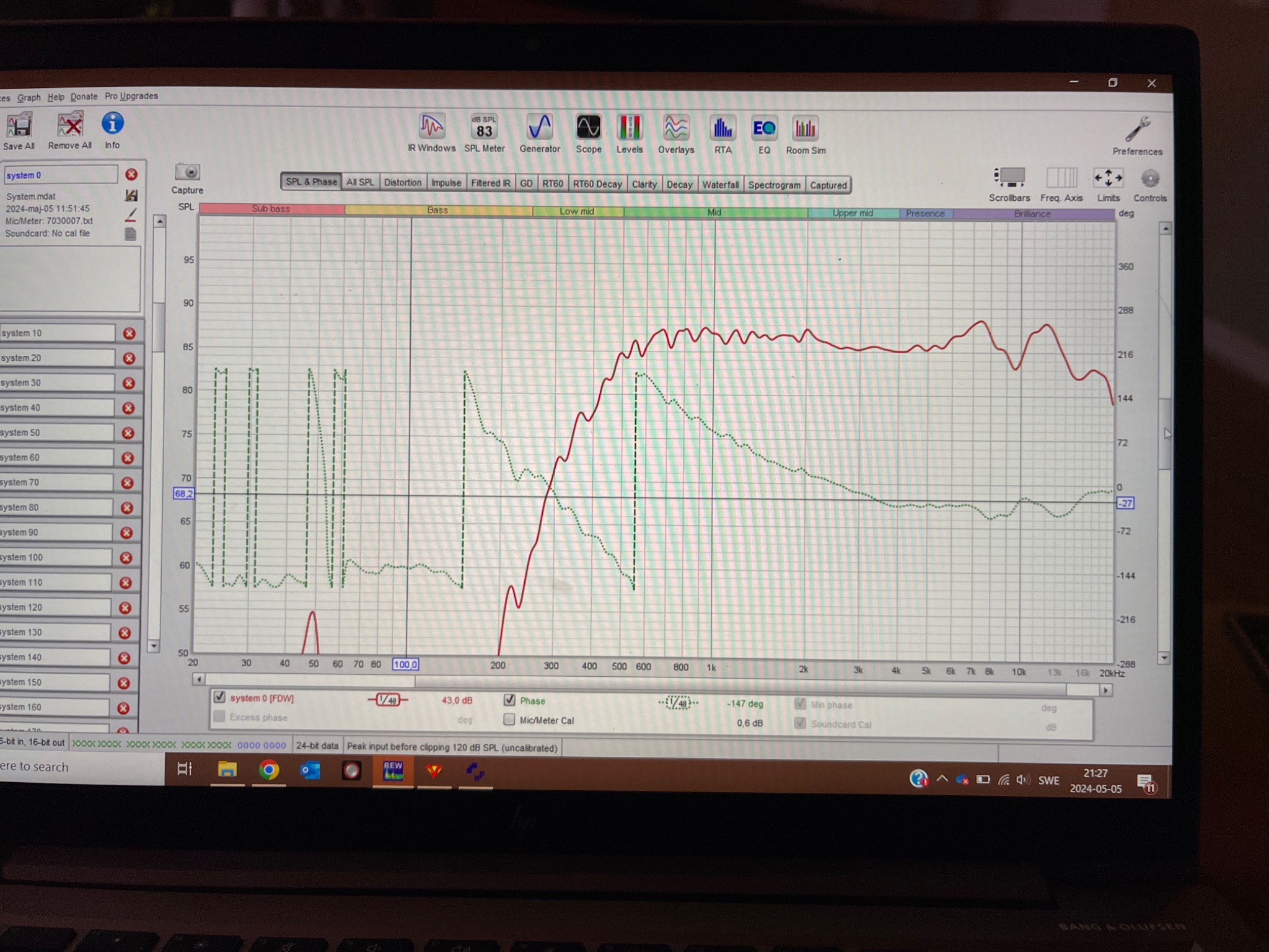

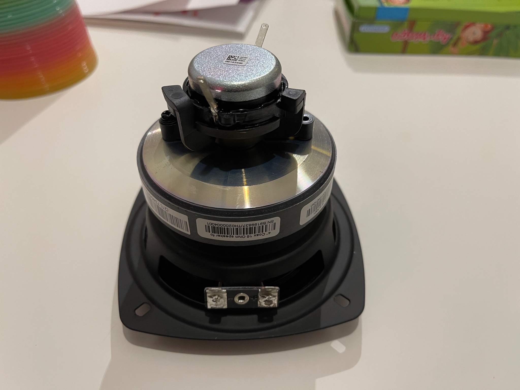

Also, the compression ratio is 8:1, which provides an airspeed of roughly 5,5 m/s at the phase plug with 91 dB, 400 Hz.
What do you think the compression ratio is on this annular diaphragm:
Any estimate of it's airspeed when the SPL is over 160dB ?
This speed through a non optimized, crudely printed phase plug could be the source. Still, It doesn't directly explain the peaks at 4 and 500 Hz.
The noise floor has those peaks, as do all the harmonics.

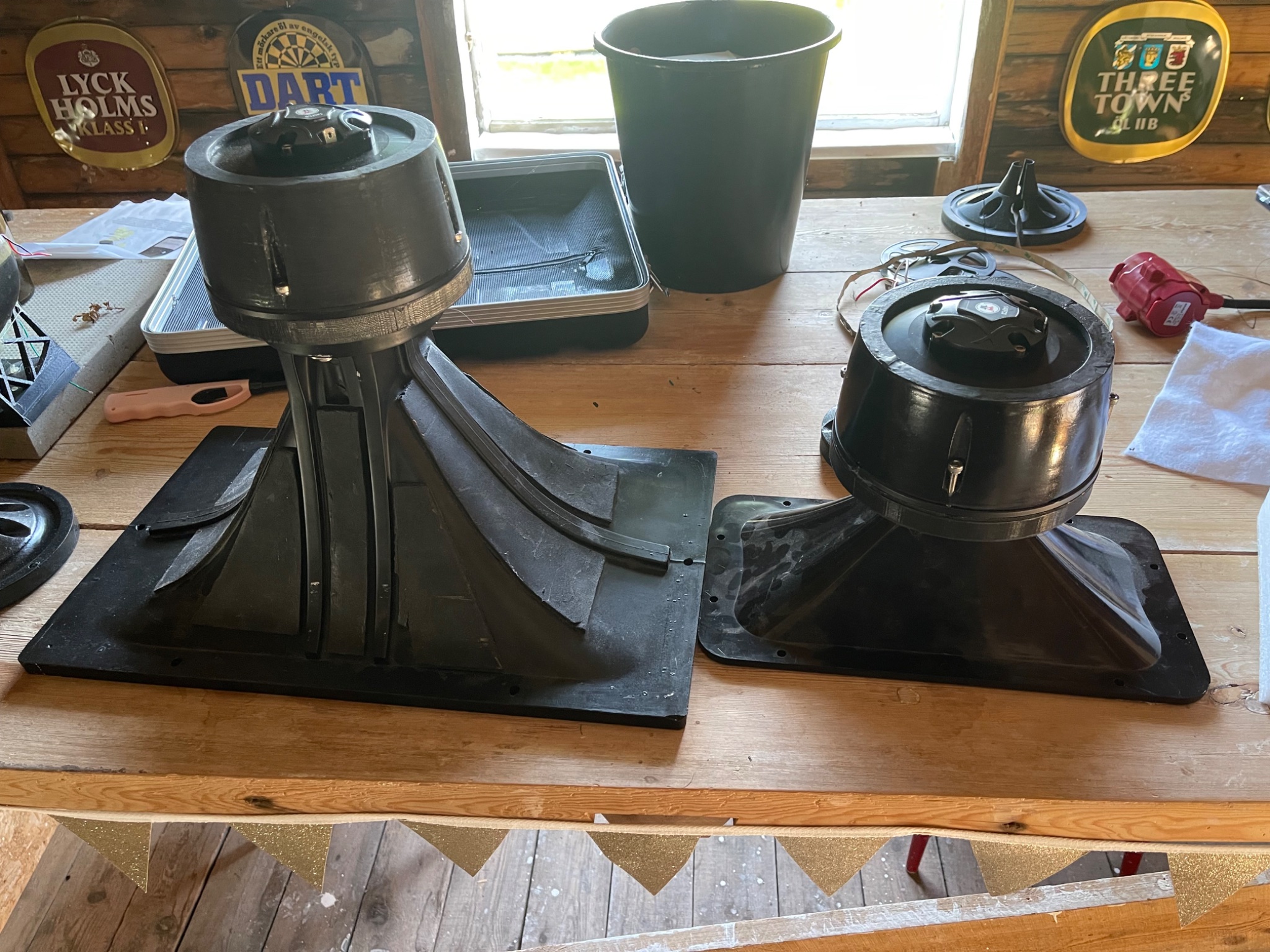

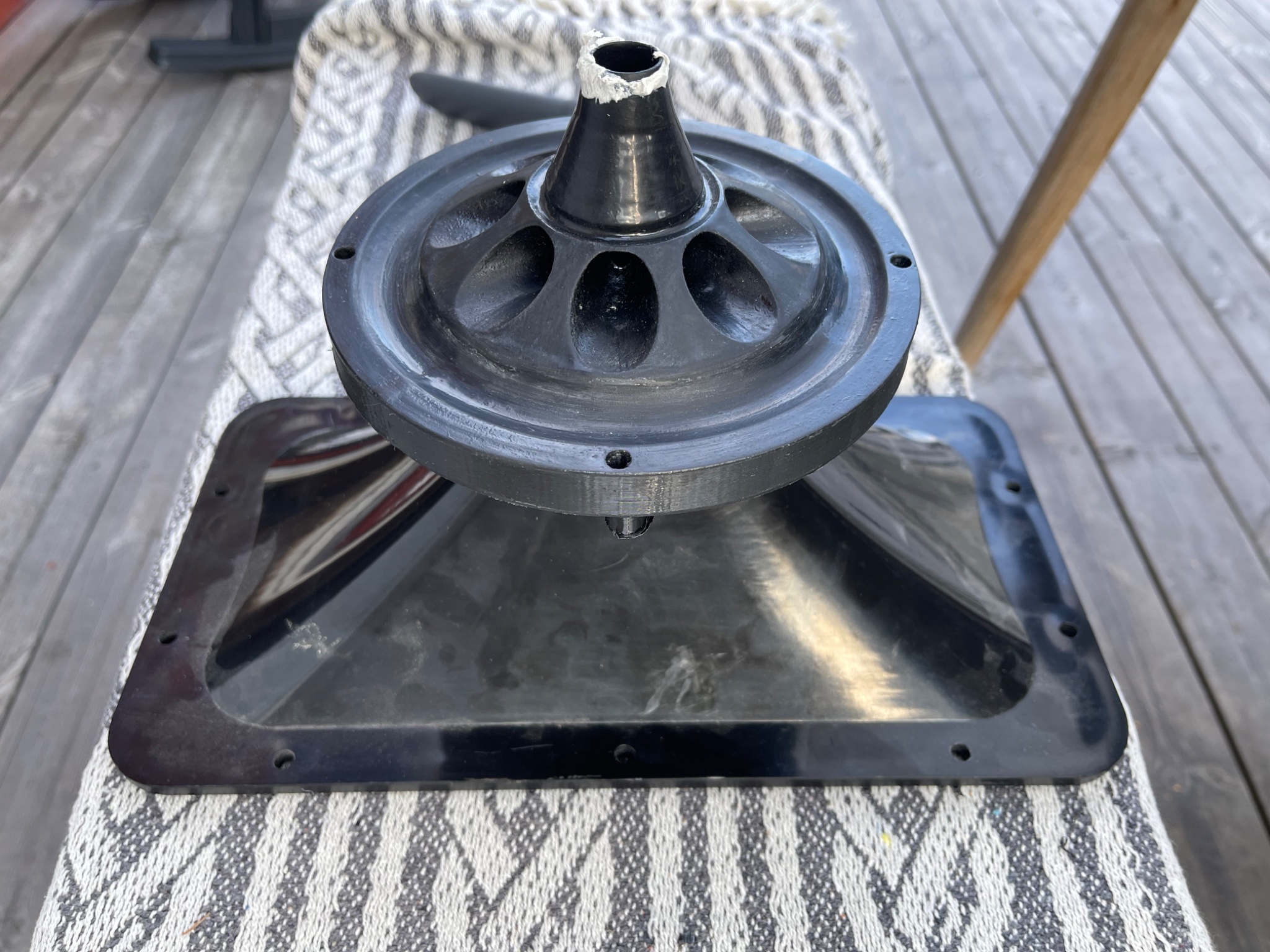

Late to the discussion but, my take on a low cost coaxial compression driver is far easier.
https://renkus-heinz.com/core-technologies/

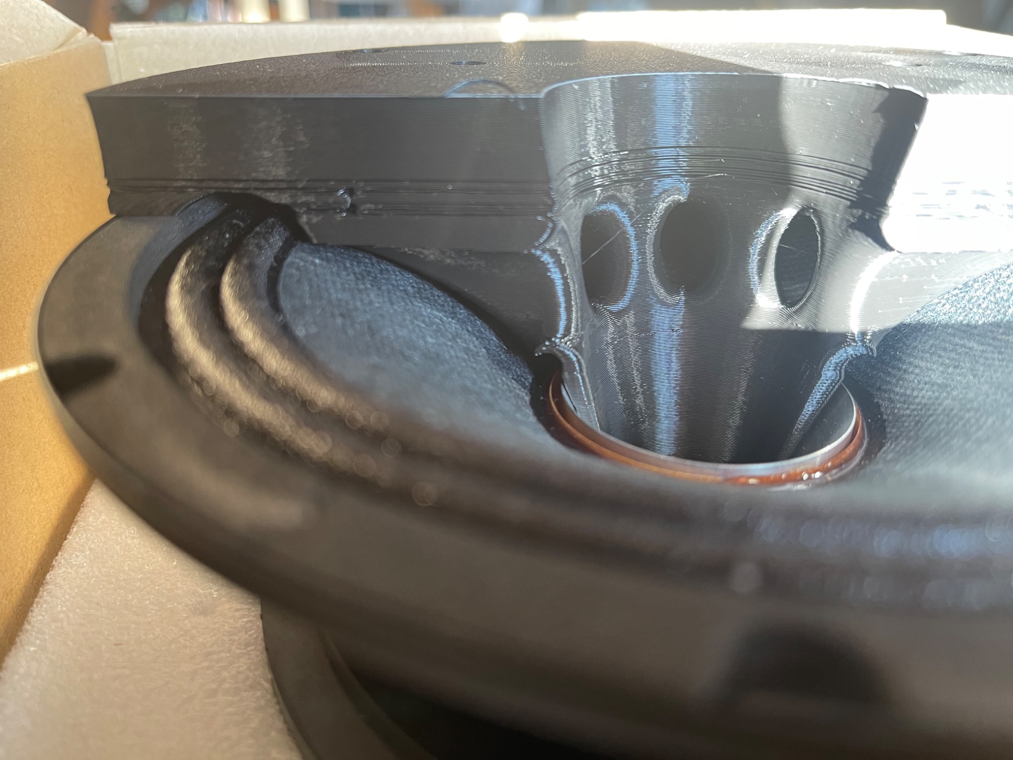

So far I have made a 1" CoEntrant adapter and a 2". Simple conical expansion from the phase plug of the compression driver to the desired exit diameter.
What i haven`t tried yet is to design for a melamine plug in the ports for the midrange. That would qualify as a impedance miss-match device.

Awesome work!
In the patent they call it the "passive low pass filter". It blocks the HF from entering the MF ports according to the patent. Im curious what the effect of your MF ports are on the HF as yours are large enough for HF to pass. Aka, do we realy need to make a "passive low pass filter"? Unity horns work without it.
For me to investigate the holes influence I simply need to make a cone and insert it. But from memory i don't think i did this.
To be honest, I`m terrible at keeping record of these tests I do.
Short attention span, and then I move on to next test shiny thing in my mind.

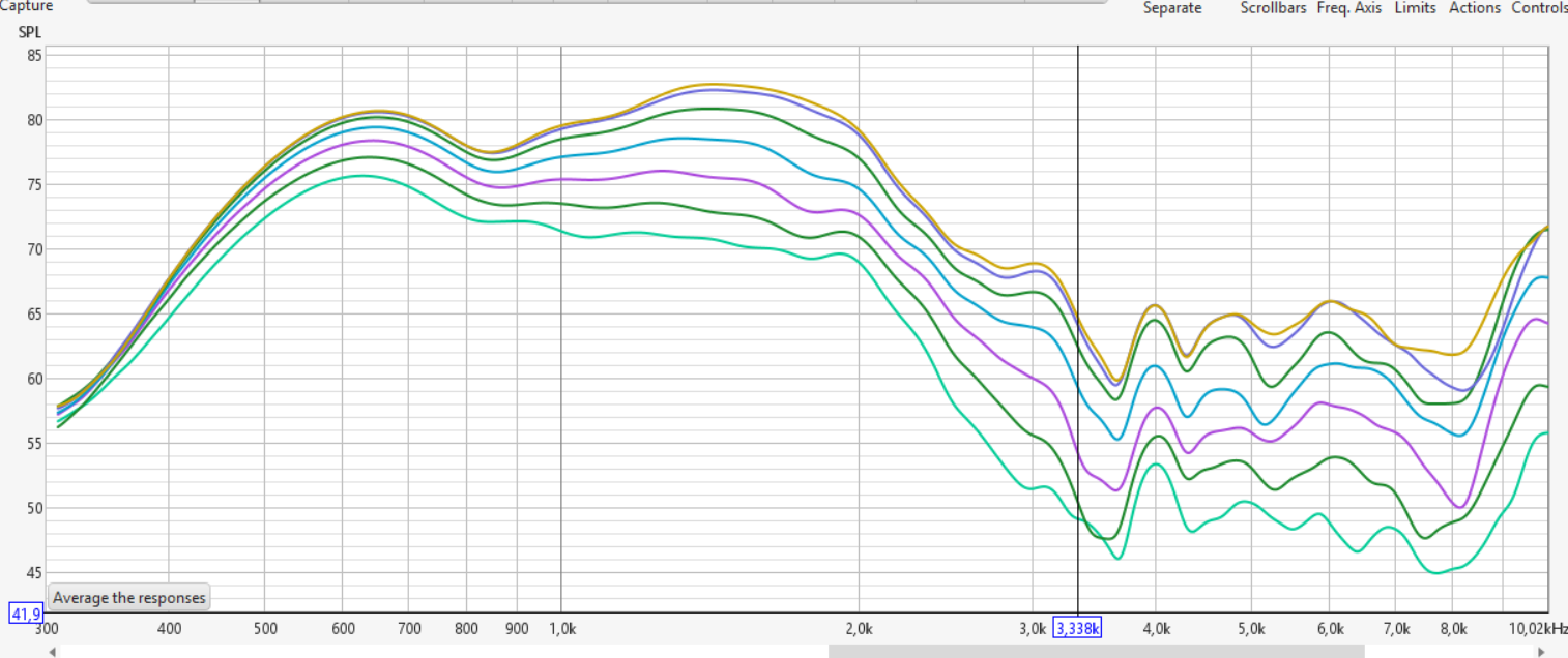

But 600-20000Hz low distortion from a 6" coaxial that at the time costed ~100usd.
I did test the 2" on a JBL 2380a clone and could replicate the data sheet. But I felt something was off, getting ear fatigue and blamed the horn.
So i moved on to a 1" version to use other horns.

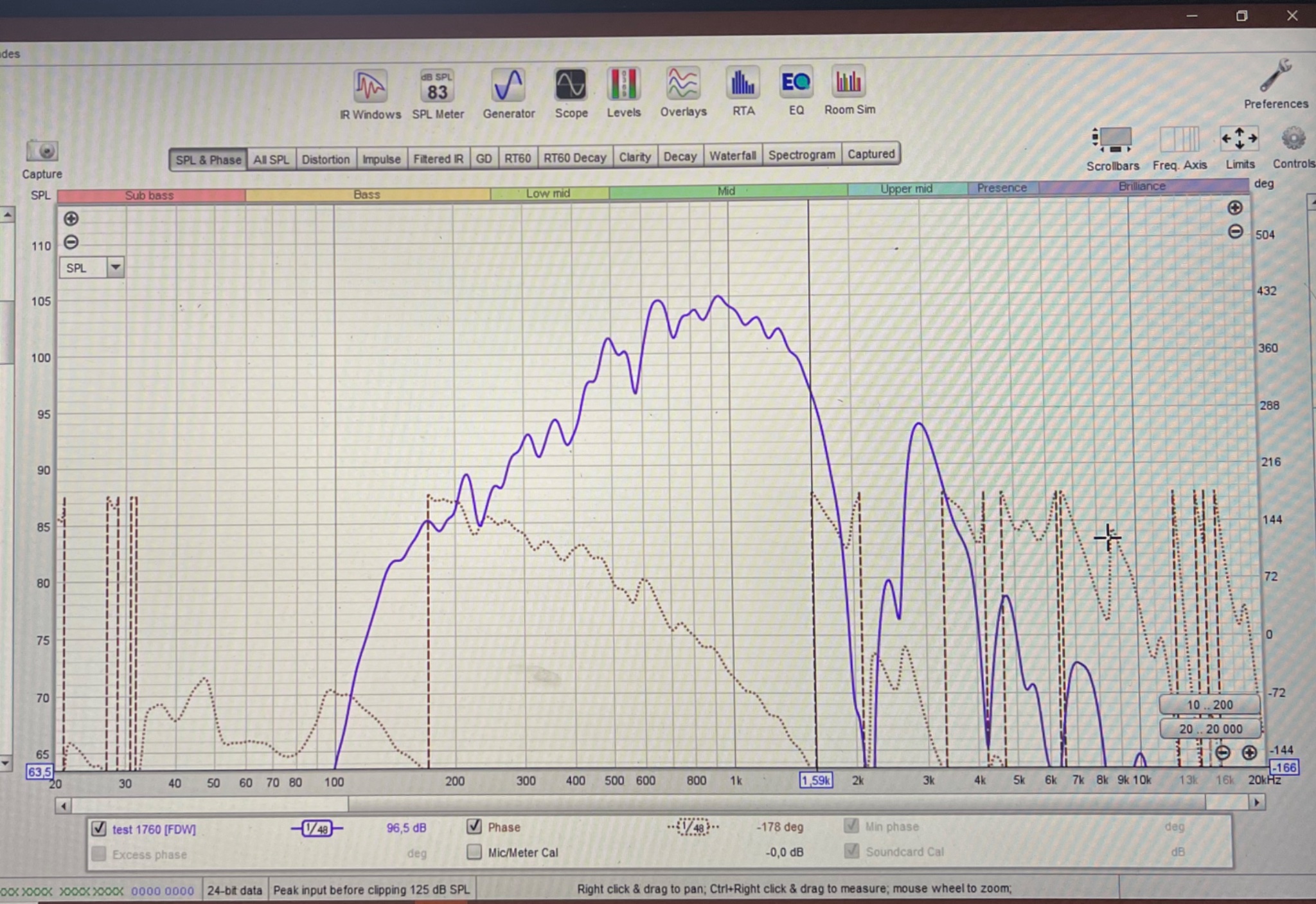

"Unity" was the name for Tom Danley's multiple entrant horns (MEH) while with Sound Physics Labs(SPL). Unity™ was also licensed to Yorkville Sound.
"CoEntrant" was Renkus Heinz name for their MEH, which preceded the Unity series.

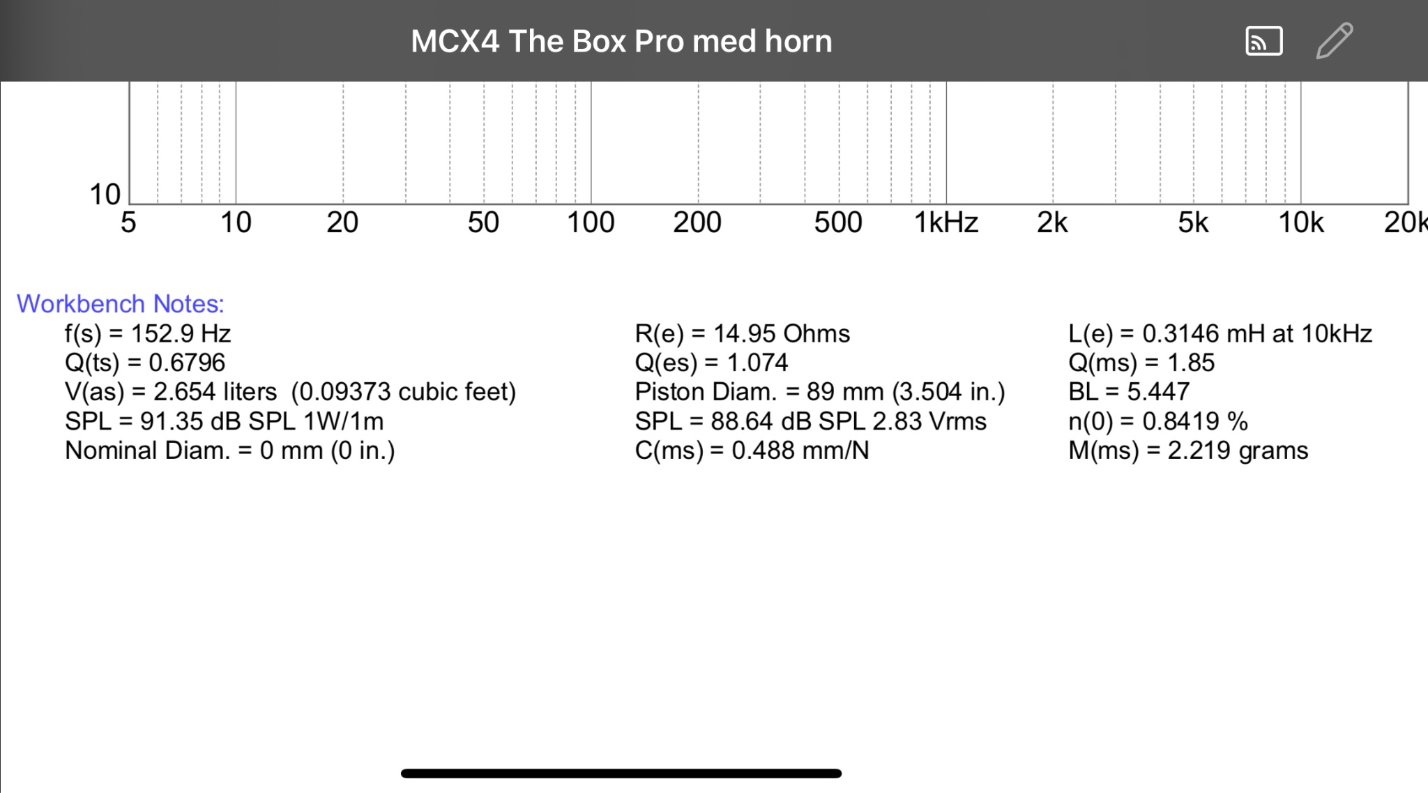

Like the Danley Sound Labs (DSL) "Synergy" MEH, or any driver with an enclosed space between it and the exit ports, the mid output exhibits a steep acoustic low pass filter, followed by a series of peaks and dips independent of those determined by the horn entry point.
Nissep's first attachment in #51 is fairly typical of that type of response, requiring the crossover frequency to be below ~1500Hz.
The more excursion the driver is allowed, the larger the enclosed air volume is, and the lower the frequency of the acoustic low pass filter.
Coax compression drivers like those produced by BMS or B&C require a high crossover point between the mid and high, so the enclosed air space between the mid diaphragm and phase plug has to be minimized to raise the acoustic low pass filter frequency, which then limits excursion and low frequency output potential.
The compromise between displacement and the acoustic low pass filter frequency determines usable bandwidth.
The tricky part is designing exits for the lower driver that don't screw up the response of the upper driver too badly.

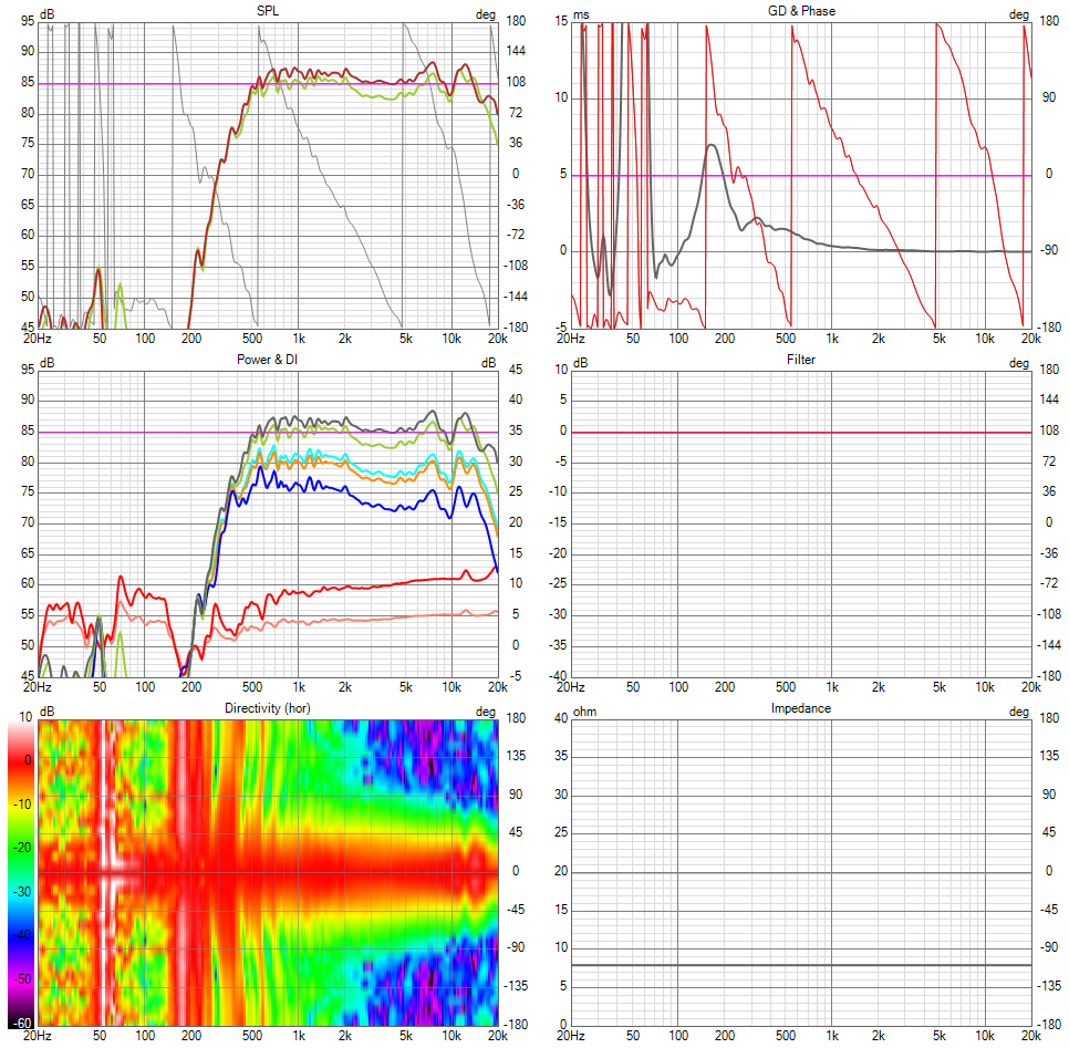

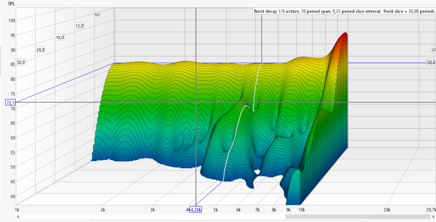

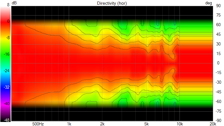

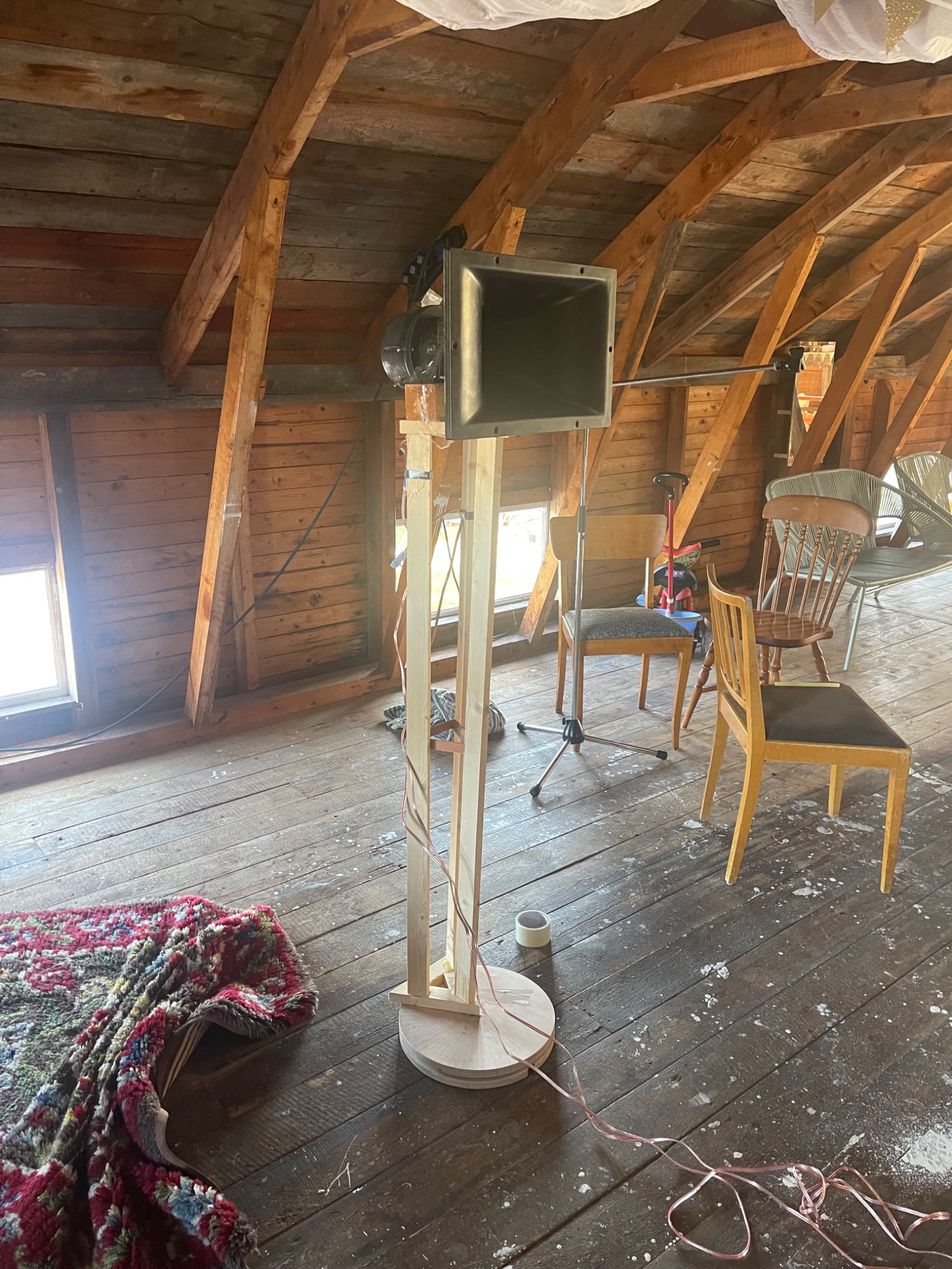

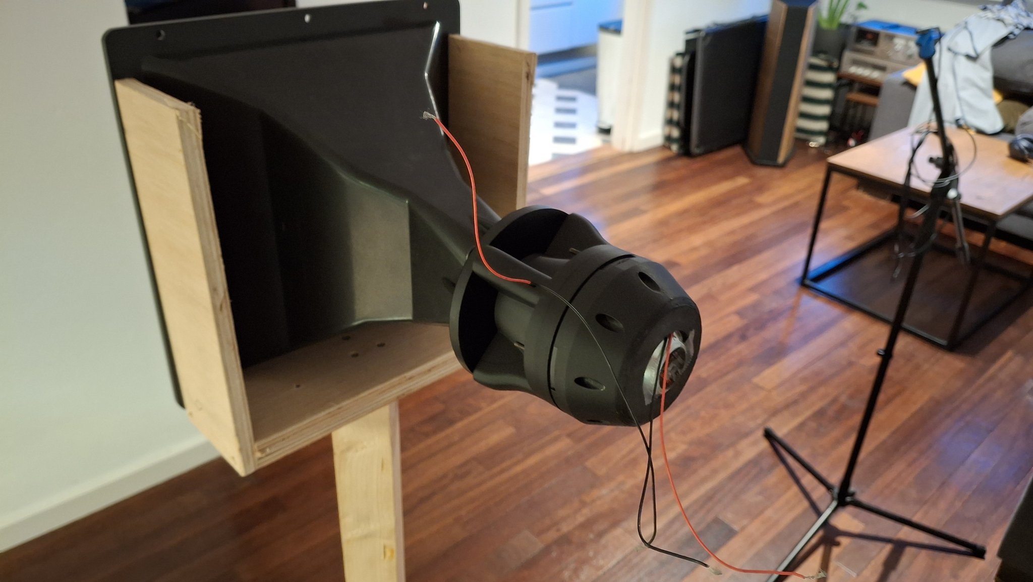

Update

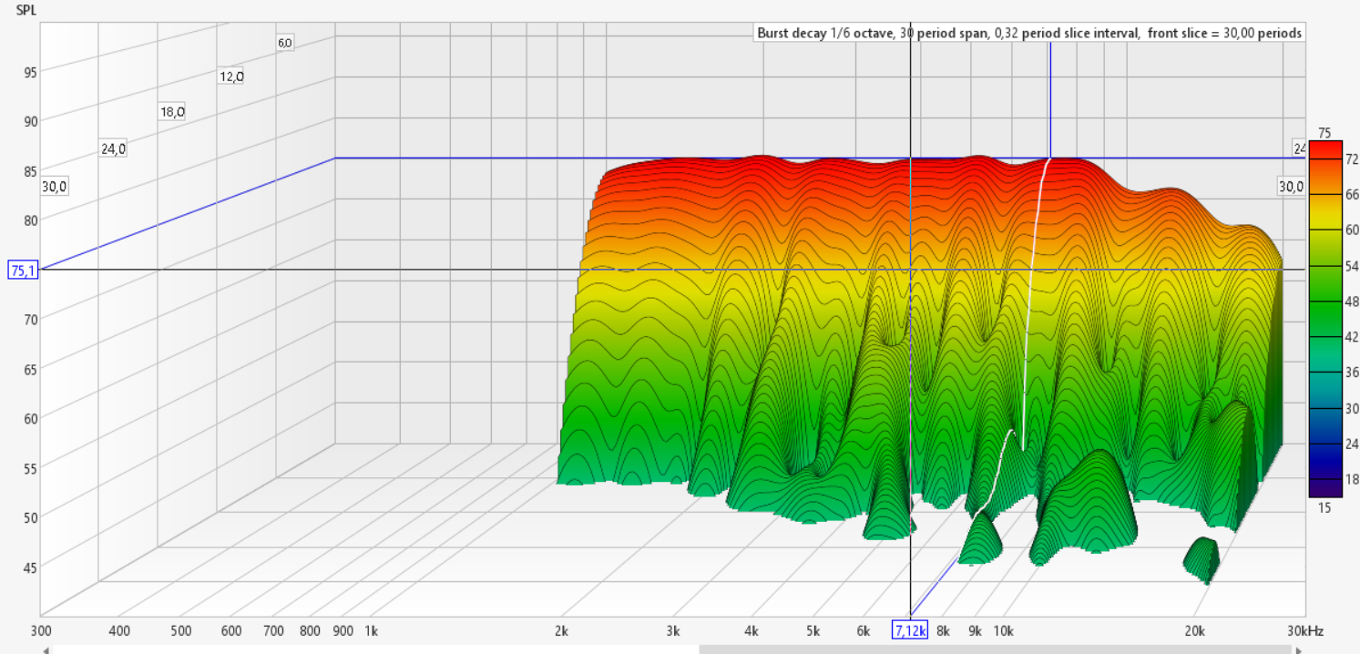

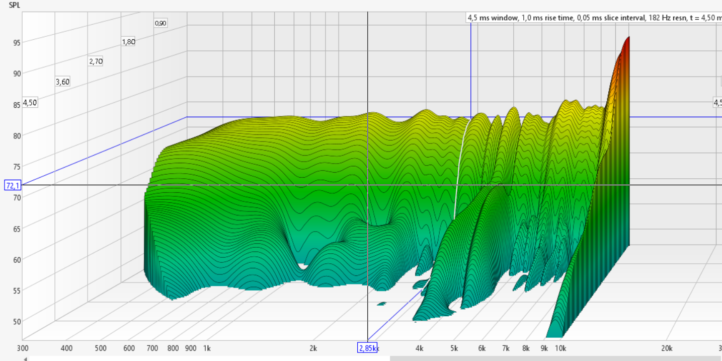

I decided to keep my head down for a while till i had some results that matter. Have printed and tested 5 prototypes in the mean time. The last one, while playing music right before measuring, sounded verry different in a good way.
It also shows in the measurements.
For context:

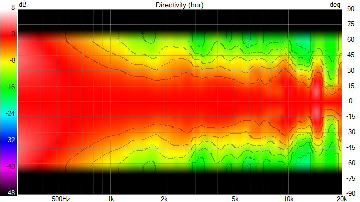

Measurements on SB audience H280
1 meter mic distance
4,5 ms window
Burst decay and fourier waterfall are "normalized" with the EQ function of REW
Burst decay floor is -35 dB
fourier waterfall floor is -25 dB
Fr graphs are smoothed 1/12
Fourier waterfall and decay HF
Fourier waterfall and decay MF
FR HF
FR MF
Polar HF
Polar MF
To be continued!
Note for the previous post: Measurements where at -32.5 dBfs. This means that at 2.83 V rms the MF driver would do 110 dB/1m...

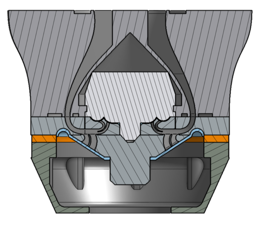

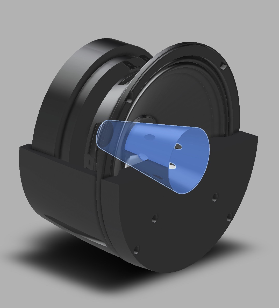

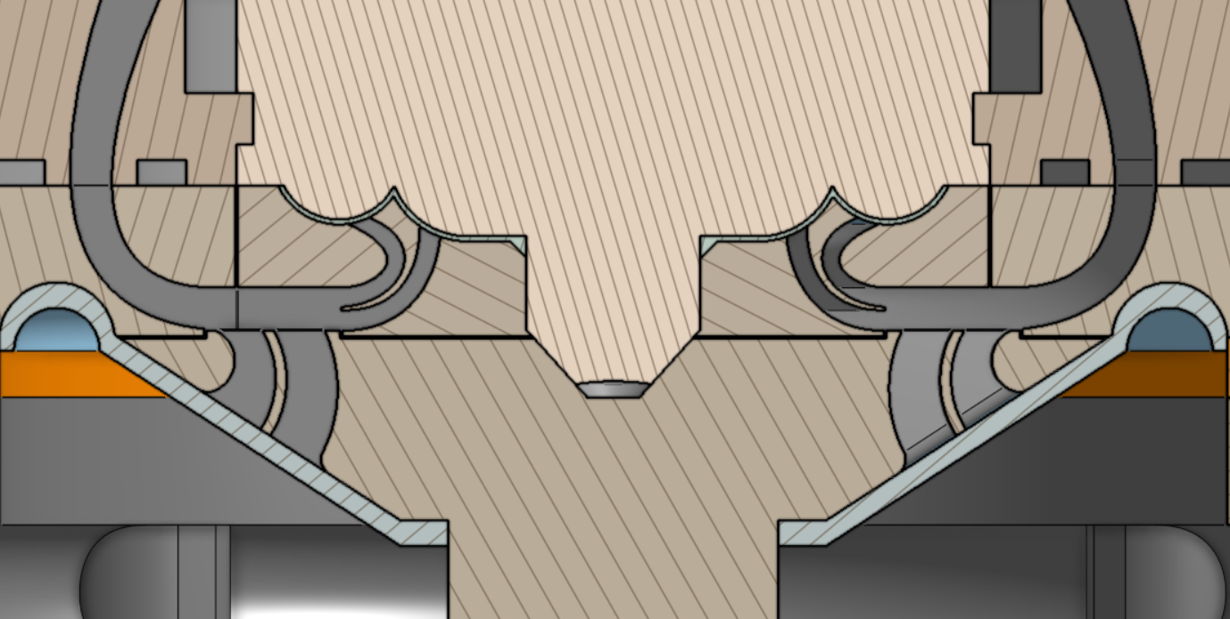

Here is a section view of the CCDIY.

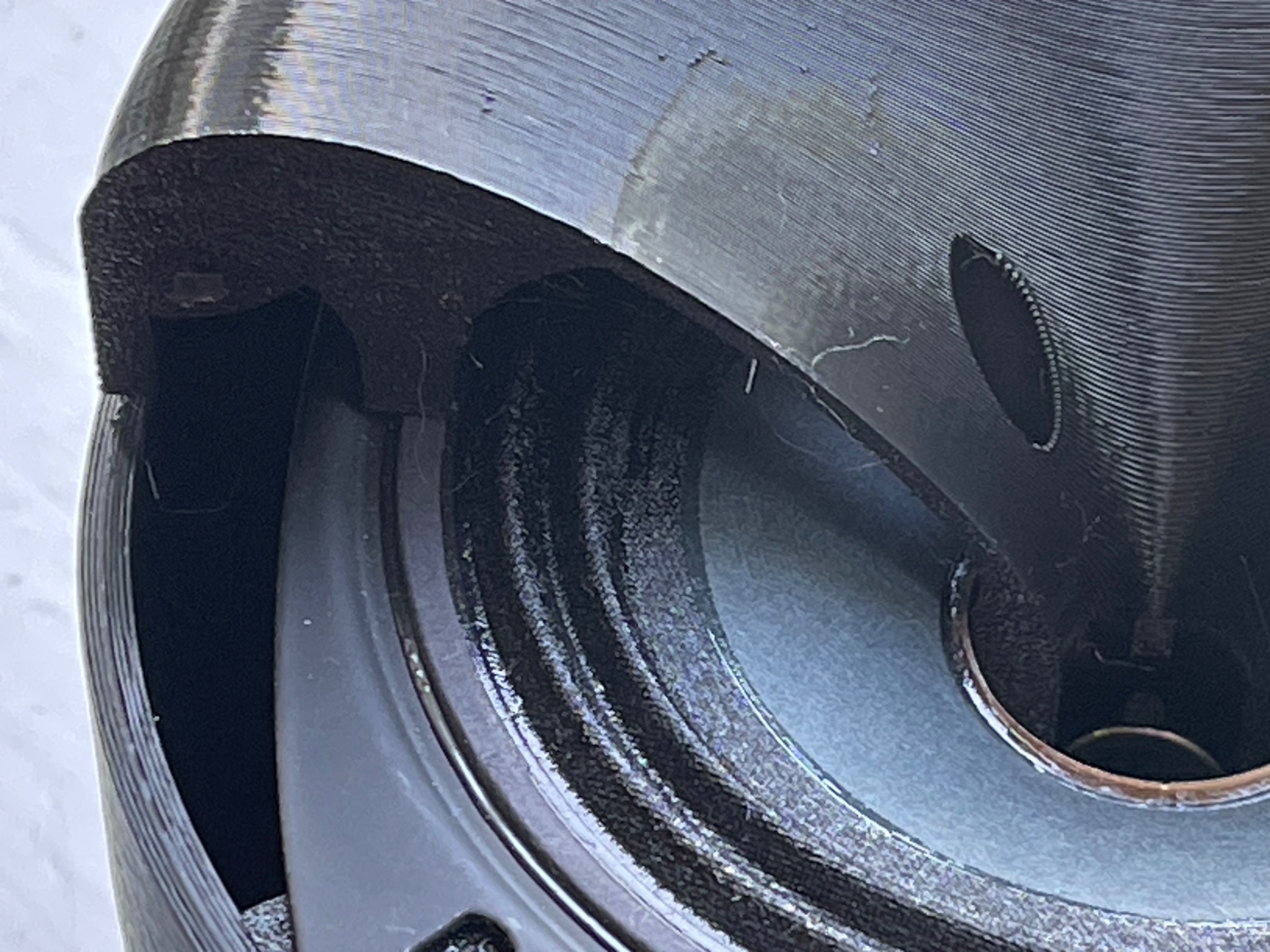

The design has changed a lot compared to earlier pictures. The main change that made the biggest improvement whas cutting the dustcap off of the mid range (blue part resembles the space between diaphragm and phase plug). This made it possible to have even path lengths for the MF sound while having MF ports only 9 mm long. This in turn made it possible to make main port to the 1.4 inch exit shorter and smoother. The next improvement came from the late meeting point of the two HF slots. This, i think, reduces the interaction between the HF sound and the MF ports.
Fun fact: the phase plug, part between the HF and MF drivers, consists of 4 individual parts. This to ensure cleanly printed parts as it has a lot of overhangs.
In the first picture, it looks like the exit at the top is straight. This is caused by the section view. In reality its expanding to the full 1.4 inch exit.
Also visible in the top picture, are the reliefs in the top part for foam gaskets between it and the phase plug and sealing between the driver and the horn flange.
For my first project with a 3d printer, it has been a real eye opener. The speed at which prototypes can be iterated is insane. Also, when done right, tolerances are also easy to hit. For example: the space between the HF diaphragm and its phase plug is only 0.3mm and the clearance between the MF voice coil and the plug inside it is only 0.2 mm. I havent had to ad extra clearance by cutting or sanding.
As for now, the phase plug performance looks good. Still, a lot has to be done for the CCDIY to be completed:
Compression ratio needs to be evaluated. Have kept it at 8.3:1 for MF and 4:1 for HF. Want to know how it effects IMD and THD.
Thermal management is nowhere to be found.
MF rear chamber dampening is not yet exploited.
Listening tests should be conducted to evaluate the subjective performance. As my ears and brain are not as trained as most folks (and biased af), i will probably opt for alpha testing with forum members.
Would love to hear your take on this project/subjects
