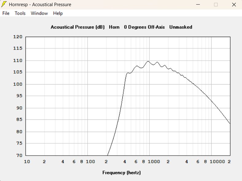

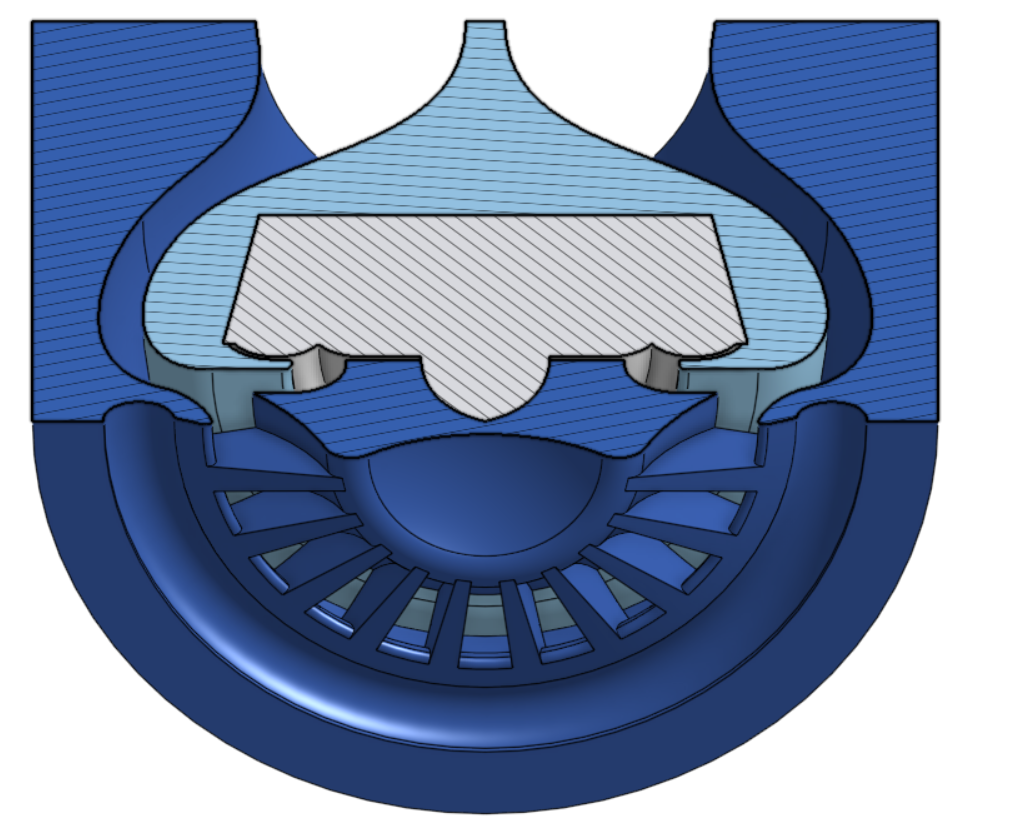

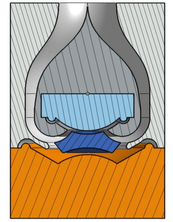

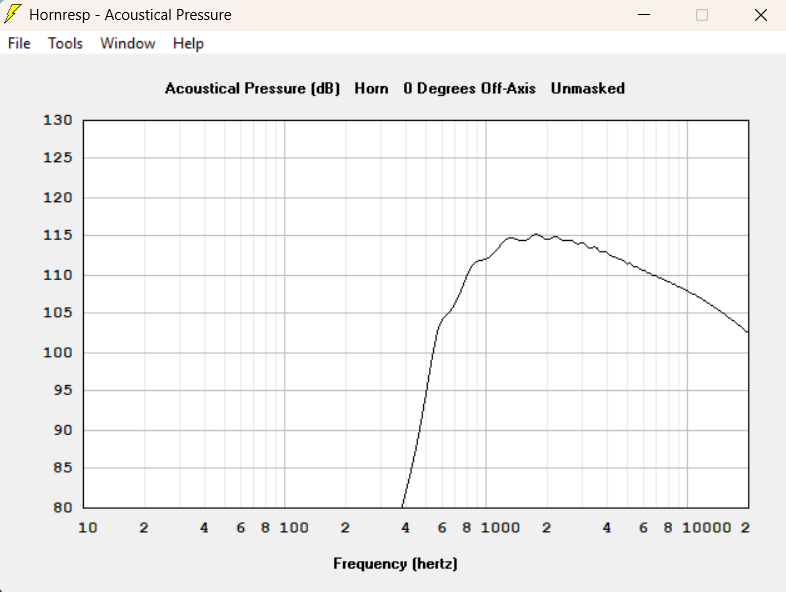

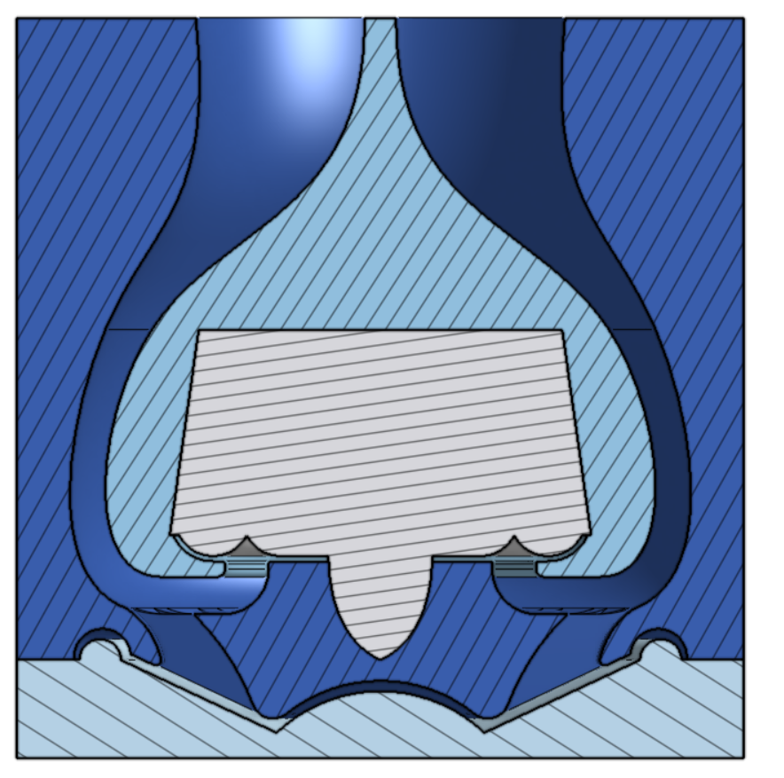

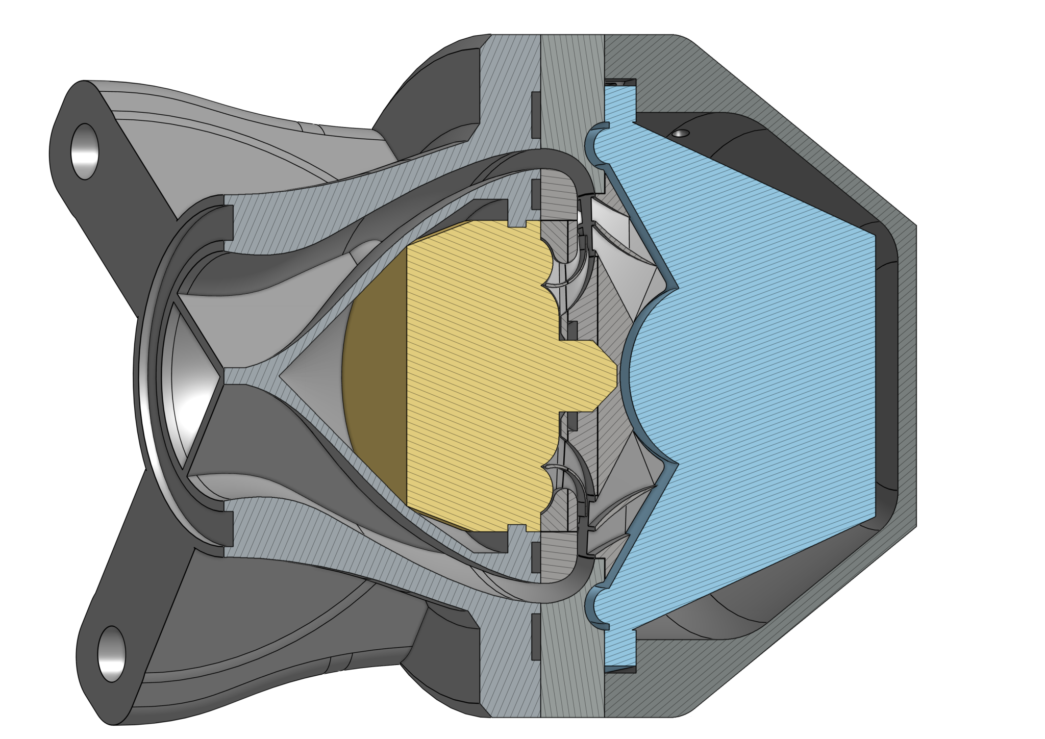

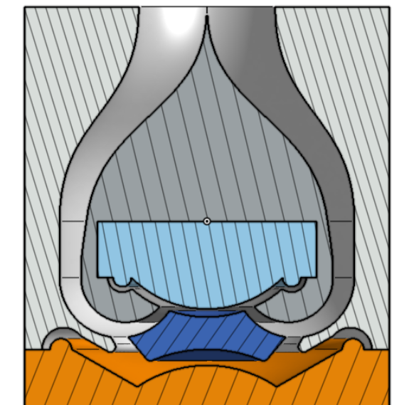

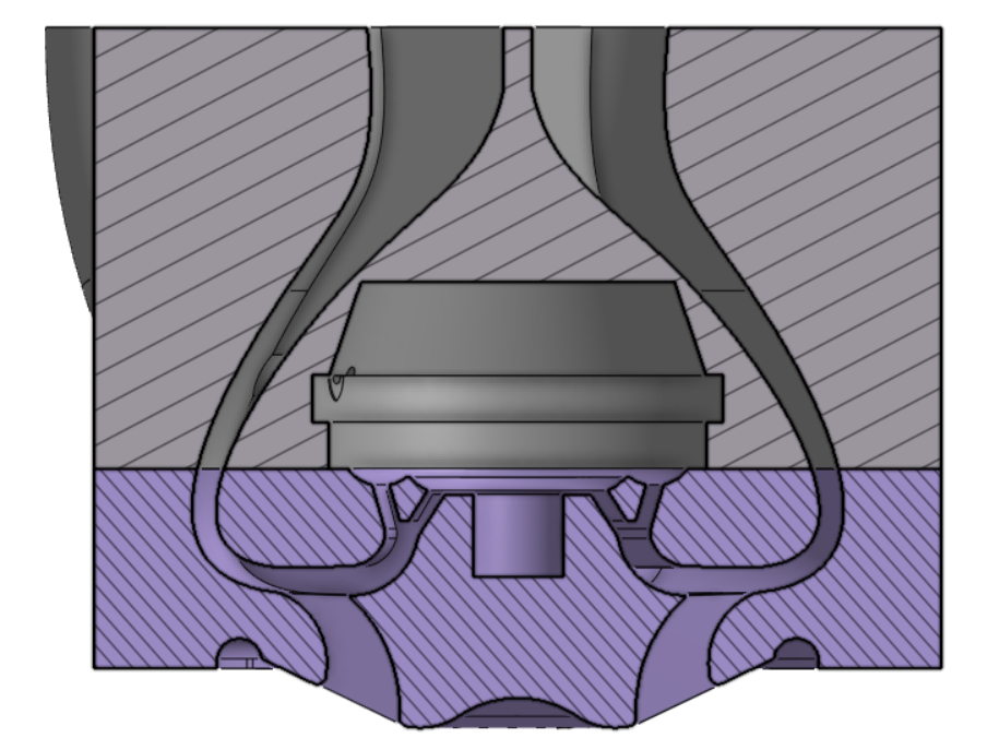

What do you think the compression ratio is on this annular diaphragm:Also, the compression ratio is 8:1, which provides an airspeed of roughly 5,5 m/s at the phase plug with 91 dB, 400 Hz.
Any estimate of it's airspeed when the SPL is over 160dB ?

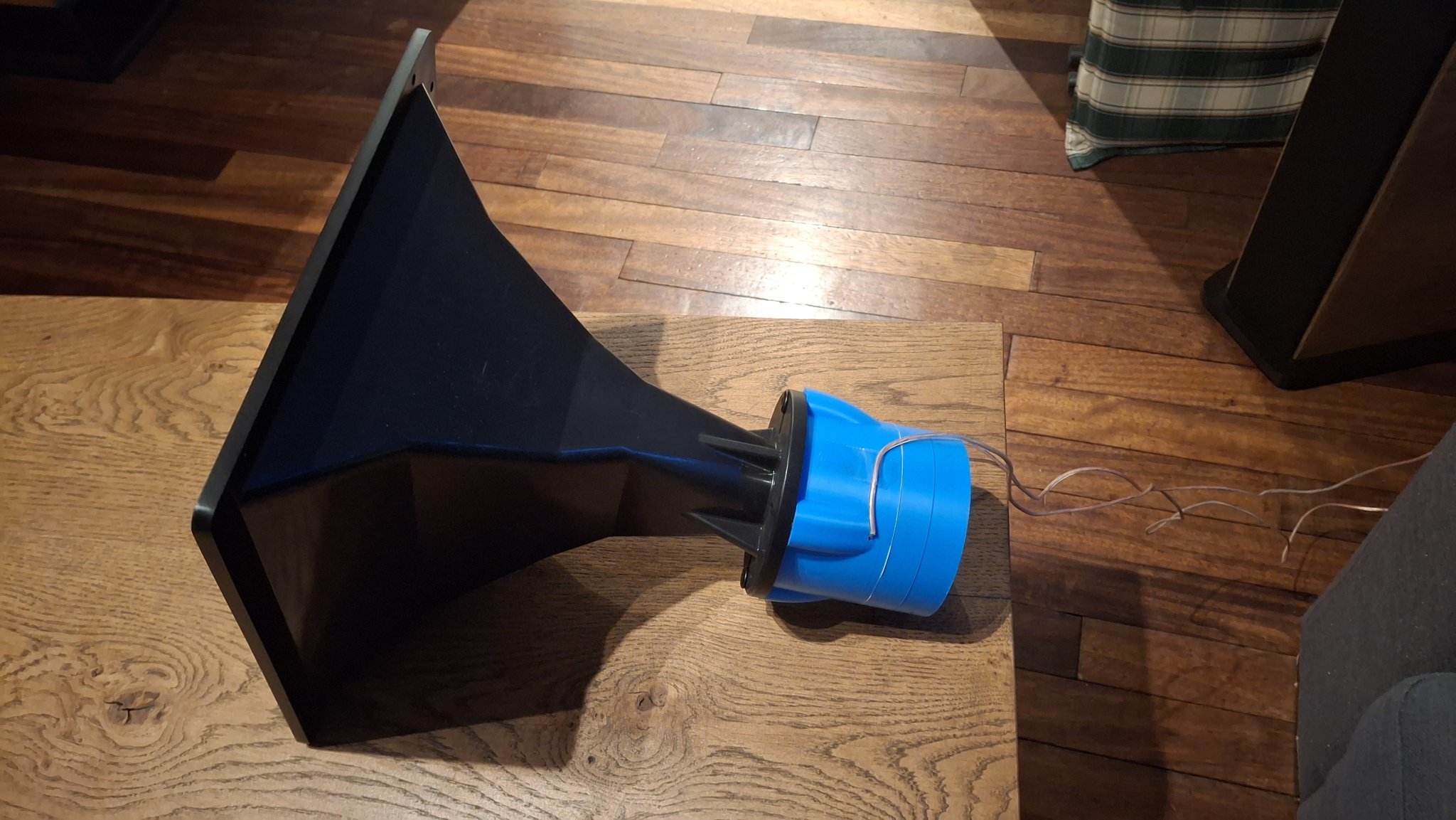

The noise floor has those peaks, as do all the harmonics.This speed through a non optimized, crudely printed phase plug could be the source. Still, It doesn't directly explain the peaks at 4 and 500 Hz.
Unless you plan to copy the all the patent details (annular diaphragm ect.) and sell the drivers, not much to be careful about.PS: as this design is related to the dcx464, which is patented. I'm careful with sharing details (drawings etc) which could cause indirect infringement of the patent.
