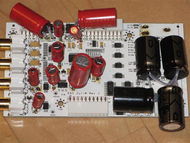

To kick things off, here's some modifying I did to my Juli@ sound card this weekend
What you did is you violated Juli@ with those big red and black cylinders ! 😀
Just joking !
"Violated" with the best caps in existence?... Interesting... This would be roughly equivalent to an average man in his forties being "violated" by Angelina Jolie, lol 😀
Wow U Leon. Those caps are really wild. If you can mix up a batch of 8k uf, I'm ready to put them into my DAC.
My caps are rather radical, yes 😉

The latest test upgrade I did to my main test Juli@ was to add 100uf ceramic bypass capacitors across many of the 'BCxxx' bypass capacitors already on the Juli@. ESI thoughtfully provided those at each power feed to each chip.. actually a very nice execution feature of the Juli@. This type of upgrade has most recently been championed by 'Coris' on DIYAudio on these threads:

But I was not happy with the sound at first... it was improved in many ways, but I heard what I associate with the sonic signature of ceramic caps. Very curious as these are all deep-digital processing chips... the controlling CPU, the PCI/Audio controller, and some helper chips. Looking at a lot of the commercial, even high-end commercial DACs & digital playback units (SACD/DVD/CD/SD players, etc.) out there, they generally had some number of ceramic caps as PS bypasses. And the Juli@ already has all of those ceramic 'BCxxx' caps. So I ran the card in for a couple of weeks... and while it's improved, I'm still not thrilled by it. There's still a bit of 'confusion' to it and a very slight sense of 'harshness' in the highs on some recordings.
Darned... it makes a LOT of sense to me to use very low-inductance caps mounted in a way to keep that inductance low around these deep-digital processing chips. Yup, I'd planned to use something other than ceramics from the analog side of DACs and beyond... but they seemed appropriate there.

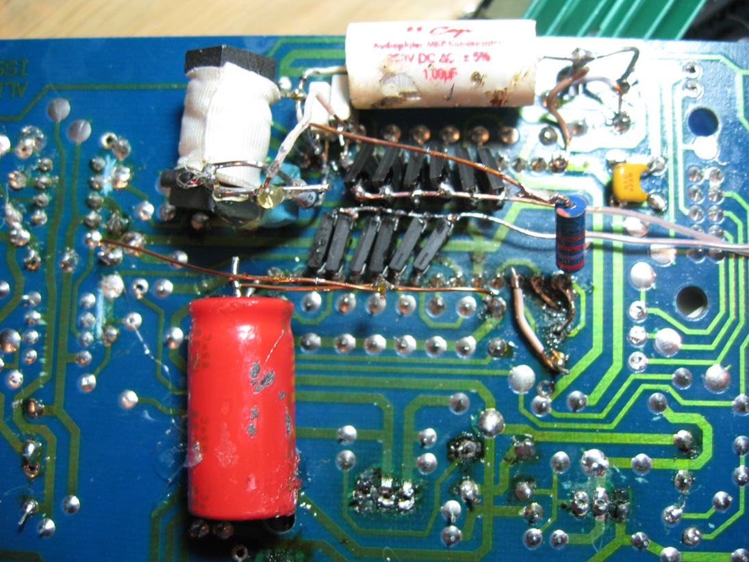

A quick question... were the Cornell-Dubilier SMD poly caps you used the PEN, PPS, or acrylic film caps?
Hi Greg,
I used the following cap for decoupling the 14 pins on the 1541a, and on the power pin of the pcm2706 and the clock. I intend to pick up some more and experiment further. My use of these promted some lively debate. Apparently with a higher leakage current that the film caps the debaters suggested I am losing at least one bit of definition. Once the dust finally settled on the issue, it was concluded that this would likely be inaudible. At some point I plan to change out the organic and replace with the film. Problem is I am just plain too happy with the sound to want to mess with it.
ECdesigns has move away from ceramic caps and advocates these film caps.
CORNELL DUBILIER|FCA1210C105M-G2|CAPACITOR ACRYLIC FILM 1UF, 16V
He cites "problems with reliability and performance" with the ceramics.
