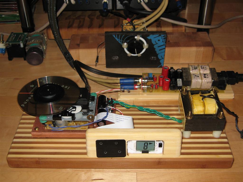

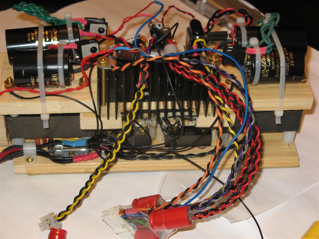

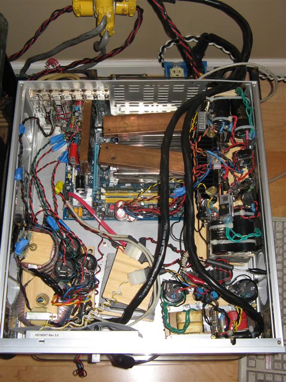

Here's a few pix of my cMP in a near-current state. It shows the three linear supplies for the soundcard, DAC, & +- for the output stage (plus one for the muting circuit), the two linear supplies with one powering the HDD & SDD (not added at the time of the picture) and the other powering the USB and the touchscreen, and the four linear supplies providing 3.3v, 5v, 12v, & 12v for the ATX-20 & P4 (plus one powering the 5v turn-on control lines... the 9v battery used for -12v is no longer in that supply as my current MoBo does not need it).
And if you look carefully over the back edge of the picture that includes the case, you'll see the choke-filters on the AC lines!

On the cMP's ATX-20 & P4 regulators, I started out with LT-1083 regs for each spot... they were slightly better using John Bau's optimized circuit instead of the stock one.
Now I have Belleson hi-current regs on both the ATX-20 12v & the P4 12v lines... VERY nice improvement with those. I also tried one of those Belleson's in the ATX-20 5v line... not as successful there, I suspect it either did not have sufficient voltage headroom (3.4v headroom under load) or it may just have not been happy with the current level (see below). I have another transformer for the 5v supply that will give me about 2v more headroom to try... just haven't had time to do it yet.
I also went to LT3080 regs on the HDD/SDD & USB/screen supplies which didn't require the current capability of the LT1083 & these also were upgrades sonically.
In doing a linear supply for the Mobo, it is key to understand your current requirements and stay within the limitations of your supplies & regs. All of my regs are pretty high current, but the transformers for the ATX 12v & 3.3v supplies would be pushed if asked to supply much more than 2a (IMHO). I'm using the GA-G31M-S2L board and with the fully-configured cMP setup, my currents are:
P4 12V .45A-.47A (6w, Hammond 166N24, 2 diodes, 18VDC raw)
P20 12V .08A-.12A (1.2w, Hammond 229D24, 2 diodes, 19VDC raw)
P20 5V 2.2A-2.4A (11w, Hammond 166R12, 2 diodes, 8.4VDC raw)
P20 3.3V .27A-.31A (1w, Hammond 229D10, 2 diodes to give 8.7V)
These are the original transformers I used, I went through 3 Hammond 166R12 to find one that didn't hum after awhile and changed the Hammond 229D10 to another brand (have to check my notes if you are interested) after having two that hummed after awhile.
One nice thing is that the linear supply let me lower the CPU voltage another notch or two down to .72500v... I found that one step lower was possible too, but did not sound as good!

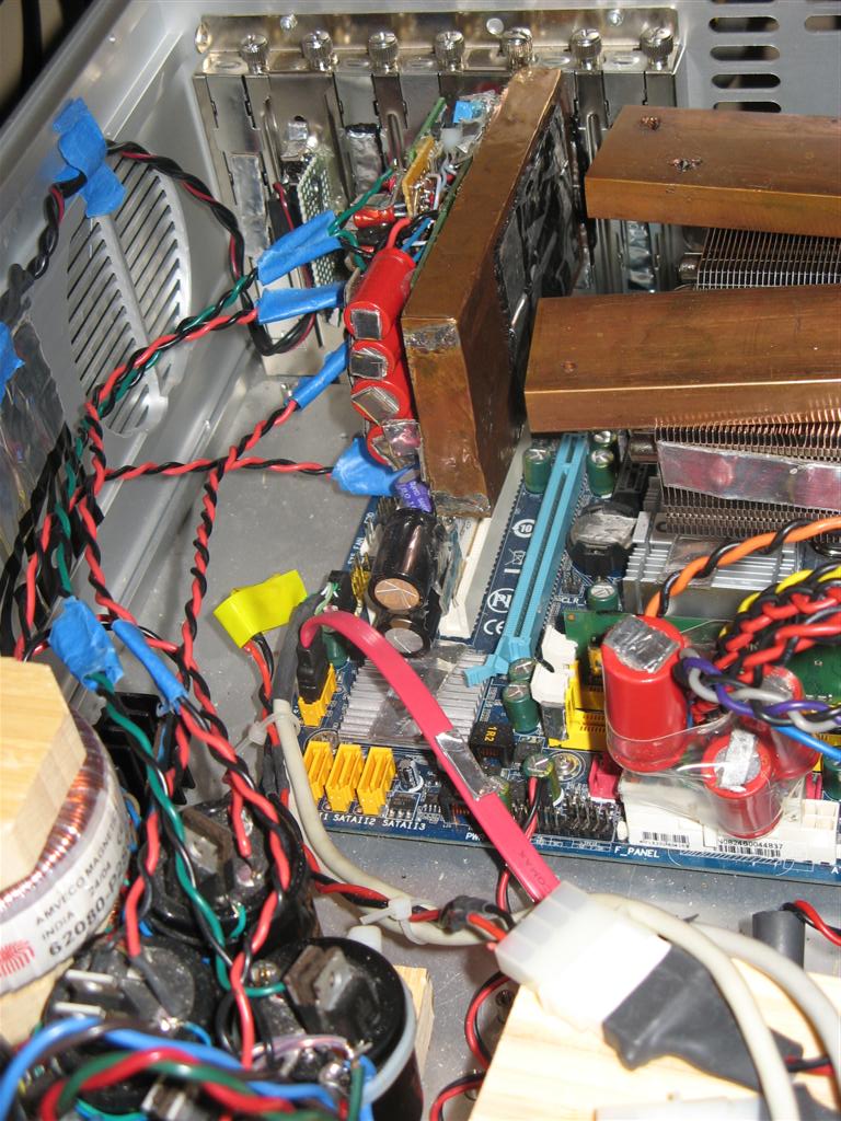

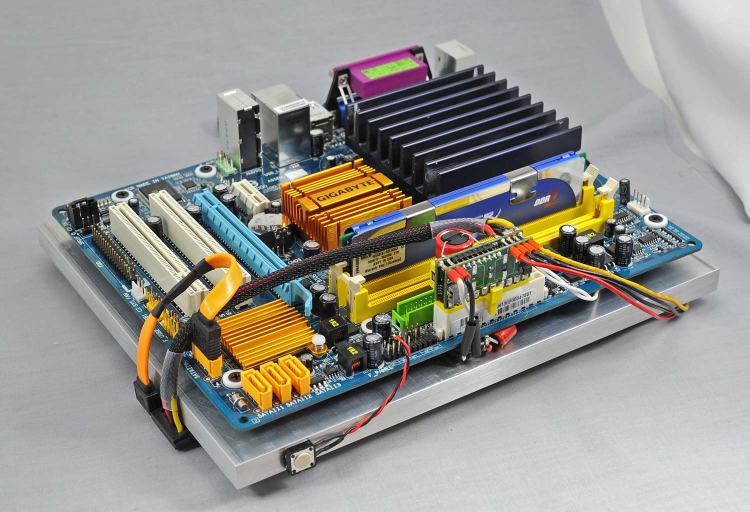

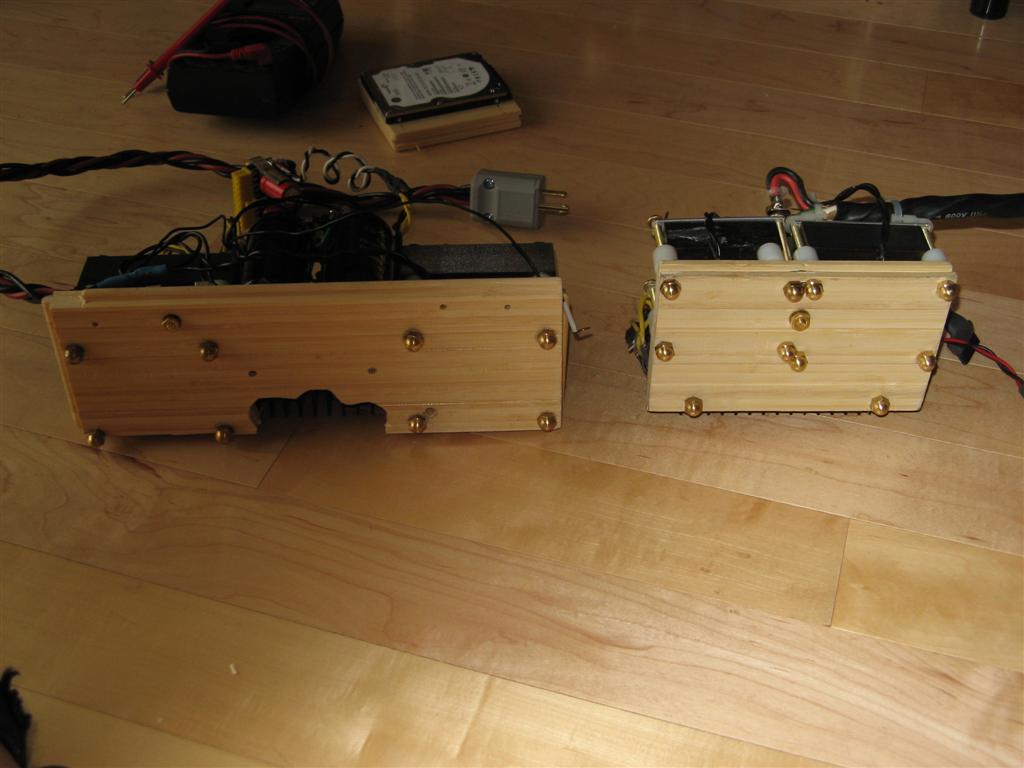

Your rig looks really impressive Greg - and that really means something coming from me, because I am not easily impressed. Great inspiration.
I like how you mount your transformers using wood - I also found that advantageous. You might want to try encasing your capacitors in wood too (get a small piece of wood, drill it out a bit and put your capacitor in the hole, wrapped in cotton or silk for a snug fit).
Also, it's great to see that some people still have some Black Gates N left 😉
I'm a bit baffled by the copper pieces - what is their purpose?...

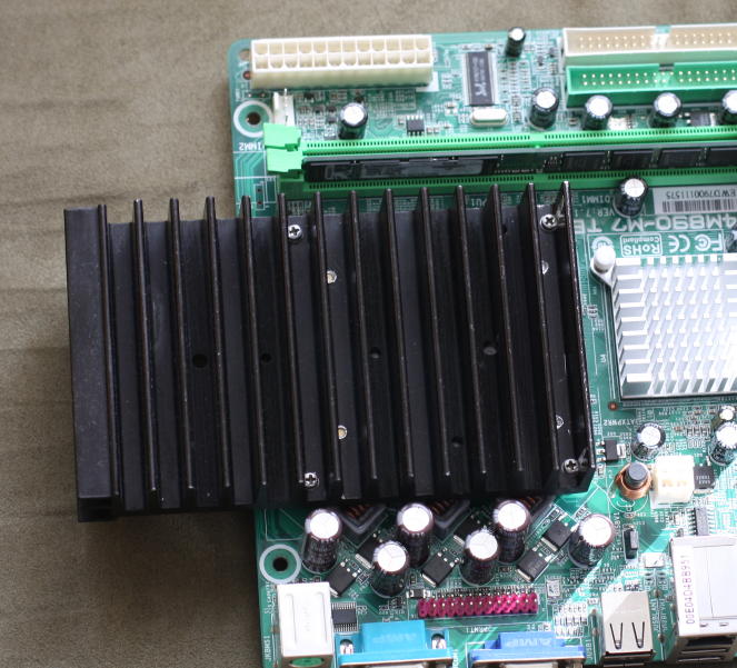

I laid in a small stock of these boards as they were fairly inexpensive at their end-of-life & I won't feel so bad butchering them. Then after I've gotten some good results (and let some smoke out!), I can duplicate the process on the then-current cMP boards

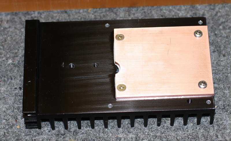

- The copper bars on the CPU heatsink are the remnants of my first try at a Shigaclone... Note the badly-drilled holes. Luckily I was saved by Peter's simplification of the mechanics. I attached a picture of my version.
They are merely there as an attempt to do some damping of that heatsink.
The copper chunk where the DAC is mounted is really a chunk of bamboo with a copper foil covering as an attempt to shield the DAC & output stages somewhat.

- Actually bamboo, not wood. I do need to spend some time (SOMEDAY!) listening to the signatures of various subtrates & bases. In the meantime, I depend a lot on the comparisons & opinions of those I who actually compare & listen & I find I can trust (even if I don't agree with everything they say, such as Thorsten's avid dislike of BGs). Hence my appreciation for your work on your line of capacitors... And while I didn't mention this before, my appreciation for the work you did on comparing capacitors on the Shigaclone.

My posts on doing that supply are here: Audio Asylum Thread Printer . My supply was very much the same as Peter's, but for the best sound, I recommend the following changes:
1. Use a variable LT-1083 instead of the fixed one. This allows you to bypass the voltage setting resistor with a good capacitor, lowering the output noise. For extra credit, find John Bau's (designer of the Spica time-coherent linear-phase speakers!) DIYAUDIO thread here: http://www.diyaudio.com/forums/power-supplies/143539-another-look-lm317-lm337-regulators.html on optimizing the 317/337 regulators and use his circuit instead of the stock datasheet one (it works for the 1083 too!).
2. Use very good caps for the raw DC filter caps... I used Jenson 4-pole caps, BG FK would also be good here.
3. Build a 2nd regulated 12v supply to power the CPU via the P4 connector. As it is a 'dirty' power consumer, use a separate AC cord & connect it to a separate AC circuit from the rest of your system.
People have reported that you want to stick with the standard PicoPSUs, not the 'wide range' ones designed for battery power... They reported that the wide-range ones did not provide much improvement over a standard computer supply.
I suggest you do a search on both the cMP & cPlay threads and the larger PC Audio Asylum for posts on PicoPSU's for more details on how to best implement them. For example, there's a recent suggestion in the cMP thread on which PicoPSU model sounds best.
Then there is a recent move to provide additional filtering on standard computer supplies using a heroic collection of clamp-on chokes & capacitors... See posts by hfavandepas here: Audio Asylum Thread Printer and here: Audio Asylum Thread Printer . This may provide a large measure of the SQ improvement of a PicoPSU powered by a good supply and may even surpass it, but the same techniques applied to the PicoPSU setup will also provide benefits and I suspect, lift it higher. I also suspect that this technique will provide benefits on a fully-linear supply like I currently use, but before I go there, I want to first repackage the regulators & heatsinks such that they are mounted on the ATX-20/24 & P4 connectors and the connecting wiring between the regulator outputs and plugs is very minimal.
And do note that the current 'official' cMP power recommendation is to use a 2nd computer supply for the P4 & other dirty components powered via a separate power cord to a 2nd AC circuit.
But my experience & impression is that you'll get the best results replacing the SMPS computer supply with good linear ones.

You made me miss good surplus stores. Here in the rural areas of Mississippi, they don't exist. In Fort Wayne Indiana where I grew up & in Minneapolis where I lived for about 20 years before moving down here, I had access to very good surplus outlets & hamfests. Great deals on Shallco/Daven multiple-position switches for selectors & volume controls, good resistors, capacitors, semiconductors, & transformers, & even some great & reasonably priced NOS tubes were all available. I'm glad I stocked as much as I did back then and wish I'd gotten more! I'm envious on your Plitron deals!
Also, thanks for the info on your I/V. I was planning to try Thorsten's circuit for the TDA1541 on that and the same somewhat modified as an I/V stage on the Buffalo DAC's ES9018.

I'm really impressed with how you are working out of the box. Electrolytic caps outside of the ally case/rubber plug paradigm could be very, very trick. I really look forward to your work on these and on reviving (and hopefully improving on) the Black Gates!
Also thanks for the tips on damping the heatsink. I do have some EAR SD40AL on the sides of the heatsinks which also helps. Long-term, I want to try some smaller and easier-to-damp heatsinks such as the ones Peter D showed here: http://www.diyaudio.com/forums/audi...hip-amp-kits-dacs-chassis-52.html#post1787334 & here: http://www.diyaudio.com/forums/audi...hip-amp-kits-dacs-chassis-50.html#post1706933 . I also attached some other Peter D computer setup pictures that he does not have available online anymore.
Related, my cMP responds very well to vibration-management tweaks. It is on a damped glass platform support stand, sitting on Herbies Iso-cups. I use a combination of the above-mentioned EAR SD40AL and Dynamat Xtreme to damp the case, heatsinks, & electronic components such as capacitors. I have the damping pads from the original Herbie tube dampers on the motherboard mounting posts. And my power supplies and drives are either coupled via brass acorn nuts on the transformer brass mounting bolts or decoupled using various Herbies devices. Power supplies & the drives are plus all the wires are carefully dressed so that they are not touching other components or each other (when possible).
All of this is key the the sound I get... Especially the subcomponent & wire dressing. Just having a wire touching one of the power supplies or a drive will take it from sounding good to just ok.
And I am quite sure I really don't have this arena optimized yet.

A couple more thoughts on regulators for a fully linear supply...
After trying different regulators in my various supplies over time, this was the progression from good to best:
LT-1083 fixed -> LT-1083 variable w/bypass -> Lt-1083 Bau circuit -> LT-3080 -> Belleson high-current
Some I haven't tried yet, but I suspect will have merit are:
- paralleled LT-3080 for higher current
- AMB Sigma
- Twisted Pear Placid HDs
- Salas low-voltage high-current (see here: http://www.diyaudio.com/forums/power-supplies/168631-5v-high-current-low-noise-regulator.html)
- Paul Hynes'
My only short-term plans for upgrades to my linear supply is to try a transformer that will give me a little more raw DC voltage & re-try the Belleson 5v, hopefully later this fall.
At some point, I'll try a Belleson 3.3v there, but right now it's slated for a shoot-out between Dexa / Belleson / Hynes / LiFePO4 battery sources on the Juli@ digital section for my Buffalo-II.

On the startup, I only have experience with three boards... All Gigabytes, the GA-G31M-S2L, the GA-G31M-ES2L, and the GA-G31M-UD2H board. The ES2L required -12v to start... The others did not. And the UD2H had a somewhat different startup behavior.
To start the S2L and ES2L, here's what I do:
1st - Apply power to the 12v P4 and the ATX 3.3v, 5v, 12v, and -12v (if needed) rails AND to the 5vSB (no time delays needed)
2nd - Press power button (momentary contact switch connected to the motherboard power switch header... In a pinch, I've bridged it with a screwdriver!)
3rd - Flip a switch to apply 5v to the ATX PWR_OK
That's it! If you wanted to make it a bit fancier, you could trigger a 1-second delay relay off of pushing the power button... But that's not really needed.
With the GA-G31M-UD2H board, I add a fourth step:
4th - Wait 8-12 seconds, then switch off the PWR_OK for 1-2 seconds, then switch it back on
