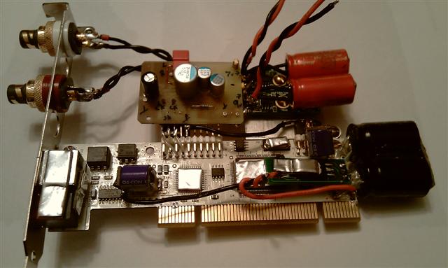

well i just soldered a gold-plated rca at the pins of the din connector under the board via two 10 cm of 20awg silver-plated wire so that it hangs outside my comp. very ghetto. nothing to be excited about really but it gets the job done. but if you really want pics anyway just ask and next time i have a camera in my possesion i ll upload pics 🙂
it s the first gen buffalo with sigmas here and there powering it.
i put caps at the same places you see on the picture of the digital board.
regarding the sigmas,though not ideal under 5V or so, they serve me very well. i just put two sockets for a diode and a resistor, which affect the output voltage, so i can swap psus in an instant. i also think AMB deserves the highest respect for their effort and god knows it s not wasted!

oops forgot:
on my buffalo i just put the clock the buf32 has and took out the 3.3v reg in order to put a sigma. nothing hardcore. i ll try to post pics next time i have a camera. i suggest you search the buffalo threads out there.a lot of people are putting efforts to mod it and are posting pics.

I found the device directly upstream of the output dongle connector and soldered there. Bypasses a bit of circuit trace. Might be an improvement, might not, I never tried it any other way. OTOH, it'd be easy for you to move your connections to that point.

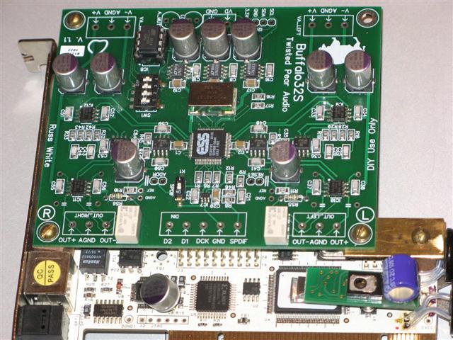

first thing i did with the buffalo was going dual over single sigma supply for va and vd. it made a moderate improvement. then i injected directly 3.3v into VD and removed the 3.3v reg. that made a pretty big improvement. then i replaced the clock and it did a nice improvent there too. certainly worth the price for the new crystal. even smoother and detailed sound. but without the new improved supply, not sure it s worth it. i tried a sigma for both avcc and did not notice anything really improved. might be the sigma is showing signs of "choking" for that a low voltage.dont know.next think i try is separate psu for avcc. but first: clean 3.3v in the sound card digital board

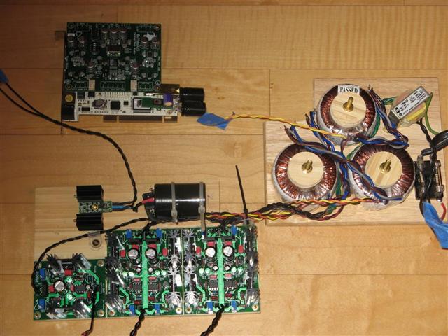

Alternative DAC cards on Juli@ Digital Section...
Sorry I haven't posted much in awhile. Been working on I2S-connected DACs to fit on the Juli@ and provide an integrated solution with no compromise. The latest is what I call a 'Buffa-Juli@, where I've mounted a Twisted Pear Audio Buffalo 32 card on the Juli@ and powered it via their Placid shunt regulators. I'm setting this up for a friend of mine and currently burning it in and tweaking it up a a little in my system.
Sound is very good... even, detailed, and very listenable. I've also got an AK4399-based Juli@-mounted DAC card that I've tweaking and in comparison, the Buff32 wins out on detail and even frequency balance while the AK4399 setup has a bit more PRAT and a more liquid midrange. I could live with either, but the Buff32 has enough potential that I popped for one of the new Buffalo-IIs when pre-orders opened tonight... had to be fast, they sold out in 2 1/2 minutes!
I'm very excited about the Buffalo-II as they've reconfigured it to allow easy tweaking, especially around the power supplies, I/V, and filter stages. Lotsa possibilities with it!

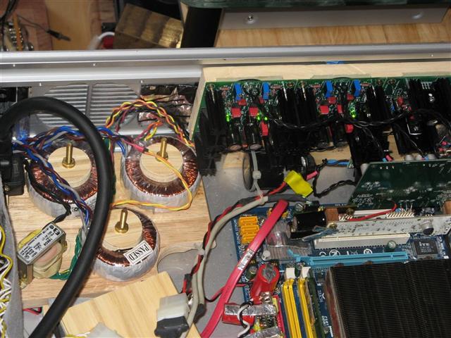

Nice work!
Regarding the mobo in the last pic. Is that powered by a linear PSU? I am asking because I thought I've seen some large caps near the memory sockets, and I believe there's the ATX power plug too...
Thanks, SunRa.
The system is powered by a Linear-hybrid ATX supply, using a good linear supply to feed a modified Pico-PSU. The large caps you see are local bypasses on the Pico inspired by Peter Daniel... he only added them on the input to the Pico, these are the ones for the 3.3v & 5v outputs.

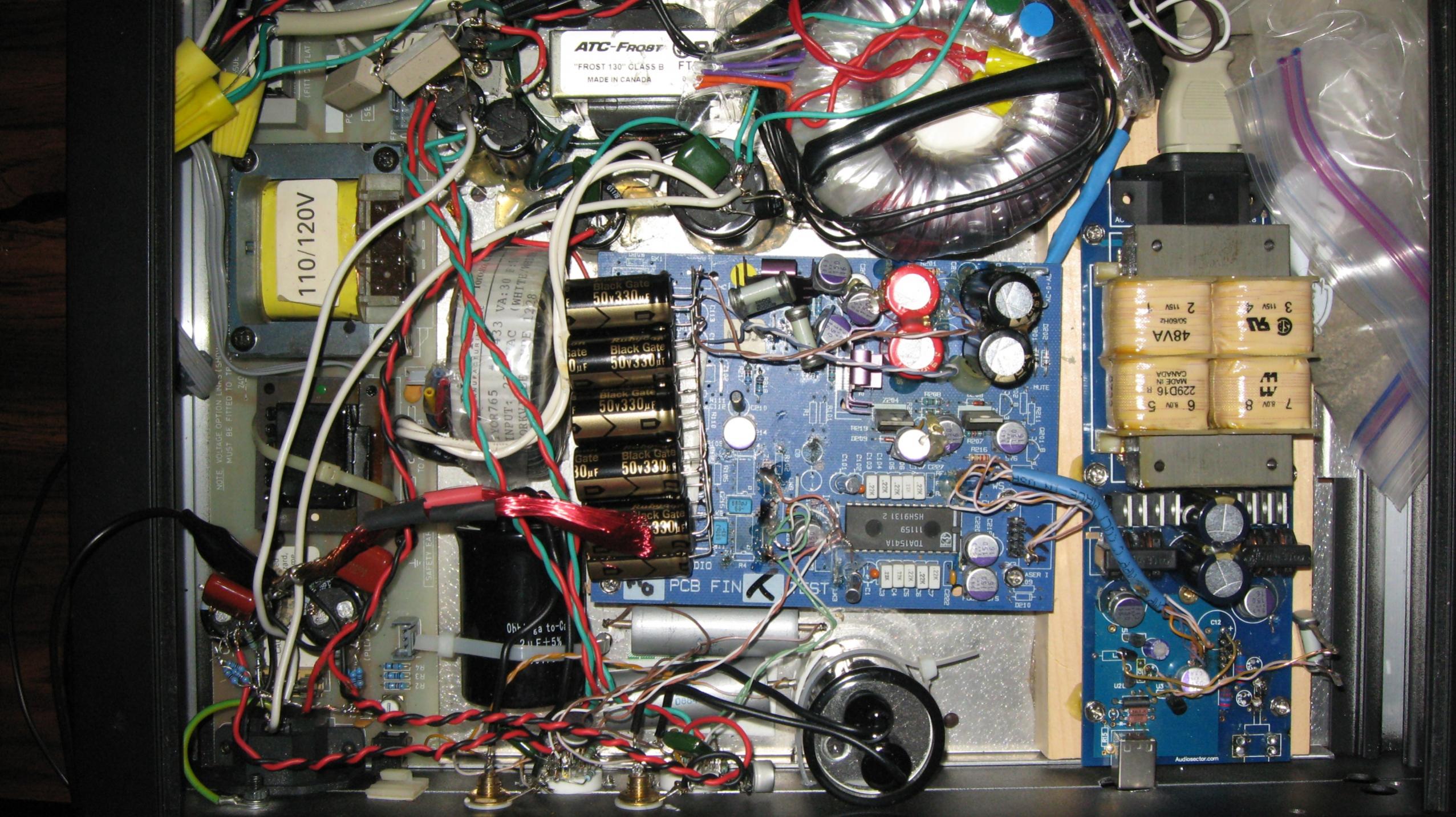

1541a with Peter's DAC driving i2S
Greg
Love your work. That is one of the most radical 1541's I have seen to date. When you get to it, if you have not done the DEM reclocking tweek, that's top of list. $1 and a simple mod but it is night and day jump up. EC Designs has it figured out.
Attached is a pic one rev old. I have since added Burson regs on -15 and -5 so the board is getting pretty crowded. I have the parts arriving for Bobkin's Series reg so that goes on the +5 on the week end.
The DAC board came from an ARCAM Alpha CDP. In fact the DAC is now in the old ARCAM case. The USB hits Peter's board. The 1543 is removed and it simply produces I2S. This goes via short CATV to 1541a input. Output goes straight to Russian 6n2p triodes and on to the amp.

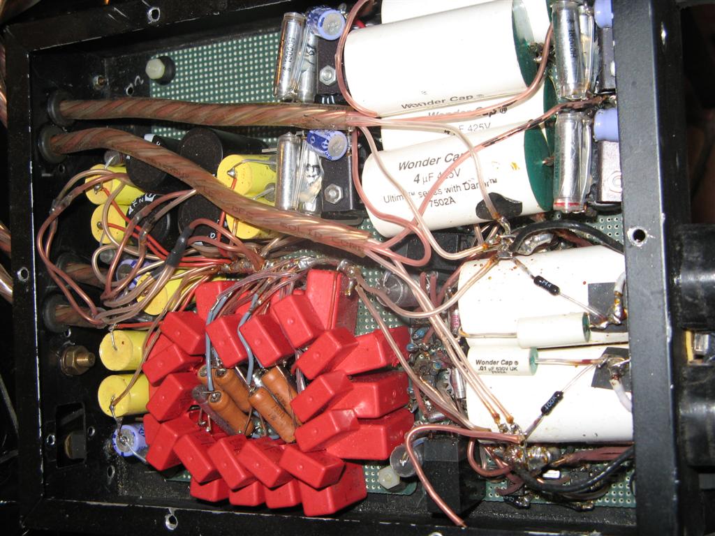

Peter's board has Oscon SEP caps replacing the BG N's. The power supply for the 1543 now powers the clock (small jump). Will soon have Bobkin regs.
All old supply caps on the 1541 replaced with lots of BG STD followed by BG N. Oscon SEP near the consumers. DEM is reclocked to WS or 44.1. This cuts a bunch of jitter produced by the oscillator at pins 16 & 17. I connected I2S directly to pins 1-4. Most advocate a signal attenuator. Maybe later.
The rest of the box is full of power supplies for the tube output stage. Choke supply on the B+ was a nice add. Also, the output of the tubes are coupled using Obligatto PIO with Russian Teflon bypass (also nice). I have found that Russian KBG PIO is a step up, but I am ok with the Obligattos.
I also found the whole thing likes to run on good mains. I run it via a power conditioner based on a large toriod isolation transformer with caps and RF filters.
The other Key to Peter's was the pure ASIO driver.
I enjoyed Peter's DAC as designed, but to my ear, I far prefer the current state.
