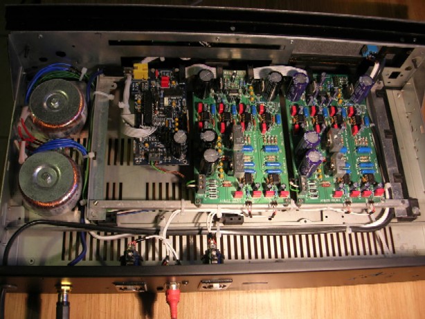

Time for me to share some great news, just couldn't keep it for myself a whole night 🙂
After some brakes and frustrations with the data sheet
it creates sound and even for the setup some damn find sound.
DTS and DD all sound pretty fine.
2 days earlier the project got a jump start in finding Tomek article and download of the board and schematic in a Polish magazine. It is in Protel 99SE format. Get the files here.
This got the PLL filters right for me and apparently it was the only thing left of the schematic, the rest worked fine for months
The project is far from identical to that of Tomek. It is still very much vero and breadboard at this point.
So far only Left an Right channels have a DAC/IV attached to them, but for a first test it will be fine, there is data coming out of the other I2S data lines. The dac is a PCM1798 with 6xOPA132 IV following the dac data sheet.
The STA310 is controlled with a FTDI usb controller in I2C mode. This allowed for some register tweaking on the fly with a home brew VB program. Came in very handy for debugging the "fully" documented registers of the STA310 data sheet.
I'm now gonna bug you guys with some pictures, I'm just to damn proud this evening 😀
(Just hit the enter button once more, forbidden warning is bugging us)
First picture is the STA310 with the PLL filters and the FTDI usb chip.
http://www.wirdumonline.nl/DAC/01_STA310_USB.jpg
Very high end I2C cabling
http://www.wirdumonline.nl/DAC/02_I2S.jpg
DAC with IV, again the high-end I lines
http://www.wirdumonline.nl/DAC/03_DAC_IV.jpg
Power supply, nothing fancy, one regulator per supply, even a boring heatsink 😉
http://www.wirdumonline.nl/DAC/04_powersupply.jpg
How its all connected
http://www.wirdumonline.nl/DAC/05_overview.jpg
The program I made, just show a small part of the register values
http://www.wirdumonline.nl/DAC/06_vb_util.jpg

Cool prototyping 😀 Could you measure the high pass filter functionality for front speakers, if you put speakers "small" ? It would be nice to know.
Well I would if I could 🙂
I tried using the sound card with just a DTS audio stream, it is hard to see of course with an audio stream. But I see some lower level on 200Hz an an great level of att. at 100Hz and below. In my eyes there would be a -3dB point in the regions of 120..150Hz. But at which order...? 2nd maybe.
If you might have any suggestion for a nice test DVD it would come in rather handy.
