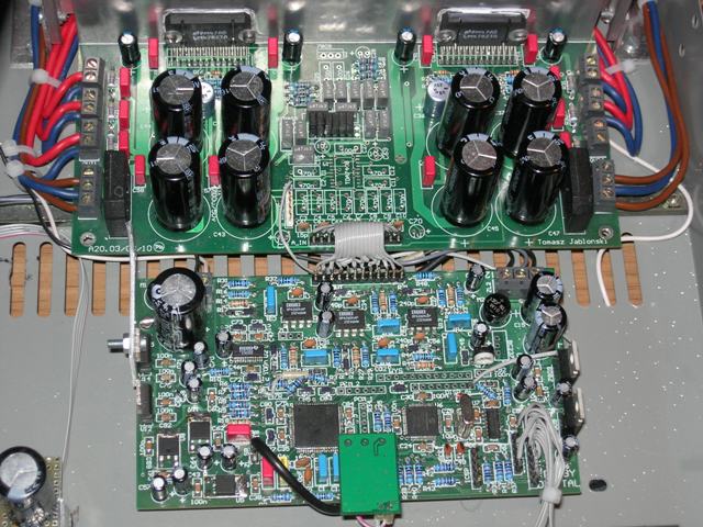

my decoder is ready 🙂. It workinng with 6 channel power amplifier.

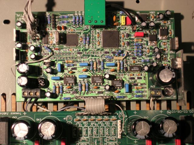

Decoder module contain:
1. power section: +5VD (DAC), +3,3VD (STA310), +2,5VD (STA310), +2,5VA (S/PDIF section STA310), +5VA (DAC) and +/-9V for low-pass DAC filter
2. STA310 section with 25MHz system clock module
3. controller PIC18F6722
4. 8channel DAC PCM1680
5. 6channel low-pass filter (3xOPA2604)
Power amplifier based on two LM4782. It's 6x20Watt amplifier.
Decoder can decode (PIC software configuration)
1. Dolby Digital stream
2. DTS steram
3. PCM (Compact Disc)
2. DTS steram
