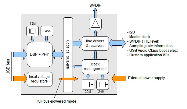

Where is it isolated?
My question about the diyinkh 'Isolated 24bit 192kHz USB to I2S/SPDIF CM6631A PCB' is where it is isolated:
- at the output so just 'before' the output plug and after the DSP
- at the input just 'behind' the USB plug, so to say
the first quickly adding some jitter again.
Sorry, I can't find the documentation 😕 it my laziness today to ask.
albert
Isolate on i2s, after cm6631a. No usb isolator for this [high] speed device, only for slow usb.
Ah, I was asking for the dreamware, the impossibilistics 😱
thanks
NOT if you do it the right way! 😉where it is isolated:
That is, you have to put the clock(s) "on the clean side", send the required clock back to the USB interface through another isolator and do (synchronous) reclock the I2S signals after the isolators. 😎
As properly done by: "USB Audio interface | ABC PCB"
