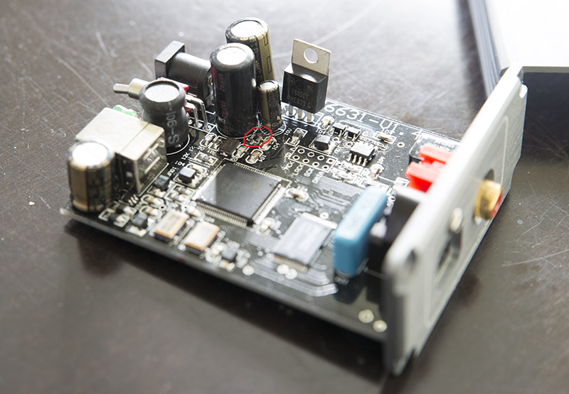

I've recently found a solution for issue that caused when CM6631A module is connected to any Mac USB 2.0 ports.
When you connect module to Mac it is detected as USB Audio Class 1.0 device and you have no ability to use anything more than 48/16.
Module has a reset chip LM810M3-2.93 (http://www.nscrus.ru/content/catalog/pdf/LM810.pdf), but as we can see from the CM6631/32 datasheet, the CM6631A has a power-on self-reset.
So, reset chip has been removed from a board and now the module is always correctly detected as USB Audio Class 2.0 device on any Mac USB port.
This method has been tested on MacBook Pro, Mac Mini and this CM6631A module:
New CM6631 USB Module Assembled Board for DAC3 AD1955 DAC7 WM8741 by Weiliang | eBay
LM810M3-2.93 is a 3-pin chip located on the top of CM6631A.
That's interesting.
So you just need to remove it and not jumper anything?
Yes, you are right. XRST (reset) input of CM6631A (pin 98) is internally pulled-down and LM810 is triggering it high (3.3V) when the voltage threshold is obtained (2.93v).
So, when you remove LM810, CM6631A is doing self-reset at power on.
To be sure, is that the chip that is marked "SA B"?
Yes it is 3-pin small chip marked "SA B". I've seen it at many different PCB layouts of CM6631/CM6631A and it is located near pin 98.
Thank you for the tip! Just removed the "SA B" 3-pin chip and it works wonders now on my MacBooks. No problems with 24/88+ now.
Included a picture to show location of the chip on my board...
