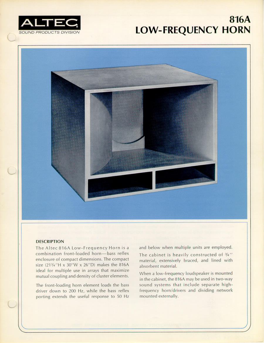

A nother example when you have a bass horn the horn has good loading down to say 50Hz. Under 50 Hz the impedance will rise. So in that case often also a BR-tube is placed in the closed volume of the frontloaded horn. So we have stil acoustic load under 50 Hz this wil work down to some where 45hz. So the you strech the output down to 45Hz with out BR loading it would fal of at 50Hz. So you win 5Hz.
Like in this picture a cone driver loaded at the front with a horn. The close volume is loaded with a BR-port.
So you do not have to think in TL or BR or horn or open baffle. But in acoustic load for your cone-driver.
