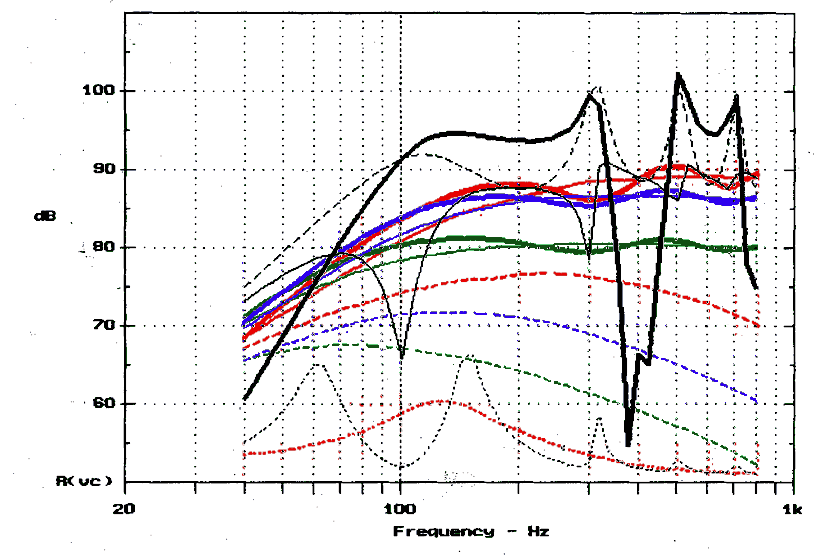

The speed of sound may not vary drastically, but the resonance frequencies do go down. Augspurger shows the 1 wavelength dip (between the 3/4 resonance and 5/4 resonance) drop from 400 Hz to 300Hz with stuffing in his examples, a 33% wavelength increase. He gets the quarter wave resonance to drop from 100 Hz to 80 Hz.
David
So what is your explanation as to why this happens? Which plots are you looking at and comparing in his papers to make these observations?
Martin
6b on page 429 vs. 7b., 8a and 8b. on 430 and 431.
I don't need to explain it. You're the one who's skeptical. I'm just reporting what his study shows.

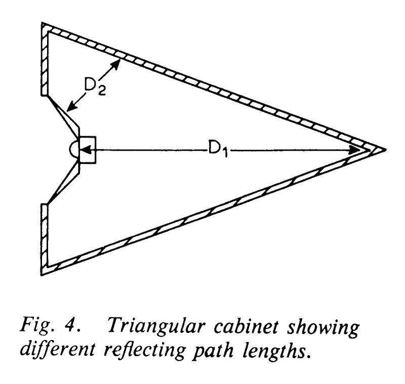

A.R. Bailey showed something like this in fig. 4 of his 1972 Wireless World article: The Transmisiion-line Loudspeaker Enclosure.
Here is Fig 4 from his 1975 WW : A Non-resonant Loudspeaker Enclosure.
I wasn't aware of any earlier articles on TLs... if you have something, i'd love a copy for my archives
dave

I looked at the plots you referenced and it is pretty obvious what is going on in the TL. My results would match the paper's plots very closely for the same driver and geometry. The SPL peaks corresponding to output from the open end of the straight TL are at fairly constant frequencies as stuffing is added, there is a slight drop with additional stuffing. The SPL peaks are a little misleading, a phase plot would have been a better way to identify the TL systems resonant frequencies.
The dips between the peaks are not indicators of resonances only how the quarter wavelength mode shapes above and below combine as frequency increases, the 100 Hz shift you noted is not really too significant.
Martin
By the time he gets to moderate stuffing (7b) the dips and peaks are due to the time delay of the port output adding in and out of phase with the woofer output. This is evident from the lower curve of pipe output which becomes a broad and very smooth mound. In fact, hard to call the line "resonant" as the Q is very low. It is merely a bandpass of contribution. The phase curve (of the port output) won't show resonances in this case, only the smoothly lagging phase of a fixed time delay.
Still, the dips are the only noteworth feature and they do drop 100 Hz.

Its OK, i figured out where i lead myself astray, by a decade, the non-resonant article is 1965, the one you refer to is the article with the triangulated TL. I have that. Fig 4 attached.
dave
