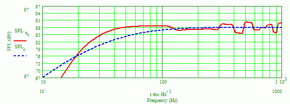

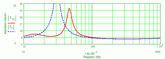

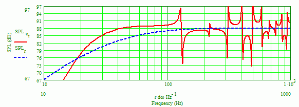

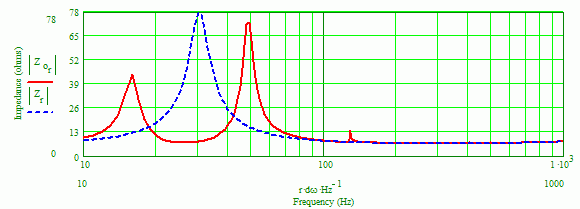

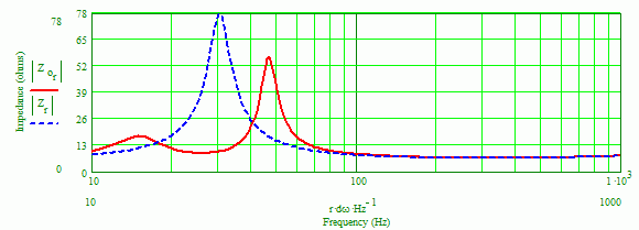

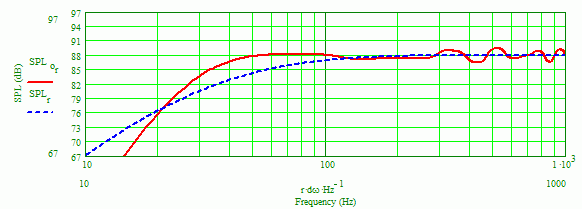

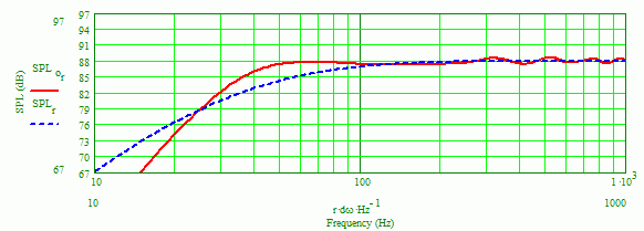

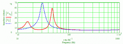

Primarily for my own edification, and for anyone else if interested, I modeled a tapered TL for an SS18W/8531. It's 72 inches long, is tapered at 10:1 and contains a volume of ~1.7 cubic feet. Starting off with no stuffing, I've attached two graphs, the overall system response and the impedance curve. Following those two graphs are 3 more pairs of graphs (in separate posts if necessary). The line was stuffed for the first 2/3 of its length at 0.25, 0.5 and 1.0 lb/ft3, respectively. If you "measure" the line's resonant frequency based on the frequency of the valley between the two impedance peaks, there is very little decrease shown as I see on the graphs. The graphs need to be "read" from left to right starting on the top row to get the right sequence.
Paul
A drop from 400 to 300 is more than a third of an octave. I have to assume that the same relationships would hold true no matter what length (frequency) line you were working with.

To flatten out the impedance you need to have good acoustic load at the resonance frequency.
Damping causes also a acoutic load only one you do not want. It is a dissipative acoustic load it only puts a brake on the cone of your driver.
So you do not have to think in TL or BR or horn or open baffle. But in acoustic load for your cone-driver.
A BR is a closed box with a BR-port that ads extra acoustic load at the resonance frequency.

Look at Dr. Em's curves. How much of that near 15dB response hole do you want? Do you want to trade a 15dB hole for a "flattened" impedance curve? Probably not, so stuff it until all reflections are gone and...why did we make it 1/2 wave long?

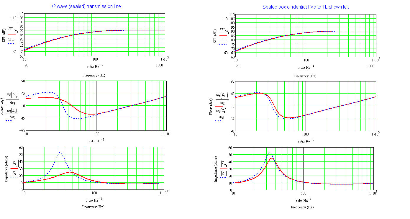

Can anyone give any evidence that a well damped 1/2 wave line is any different than a similarly stuffed enclosure of any other shape and the same volume?
Er, yes. See the attached. One half wave TL (as in a sealed, damped pipe with a physical length of 1/2 Fs) on the left. On the right, a sealed box with the same driver of the same total Vb with exactly the same quantity of damping.

There is no brake applied in the well damped case. Dr. Em's curves show what putting a brake on cone motion results in: a 15dB hole in response. Clearly this is undesirable. If you don't want that hole you apply damping. Killing the resonance equates to losing the braking. We can't have it both ways.
Here I will concede that you have reduced Z at resonance (from 45 to 25 ohms) with no apparent response effects. I could put an impedance conjugate across the driver and flatten it perfectly. Probably an acoustic resistance blanket across the unit would do the same. What was the benefit? Is this what the TL is all about?
