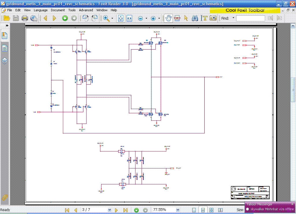

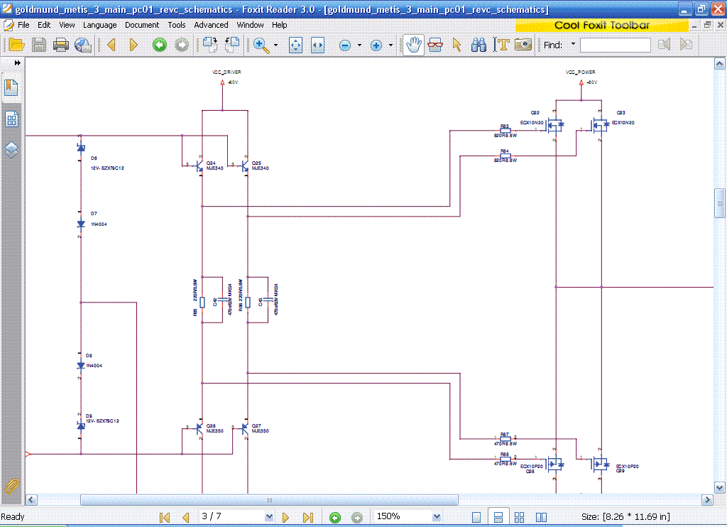

values on the gate resistors: 820 ohm for N channel and 470 ohm for P channel with lateral mosfet is 10N20+10P20
which class this amp working on?
only high power ? quality? distortion?noisy? bandwith?...
Amplifier working in class AB
Harmonic Distortion < 0.001%
Noise 116dB with intergrated amplifier
Noise 122dB with power amplifier
bandwith
10Hz-70Khz: +/-0.1dB
1Hz-200khZ: +/-1dB
capacity depends on model myclone
Original Metic 3 used driver MJE340+350

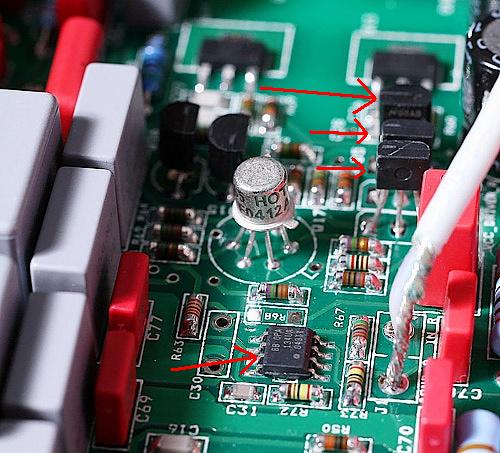

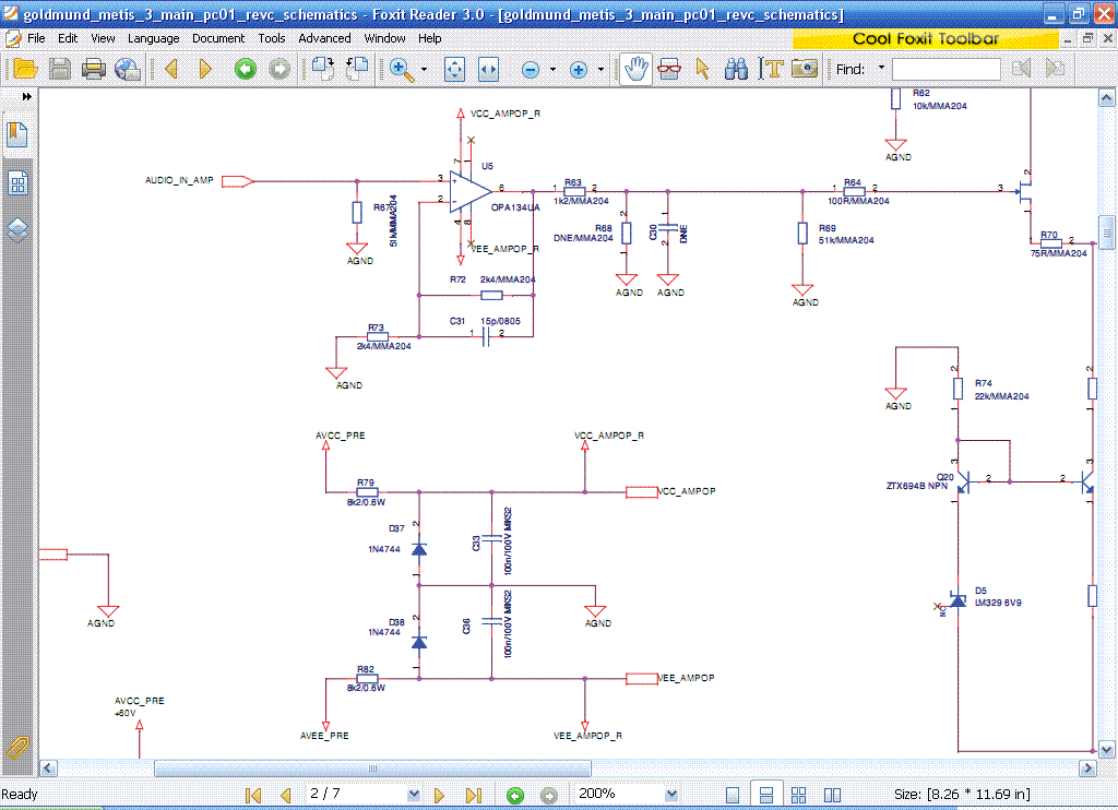

Can you show us the input stage also?

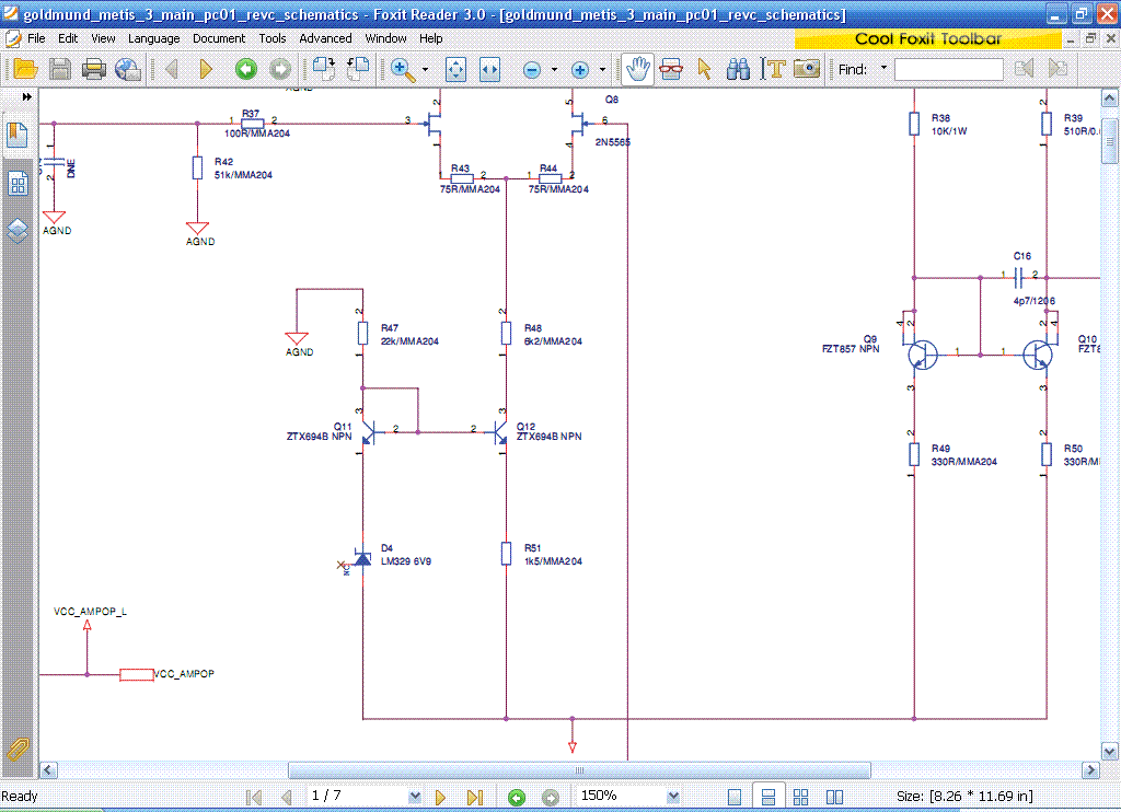

I think that the CCS is different from the MM9.2?
And one OPA134?
Your picture is this chanel,i see R72,C31 in the your picture
And one OPA134?
Can you show more pictures? i want to see layout original
Any change in this parts?

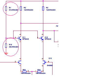

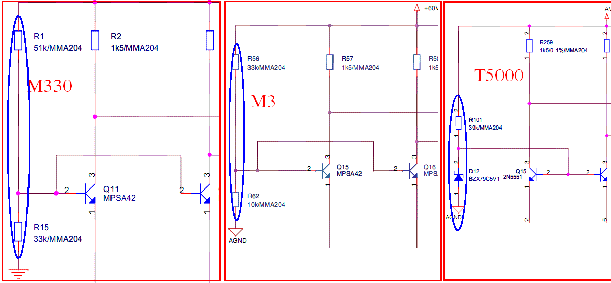

OK,it is R56 = 33K and R62 = 10K => Vb = (10/43)xVcc
Your post #108 is schematic Goldmund module job4,it used 56K and 33K,lateral mosfet output is K1058+J162,I have also this schematic but I dont know it use in what model Goldmund?
It is from Mimesis 330.
What about output DC and oscillation protection?
Controlled by the CPU? or is it analoge?
No,CPU control Volume(PGA2310 or PGA2311) and selector input (by relay) + display.
Protect DC and Oscillation,... by analoge.

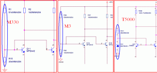

I think JFET input will hot because
Vc= (33/(56+33)xVcc)-0.6 # 26V,
I2c = 2mA x 2 unit = 4mA
P2c= 112mW => Hot => have DC at output.

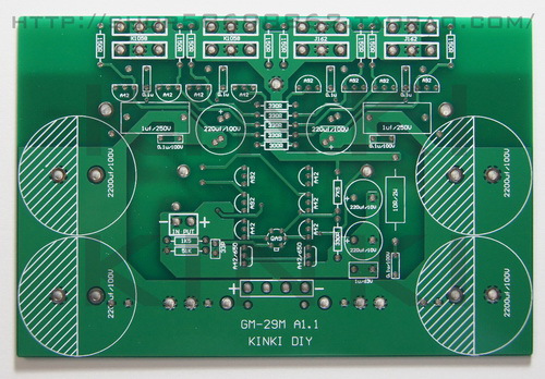

Chinese clone have use heatsink for dual jfet,can they use schematic M330?

I see what you mean. They will run hot. But they are rated at 650 mW total. (the genuine 2N5565). Maximum junction temperature is 150 degrees C.
Chinese clone is Mimesis 29, using MPSA for VAS and driver. They usually have a DC adjust but this one don't.

- schematic M3
Cascode stage
Iccs= 4mA,Vc= (10/43)x60-0.6 # 13V
Pc(2N5565) = 53mW
Vas
Ic(vas) = (2x1.5-0.6)/367.5/2 = 3.25mA
Pc = 220mW/1BJT
- Schematic M330( job4)
Cascode stage
Iccs=4mA,Vc= (33/89)x60-0.6 # 22V
Pc(2N5565) = 86mW
Vas
Ic(vas) = 4.66mA
Pc = 330mW/1BJT
- Schematic T5000
Cascode stage
Iccs=4mA,Vc=5.1-0.6 = 4.5V
Pc(2N5565) = 18mW
Vas
Ic(vas) = 4.66mA
Pc = 330mW/1BJT

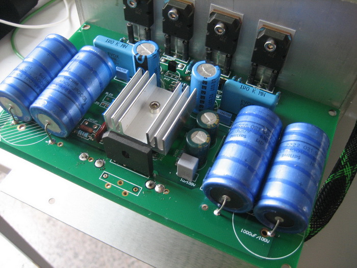

- Clone Goldmund Amplifier
