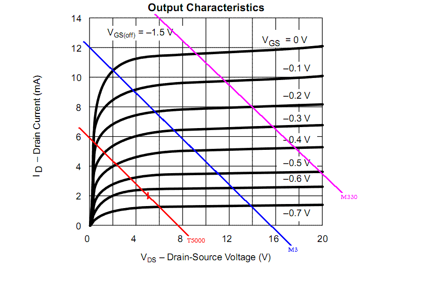

This is Rload line of 2N5565 in 3 cases T5000,M3,M330.
M330 is almost less than linear the 2 cases other.

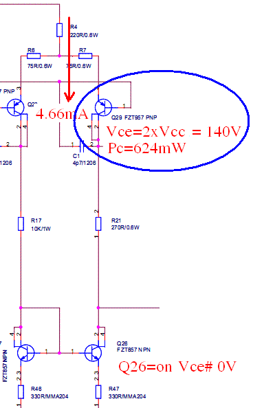

Can you show where in the schematic this problem can be found?
Here
Q26=on => Vce(Q26)#0V
Vce(Q29) = 2xVcc = 140V
while the current of Q29 is 4.66mA
=> Pc (Q29) = 624mW
How do the load line in post123 fit with the data in the recent posts?
We are discussing BJTs and yet post123 is clearly referring to FETs.
The upper limit of the posted load line graph is 20Vds. How does that relate to the 70Vce and 140Vce that you are stating?

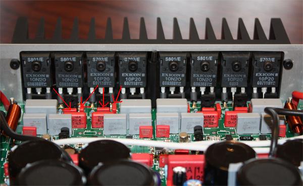

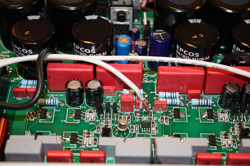

This is not a problem, the FZT957 in your schematic can handle 3000mW
(3W) total power. But only if coold off by the PCB, see picture. You can not replace this part with one MPSA92. (it will get too hot) But the MM9.2 and the chinese clone uses one MPSA92 in this position. That's why goldmund changed to FZT in later models.
Of course no problem with FZT.This is not a problem, the FZT957 in your schematic can handle 3000mW
I also had disputed the use of MPSA for Vas on another forum,very easy to damage 😀
No,my opinion is difference selected the voltage value in the cascode stage of models Goldmund.
It explains why the Chinese clone must use heatsink for 2N5565
It is not related to all post about Vas
Many DIYer clone by circuit M330#M9.2,... I think the circuit is not good by choosing Vb cascode (supply voltage Vd to the 2N5565) is not very reasonable not linear(Vs circuit M3,T5000,...),to explain the differences at value resistance couples(R1,R15).Tommy1000 ask me in the post#108.Well, why have you posted the information shown in post123?

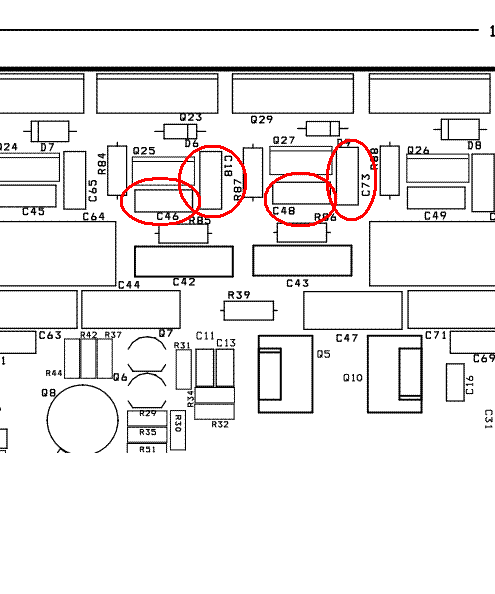

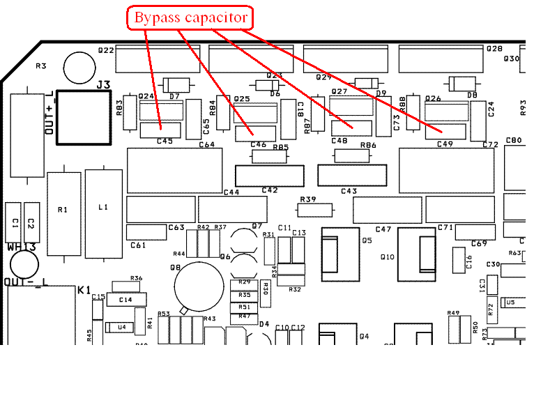

There are two small red capacitors around each driver. I can not find them in the metis schematic? Can you show me where they are?
There are bypass capacitor for Vcc(driver).It is 100nF/100V MKS2 Wima
Vcc(power) and Vcc(Driver) not direct connection together.It is connected through resistor,only Metis3 so
Here
Thanks, but the schematic says C45,C46, C48 and C49? What about the others?
I am wrong,bypass capacitor is C45,C46,C48,C49
