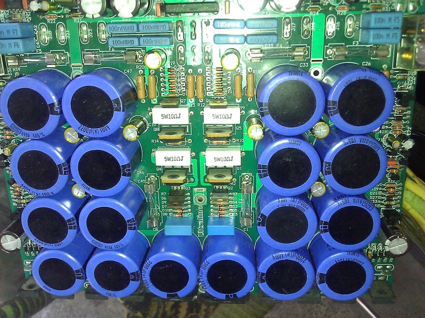

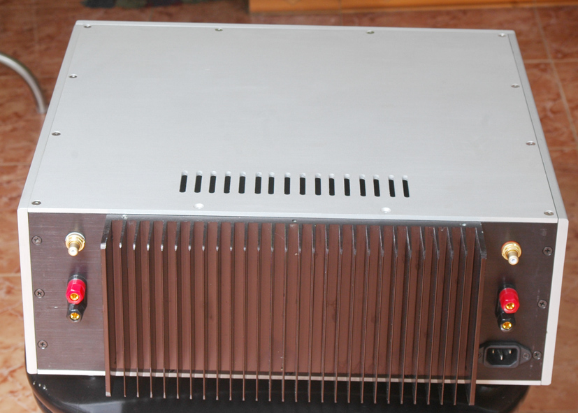

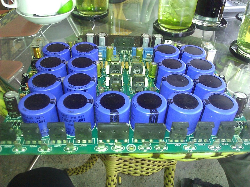

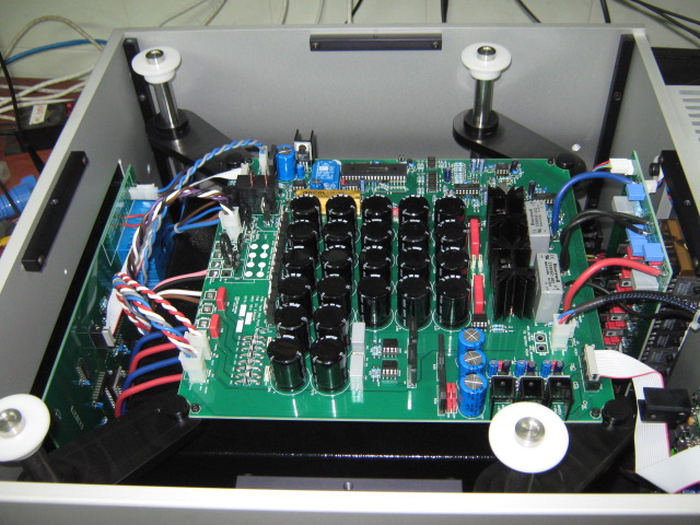

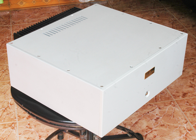

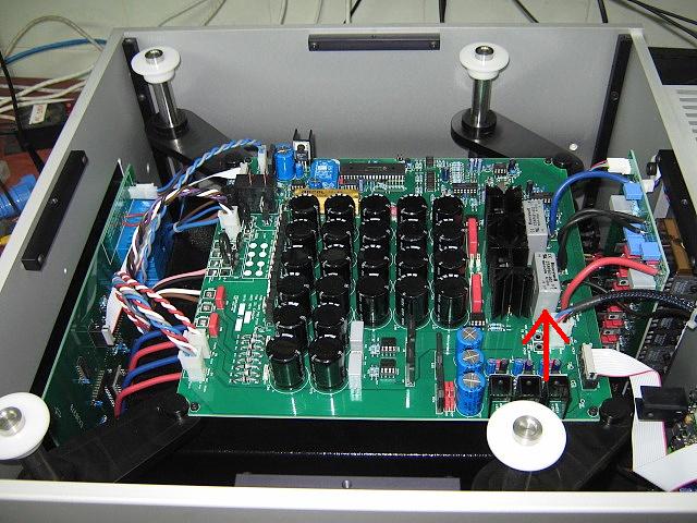

Hi bazouka
I try to use components on the circuit is the best.
The price of this amplifier is not very high
I can not buy MOSFET Goldmund 10N20 and 10P20, but instead I found with 2SK2221 and 2SJ352
Power diode: I use STTH6002, it differs Goldmund
Opam:I used AD 811,AD797,AD706J-SMD,AD586JN,OPA134,OPA2134,...
BJT: 2N5551,2N5565,FZT857,FZT957,...
Capacitor: Philips BC, Vishay BC,Wima,...
Resistor: Dale, SMD-MF(Panasonic).
Mosfet 8 pcs/1 chanel
Power transformer: 1000W
Have you checked here for the MOSFET:
Lateral Mosfet
