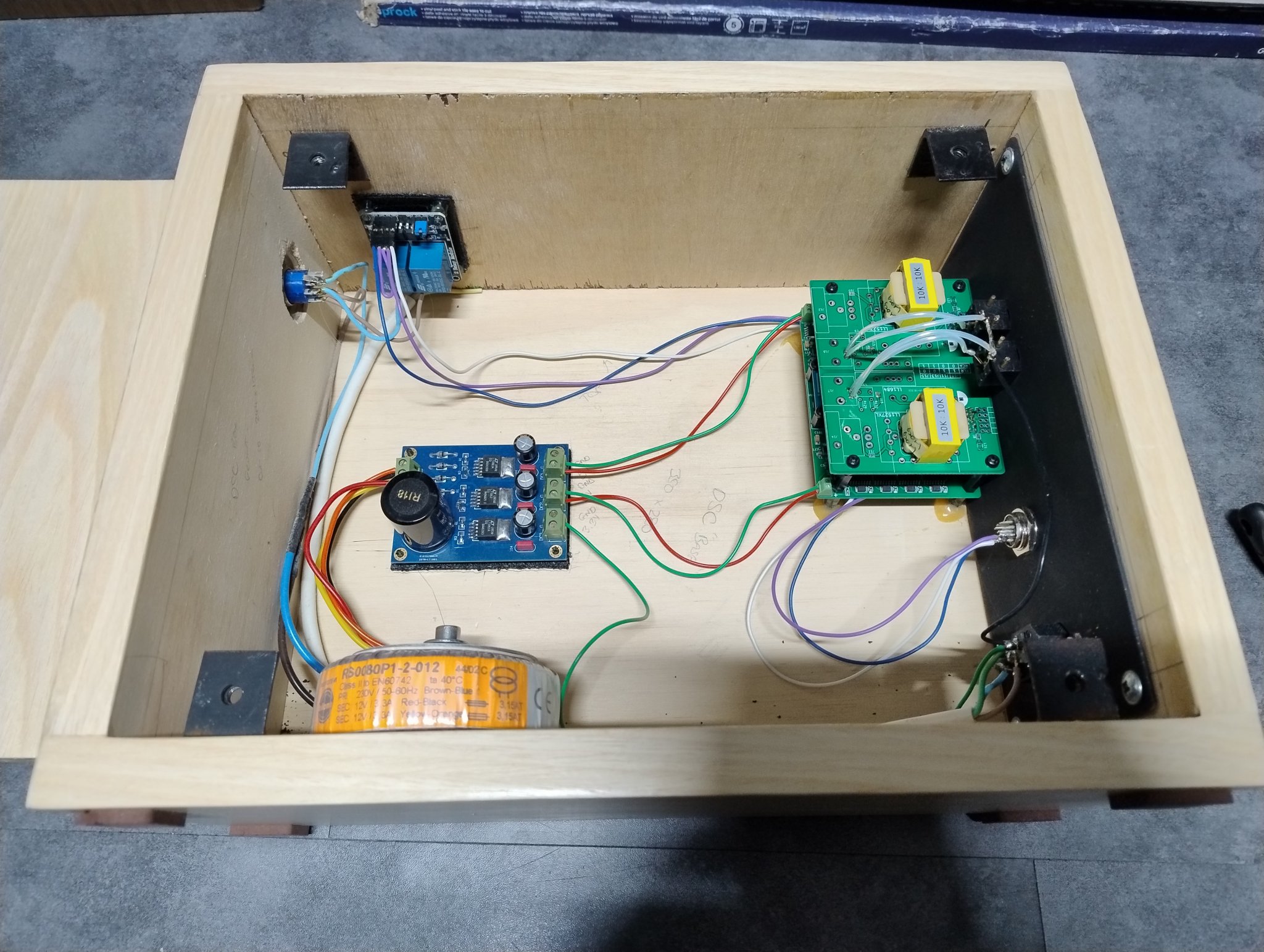

The RTZ replaces a DSC2.5 / Amanero that I have been using since around 2019. I typically use HQ Player to do on the fly conversion to DSD for music (44.1kHz WAV source files). To my ears, I thought that this setup was pretty good and it was much better than the previous Juli@ soundcard or the Behringer UMC404 that I still used, up until the RTZ (with the PCM2DSD FPGA DSD converter) for music/movies/games etc. Before that, I used a Micromega CD player for music.
Previous DSC2.5 build:
Previously, I just had to “slum it” for the AV stuff. This new DAC setup gives the chance of one decent DAC to do everything – even providing backing tracks with excellent sound quality to group singalongs to Helluva Boss and Hazbin Hotel! 😊

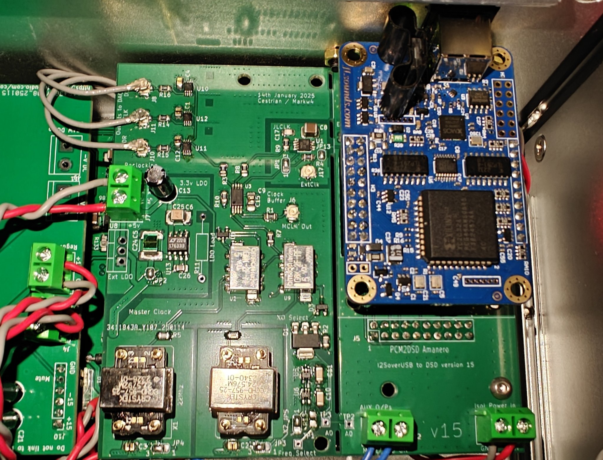

I can now provide the Gerbers and information to build an interface board that supports a compact connection between JLSounds I2SoverUSB vIII FIO and PCM2DSD with support circuitry hosting 2 x XOs, relays to switch in the correct frequency, re-clocking for the DSD signals and a clock doubler to provide ext_clk to the JLSounds if 22/24Mhz XOs are used.
The design relies heavily on that generously provided by Markw4 and was conceived not as an alternative to his design but to complement it where space was limited and requirements weren't as general.
This is the link to Mark's design: https://www.diyaudio.com/community/threads/general-purpose-dac-clock-board.413001/
Below is the re-clocker fitted to one of my two RTZ DACs:
The BOM & Schematic is also attached together with a document with some notes and details of the options.
Please let me know if clarification is required on anything. Or if anyone finds errors in the BOM. I've tried to keep it in step but as you can see there have been a number of iterations so mistakes might creep in.
The v15 board has been tested on 3 RTZ DACs and found to be working well on a number of different sample rates and sources. However, I cannot guarantee that there won't be unforeseen cases where timing issues might arise as I can only test with my limited scope of hardware.

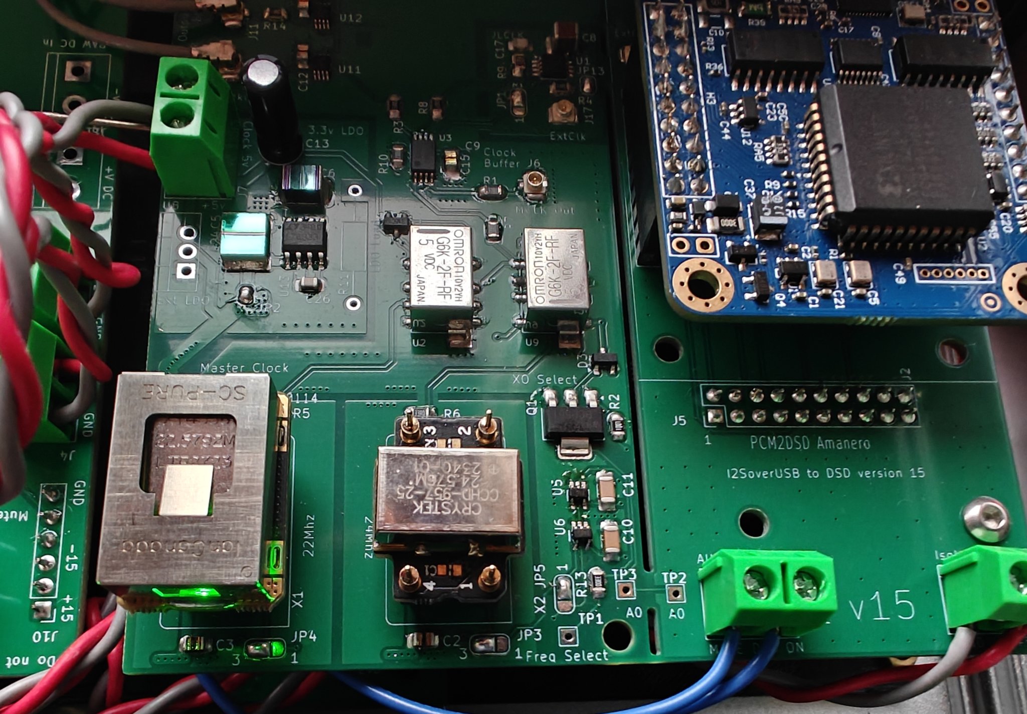

BOM calls for Crystek CCHD-957 devices but since the 4 pin Aries XO sockets are used (part number has been added to the BOM) then any pin compatible XO can be used,, such as the Ian Canada scPure. The Crystek XOs also require a conversion pcb, as seen in my photo above. I bought mine from Ian Canada. The scPure XOs already use the correct format for the sockets.

Hi Leon,Cestrian very kindly sent me one of his SC-Pures to try out in the reclocker board , I’ve had it warming up for 12+ hours . I found the sound to be quite smooth and wide at first, it then seemed to get noticeably deeper with increased reverberation with things like piano.

I've put the Crystek back in and gave it time to warm up,I've got to be honest it's now hard going back to it . The Crystek now reminds me of those early Bitstream CDP's , a sort of artificial flavour added . The SC Pure is better balanced with less digital glare , soundstage and depth better with the SC Pure. It makes it hard doing a blind test because the time required for the XO's to warm up which the SC Pure definitely needs . I have just fitted the NDK's so will see how they are after a warm up.

That seems about right to me. I couldn't willingly go back to less than the SC Pure clocks. Crystek or NDK SDA are just too distorted sounding in comparison. And, without trying to rub it in or anything, you are still at some disadvantage with that output stage. Its making things sound worse than would be ideal. In that regard I have some commercial transformers on order to try out, but they have been out of stock for awhile. I'm thinking of Jensen JT-11P-1. Maybe available to try towards the end of this month.
On the clock issue, the Acko clocks with my squaring board are are still what I use for the highest performance and most detailed sound. The holographic capability and openness puts them in another league above SC Pure. Yet SC Pure are good enough for most purposes; I don't mind going back to them even though something is lost. They don't sound bad. Can't say the same for Crystek.

Thought I would share some feedback from first listen to the SC Pure crystals on the reclocker board. Usual “to my ears” disclaimers apply : - I had the SC Pure XOs on for about 8 hours continuously before I gave in and had to have a listen. Source was 44.1kHz WAV files, HQ Player on the fly DSD256 conversion.
There was a definite and obvious improvement over the Crystek XOs. The first thing I noticed was that the weight and solidity of everything was much better. Bass was certainly weightier, but also tighter. All instruments and voices now have even more space around them. The word “grip” also kept coming to mind. I listen to quite a bit of symphonic power metal (Nightwish) which can get demanding and easily descends into a mush when it gets intense. Not so here. Control over everything was maintained, whatever I threw at it. The extra grip and control also allows everything else to come through with greater clarity. Percussion instruments were also given a wider space to play in, giving more insight into the sound of each instrument and it’s timbre, decay etc.
Everything seems to be more coherent and “hangs” together better and more evenly if that makes sense.
I’m looking forward to seeing how running in of the SC Pures develops over time, but looks like the admittedly pricey gamble has paid off.
