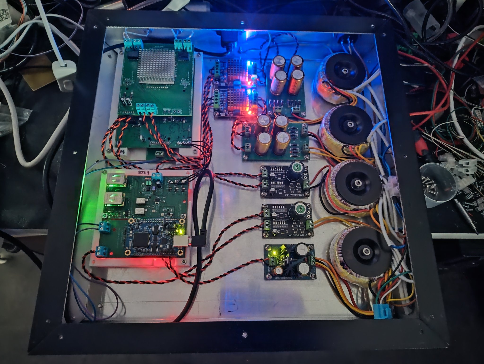

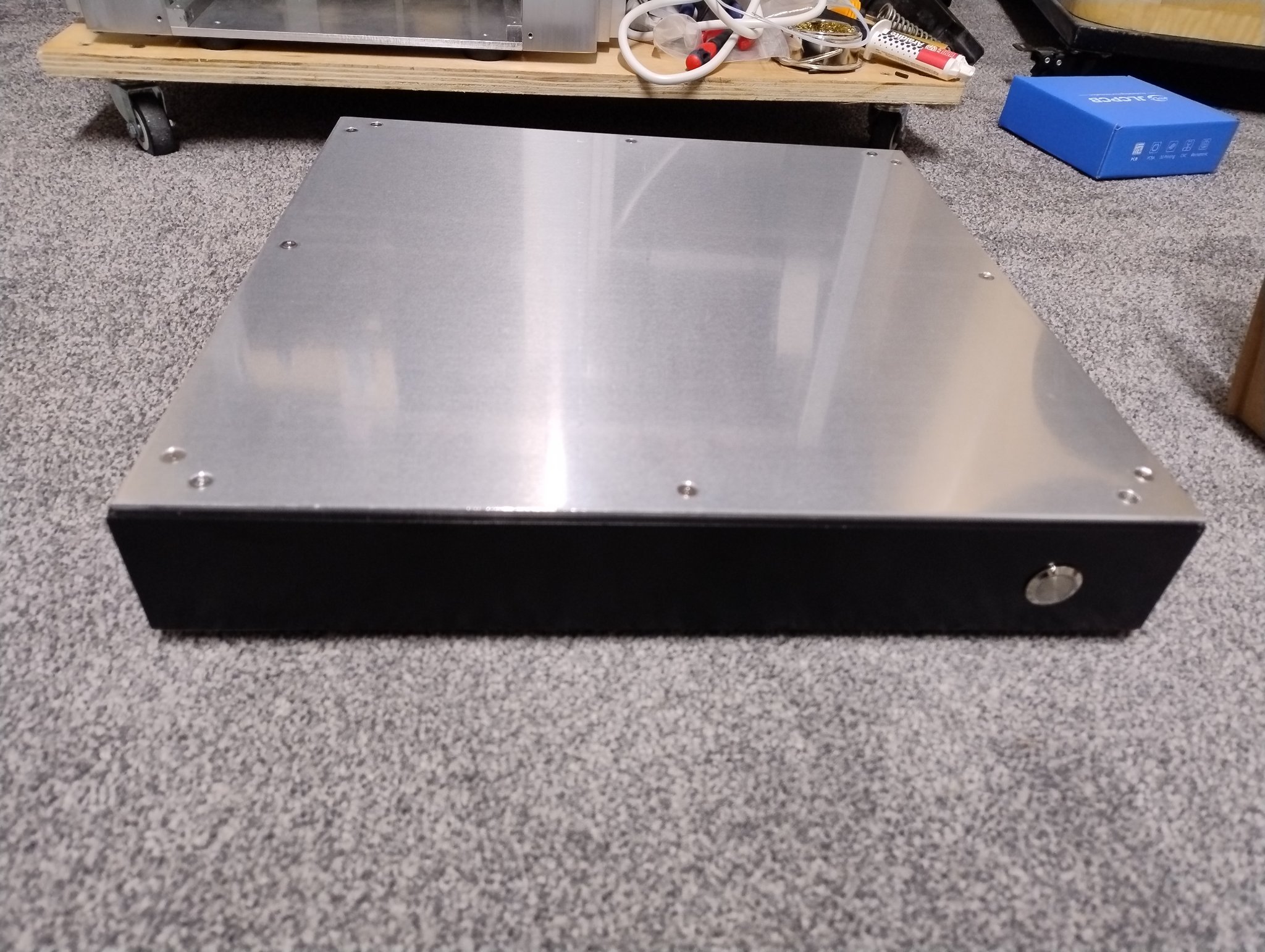

Marcel´s RTZ is the best DAC I have had in my system and in this iteration, the best of the RTZ I have made. I feel it is cleaner sounding now, but it took too long time for me to finish it to make a very thorough comparison. It is not a night and day difference so much can I say.

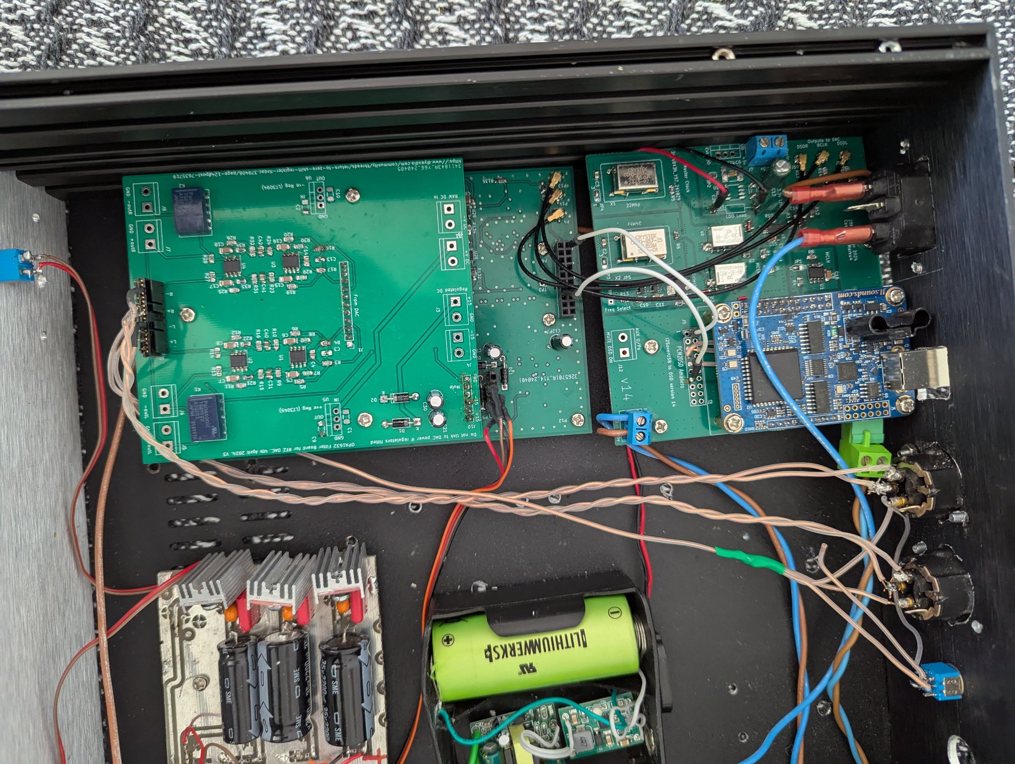

Cestrian very kindly sent me one of his SC-Pures to try out in the reclocker board , I’ve had it warming up for 12+ hours . I found the sound to be quite smooth and wide at first, it then seemed to get noticeably deeper with increased reverberation with things like piano.
I think with the Crysteks the sound is a little more stale with more artefacts , certainly not as expansive soundstage as the SC-Pure and bass doesn’t seem to reach as low .
I need to spend more time with it and then go back to the Crysteks and NDK’s , so far though it’s looking like I may have to purchase one of these at some point . Unfortunately I have no way to test this so can only post what I’m hearing so take it or leave it
I use separate supplies for every stage of the dac
LT1086 feeding Marcel FIRDAC +/-15v
A PH shunt reg feeding Marcel Firdac 5v
Super regs +/-15v feeding discrete output stage using 2A3SET’s passive filter on the input
Separate LT1086’s for the JLsounds I2StoUSB and pre reg for the reclocker

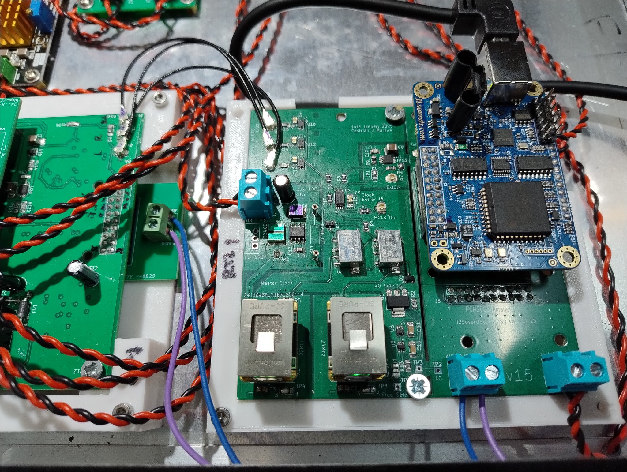

The reason for running I2SoverUSB on 45/49 MHz clocks is to allow high sample rate DSD over DoP. That's for cases like if someone wanted to use HQ Player rather than PCM2DSD, and or if they wanted to use the Clock and Reclocker board with, say, a different DAC board using ASIO for Native DSD512.
Since there is a reclocker anyway, there is no benefit from running I2SoverUSB at lower clock frequencies.
Also, the clock multiplier can be bypassed if desired

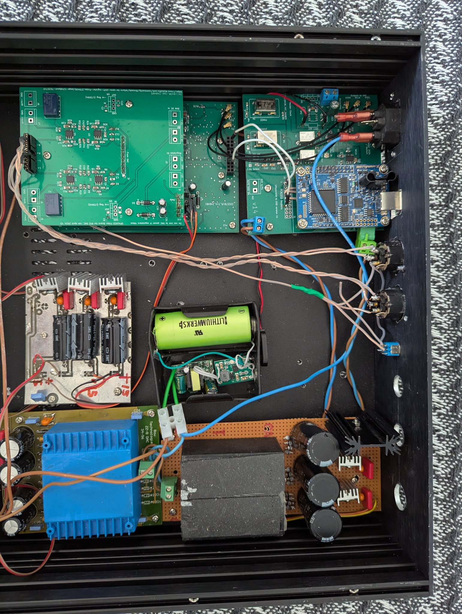

I’ve just taken delivery of some SC Pure crystals. The RTZ DAC with the reclocker board sounded great already with the Crysteks, but I’m going to have to wait for the SC’s to run in for a bit…..
This is the best DAC by far that I have ever had in my system.😀
