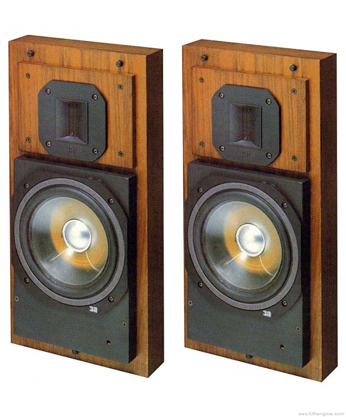

The second model was the 3A ADAGIO, an easy rework of the ARIOSO, with the same midrange, a 30cm woofer from Fostex and an ITT tweeter.
Several versions of this model would follow over the years with many driver configurations, including the latest version in the 1980 catalogue which uses 3A made drivers, favouring the midrange dome instead of the 12cm Siare paper cone. The 3A tweeter claims to reach 30KHz, but I am not sure it could be measured up to that frequency at the time, using the Bruel & Kjaer equipment shown in the catalogue...

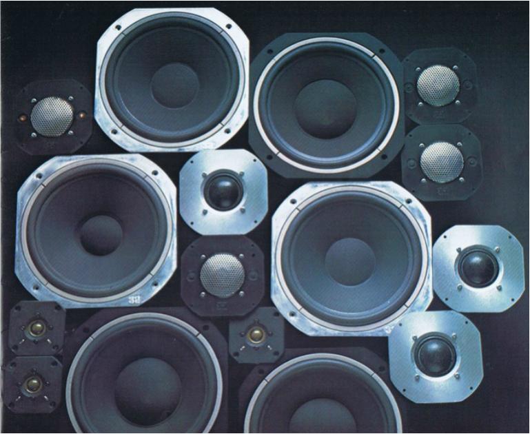

In the late 70s and until the demise of the company in the early 80s, 3A designed and manufactured a series of interesting drivers. 25 and 21cm for the woofers and dome speakers for the midrange and tweeters. Focal bought the moulds for the woofers chassis and it is easy to spot them in the early JM Lab productions as well as many other French speaker designers.
The drivers were manufactured in a dedicated factory in Lussac-lès-Chateau.

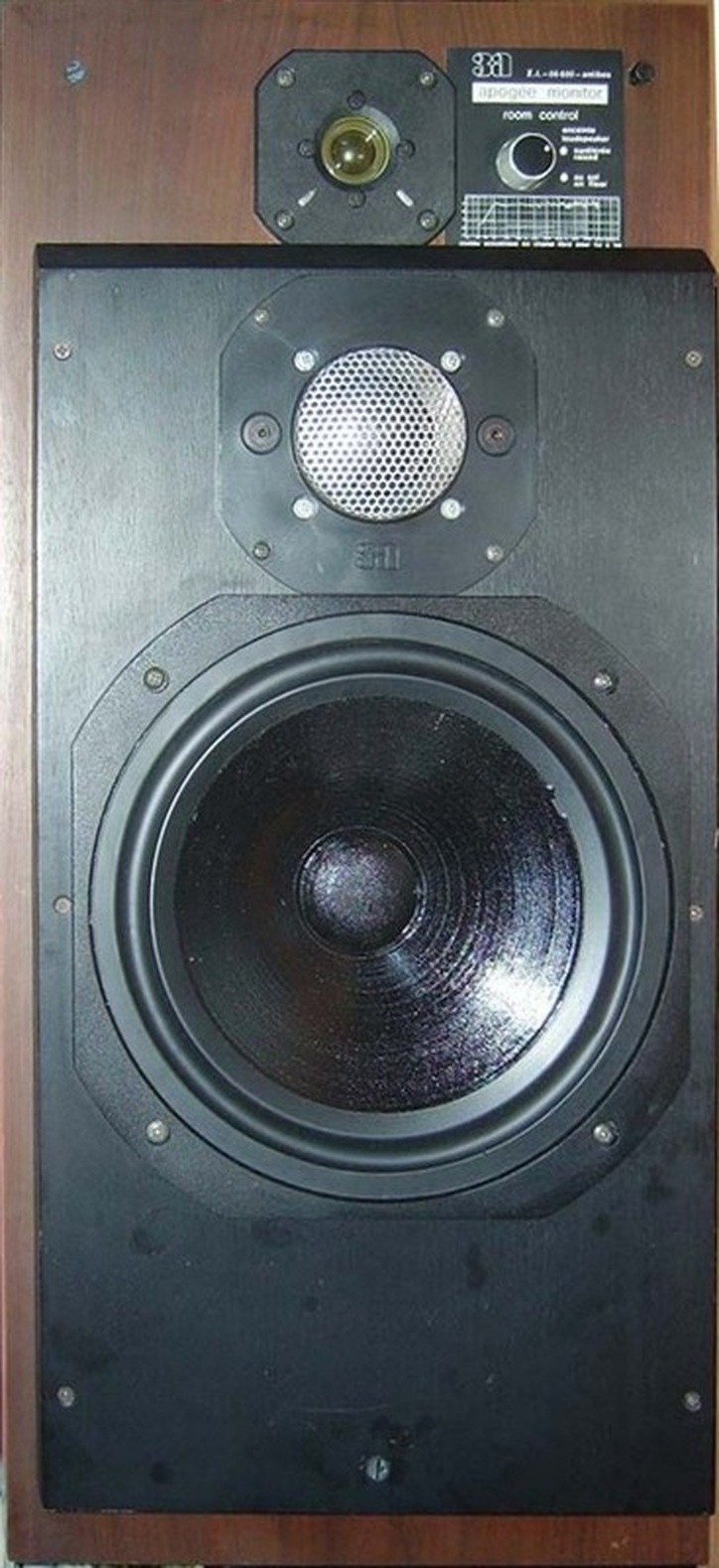

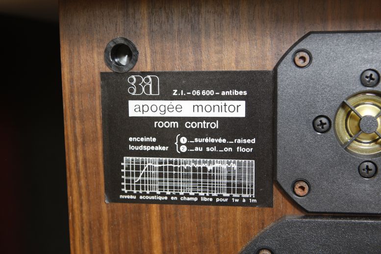

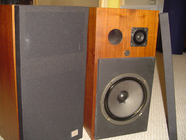

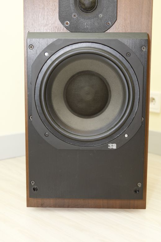

The most popular product made by 3A was the 3A APOGEE, with a 25cm woofer from Fostex and the same ITT tweeter as in previous models. The Apogee became so popular that 3A had three different cabinet makers and had a production line at GUY HF to assemble them and ship them from a central location.
Later Apogee models featured 3A's own drivers. The attached images feature an early version and 2 later models (with the same frame as the JM Lab Electra 920).

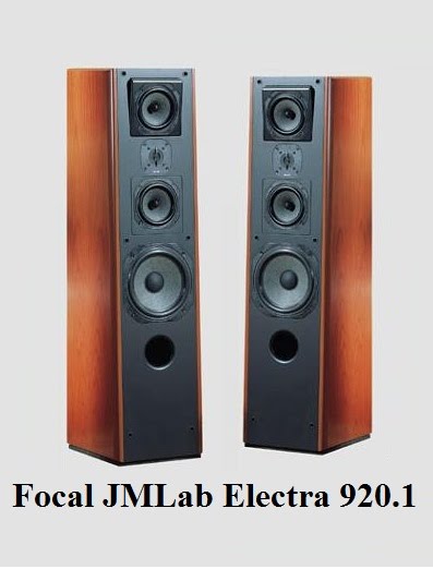

3A closing their doors was big news at the time and coincided with the rise of JM LAB/FOCAL who became in time the largest client of GUY HF and eventually buying the business.
Another factor in the failing of the business was the plethora of models and the incessant redesign of successful speakers with new drivers and various revisions of the same models.

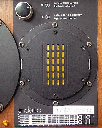

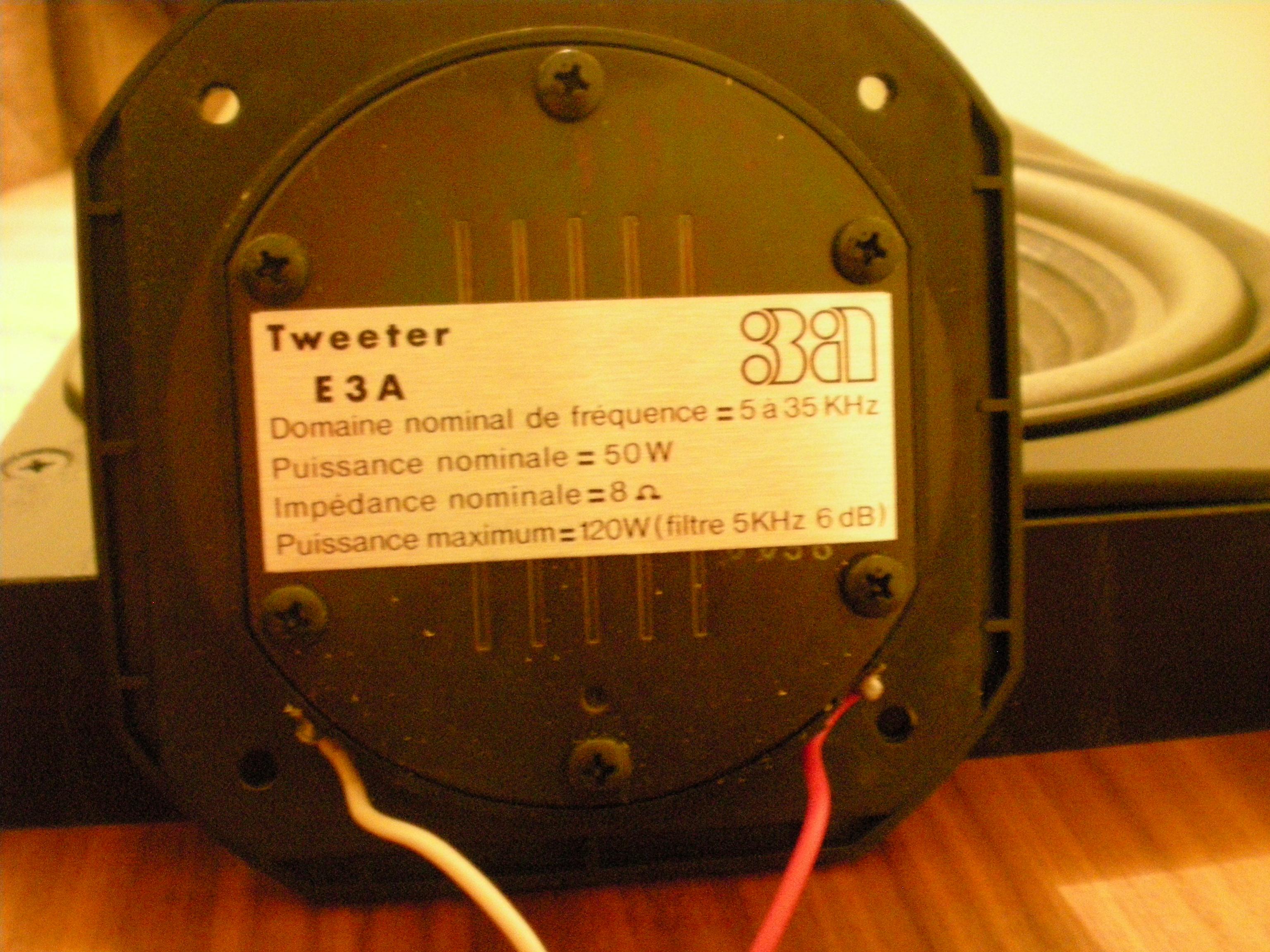

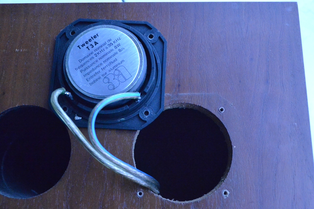

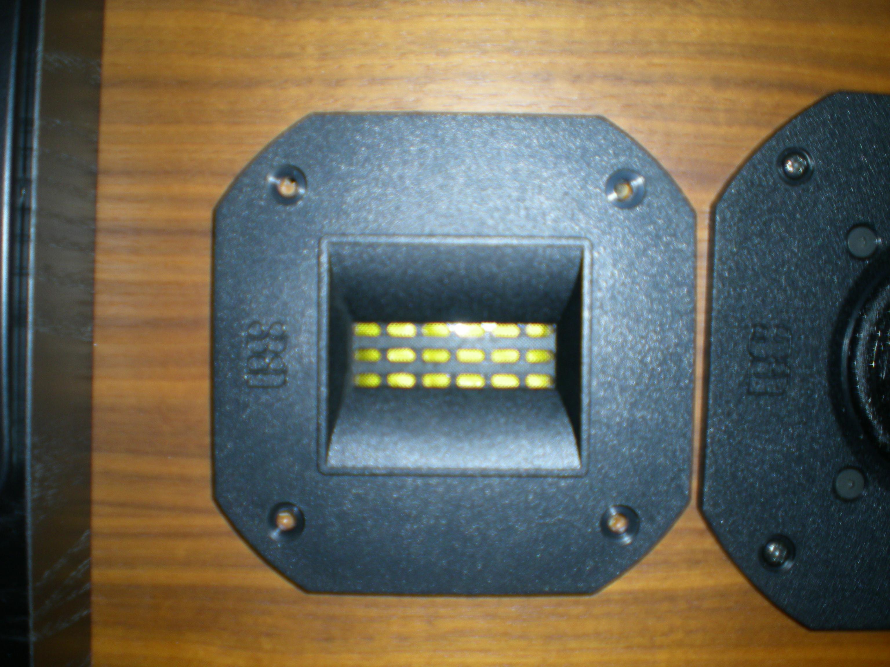

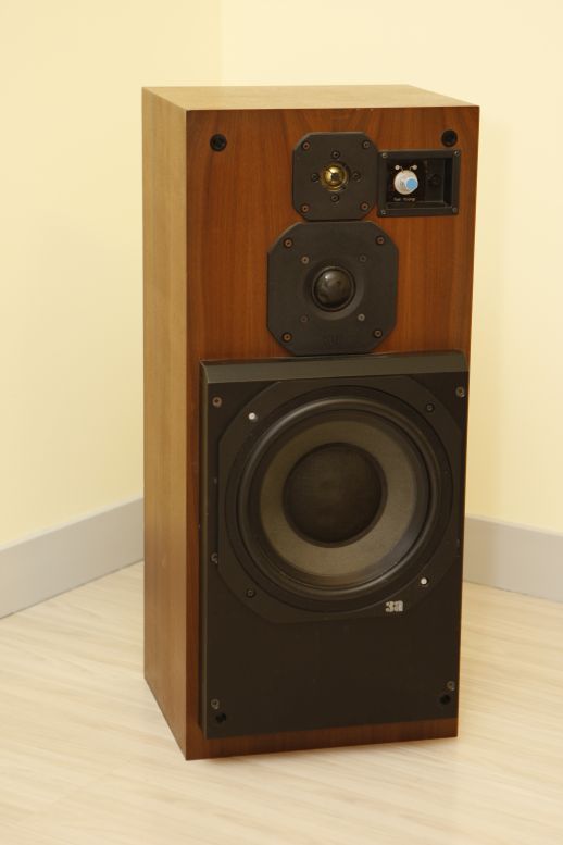

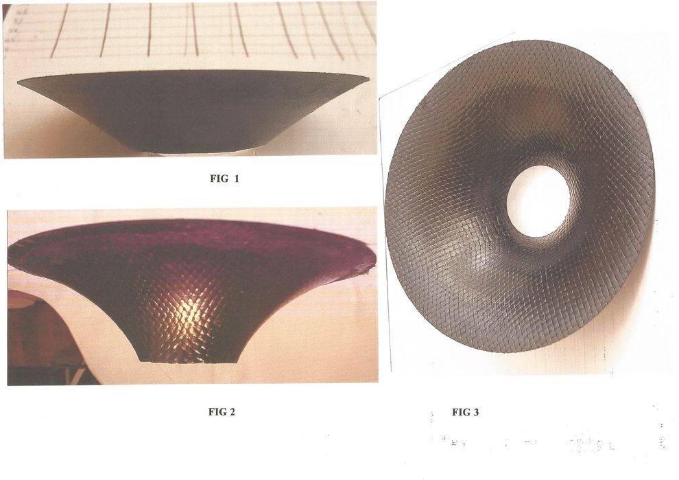

This is the post to catch up with my earlier post in which I attached an image of something that looks surprisingly identical to a waveguide... At least from a distance.
Evidently, It is a hyper-exponential cone, made of pure carbon fiber and developed by Daniel Dehay during the final years of 3A.
After the bankruptcy of 3A, Dehay started 3A Audio Design (1985-1990) and then moved to Switzerland to continue 3A Innovative Acoustic (1990-2000). During these two episodes he decided to shift his focus on a small range of high end loudspeakers based on the 3A Master Series.
Why dedicate a 'chapter' to a specific range of loudspeakers?
Because, in my opinion the (Reference) 3A Master-Series embody a pinnacle of monitor loudspeaker design.
Contrary to many later 3A designs, Dehay apparently had clear objectives in designing the Master Series. His experience and some clever engineering culminated in what I would literally consider his Master Piece.
Sloped baffle, off-center positioning of tweeters, 1st order, high sensitivity compared to similar sized monitor loudspeakers, wide range (40->20kHz) in a compact enclosure. High quality of components and materials.

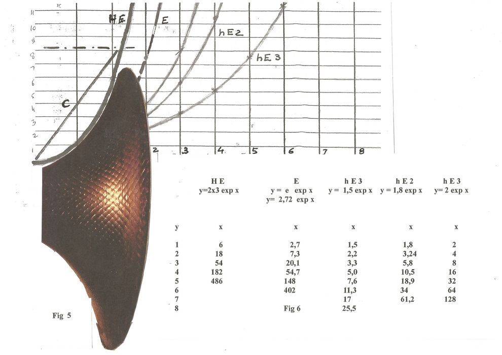

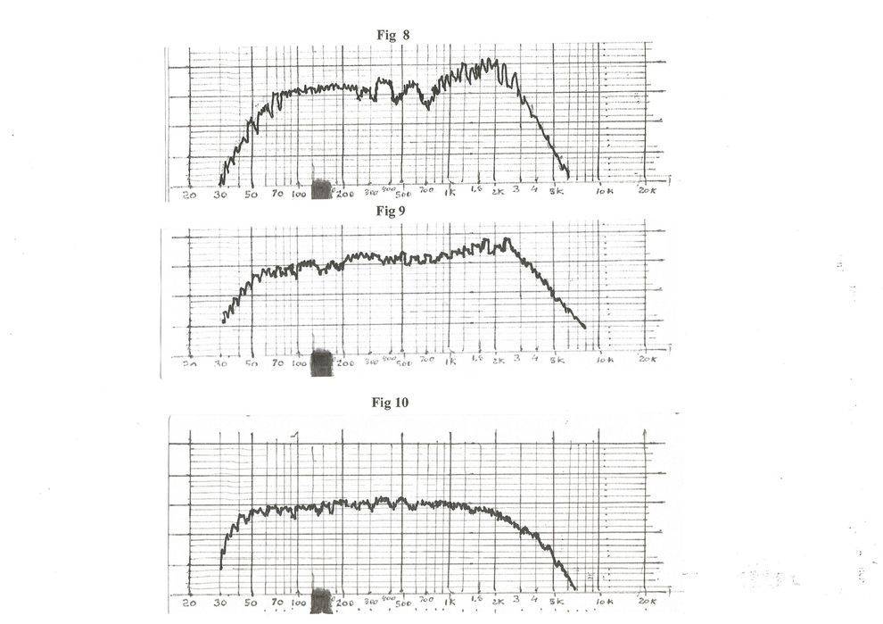

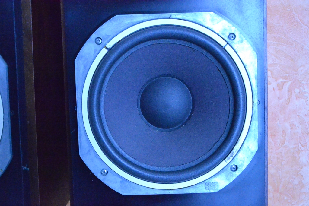

Pièce de résistance of every Master loudspeaker up to today is the |Hyper-Exponential Carbon Fiber Mid Low Woofer.
Development started in 1976...
The research for the Phase Plus induced 3a to find better woofers in order to eliminate the filter and improve phase behaviour with other drivers. During lab tests it became evident that most mid low woofers suffered from undesired resonances, distortion and non linearity causing interference.
As was customary in loudspeaker manufacturing, 3A's (own) woofer cones were made from rigid paper (see Fig. 8).
Efforts to improve these cones made clear the desired performance could not be achieved with the paper cones (available a the time)
At the same time as 2 other french manufacturers: Audax and Siare, Daniel Dehay decided to explore alternative cone materials.
Several materials were tested: aluminium, PVC, Teflon and Kevlar.
Eventually a moulded cone from woven carbon turned out to provide the desired stiffness combined with low mass.
Moreover, the carbon cone is fabricated by 'hot moulding' and therefore leaves a number of choices with regards to cone size and shapes, as well as to the composition of the carbon fiber.

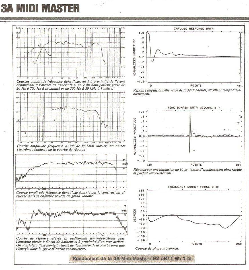

The differences between carbon and paper cones became immediately apparent.
There are hardly any, or no, oscillations between 1000 and 4000Hz. Bare in mind: these tests were done with analog test equipment, like HP spectrum analyzers.
The stiffness of the carbon did pay off, but came with a collateral and undesired rising response above 1000Hz (Fig. 9).
Thus, further studies were done in order to reveal the source of this behaviour. Experiments with dustcaps, phase plugs and additional (secondary) cones showed significant changes in the response behaviour of the cone. This lead to the conclusion that the geometry (shape) of the cone has considerable impact on the response.
First test: cone y = e (exp * x), with power output x = 2,72. This is a (regular) exponential cone (see Fig. 9)
The result is clearly visible; the curve shows a minor resonance which can be easily filtered out. Additional tests between the exponential and regular cone shapes yielded inconclusive results.
Subsequent experiment: hyper exponential cone of type y = 1,5 with output x (see Fig. 10)
An important discovery was made: The behaviour of this cone was near perfect, without oscillations/cone break-up, linear up to 1000Hz and with a smooth roll off thereafter: -3dB at 2000Hz, -6dB at 4000 Hz.
Explanatory notes
Explanatory notes
Fig. 1
Regular conical shaped cone of PVC (polyvinyl chloride)
Fig. 2 & 3
3a Hyper Exponential Carbon Cone
Fig. 4
Different Cone geometries (shapes): Conical (C),
Exponential (E), Hyper Exponential (HE), hypo Exponential (hE)
Fig. 5 & 6
Cross-section view of the 3A Carbon Fiber Cone (HE y=2x3 exp x)
Exponential Cone (E) and three hypo Exponential Cone geometries.
Fig. 8, 9 & 10
Comparison of response curves form an Exponential Paper
Cone(8), Exponential Carbon Fiber Cone (9) and a Hyper
Exponential Carbon Fiber Cone (10)

In 1981 the first range of Master Series loudspeakers were launched, starting with a small M(idi)M(aster) to bigger multi ways.
The MM has become the classic of the range and this tiny monitor certainly lived up to the expectations. This quote from Ultra High Fidelity Magazine is illustrative:
"We first heard this model's ancestor, the 3a MM, in 1989 at CES in Las Vegas, where French designer Daniel Dehay was drawing (and keeping) large crowds with his new line of speakers. We would eventually adopt one of them, the MS5, for our Alpha reference system, but it was the MM that triggered the incredulous stares. One skeptical visitor accused Dehay of having hidden a subwoofer among the speakers. Without a word, Dehay picked up one of the MM's, still playing, and dropped it onto the visitor's lap.
It wasn't just the MM's explosive dynamics that retained attention either. The price was astonishing, at a mere C$1200 (US$1100). Naturally, the importer sold as many speakers as could be made, and Dehay had to pick up an investor so he could expand. But the bean counters took over, and moved production to Spain, to be done by workers who seemed to believe wires were made in two colors for purely decorative reasons. The company soon collapsed.
Dehay eventually turned up in Switzerland, where he set up Reference 3a. He had long complained that his distributors concentrated on selling his low-cost speakers because that was easier. He found a solution: he would make only high end speakers. His new line began at a pricey C$6500, soaring to more than C$16,000. The latter price was for the Suprema, the speaker we wound up adding to our new Omega reference system."
