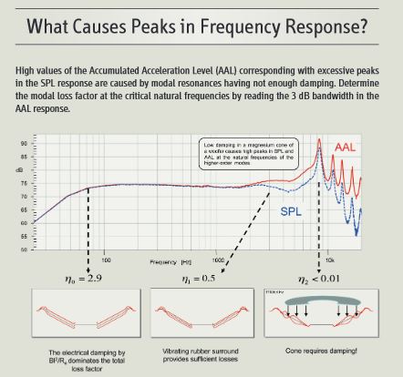

IMO, there are always problems with splitting the range up in a two-way. The drivers are slightly outside their comfort zone. Dispersion has a hole. Above and below axis has a hole with even-order LR2 and LR4 crossovers. You can hear it.

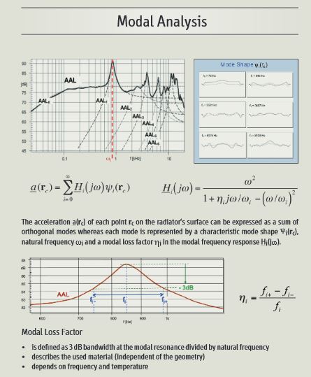

I include some Klippel analysis of cone breakup, 1st and 2nd below. These are underdamped small metal cones, but show us what we are up against. The 1khz problem is actually the rubbery cone surround.
IMO, a three-way is always going to work better. The mid is spared bass excursion so distorts less, the tweeter is spared working below its comfort zone. Steen Duelund's mathematical analysis 3rd.
