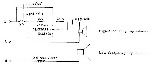

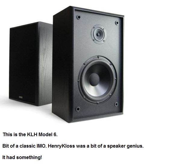

Here's the KLH Model 6 with the simple filter in attachments:
This model was introduced in 1958 and designed by Henry Kloss. The bass is a big and tidy 8-10" paper unit using Acoustic Suspension for the bass loading, which really means closed box, floppy surround and high mass cone.

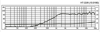

A modern equivalent:
HT-22/8

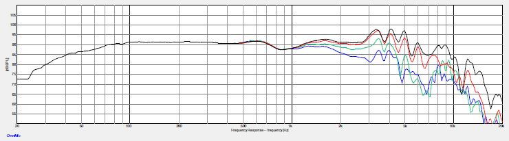

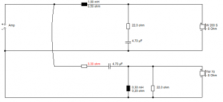

Here's my take on the concept. I've used a bass filter that really does very little beyond slightly damping the voicecoil in the mids, very little bafflestep so they place close to the wall. I used a second order tweeter because it models nicely. The FR of the Monacor will be slightly better than the TW70 I did the modelling with.
Interestingly, if I use a dome tweeter, I get driven to a steeper 2nd order bass and a third order tweeter like the old KEF designs. But I am very pleased with these. They really do sound VERY nice. They have solid bass and a very musical sound which just gets you into the music. In fact it is weird, but I'd swear the music plays slower through these. 🙂

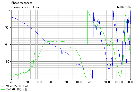

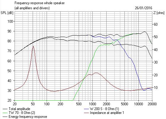

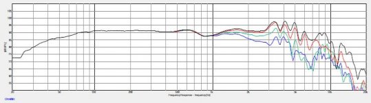

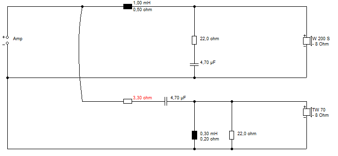

Hi System 7. I' m very interested to closed box.
What is your definitive crossover for w200s-8 + tw70?

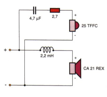

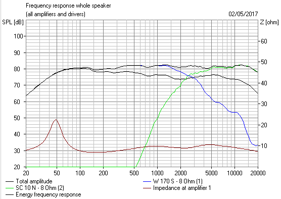

Let's start with a couple of classic designs in this 8" style. Mr. Joachim Gerhard's (and we love Joachim) Sonics Arkadia 2400 Euro speaker:
I would think these are the drivers;
H1288-08 CA22RNX
H1189-06 27TDFC

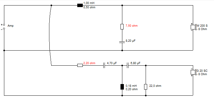

Joachim is using a simple and lowish second order 1.5-2 kHz crossover there IMO. That's OK with a really good tweeter. I didn't consider it an option with a cone tweeter, but I could be wrong.

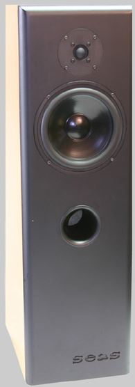

There's another way to do this sort of thing as in the SEAS Njord design which is simpler and rougher. Below.
TBH, it's all a trade off. I use lots of woofers with the circuit below. The SEAS is 1mH Le and 6 R DC, so you'd get away with a smallish 3.3R in the bass shunt IMO. The Visaton W200S is a massive 2.2mH Le, comes with bafflestep built in. So needs 7.5R to avoid a peak at crossover.
The third order is definitely the least distorted and smoothest with less bass cone breakup around 5-7kHz. But I'm still enjoying Marco-Gea's shallower second order style. It's very dynamic. 🙂

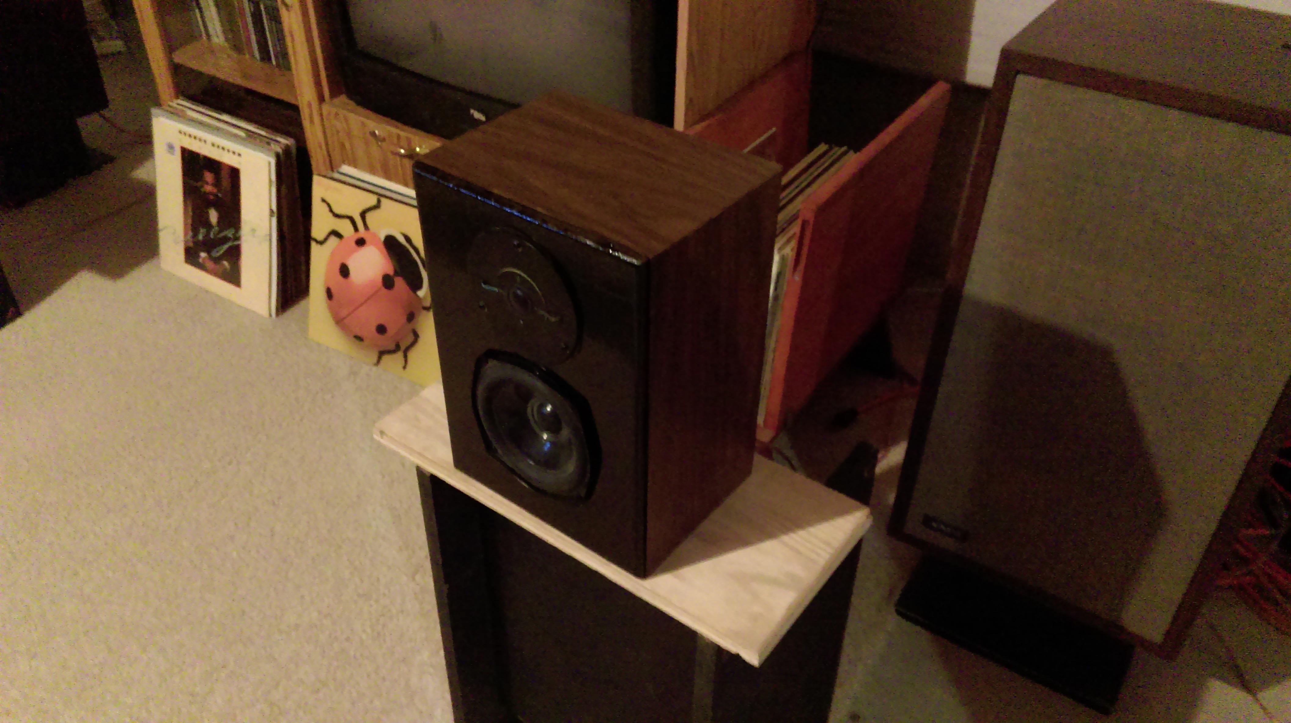

I don't know what that thing in the picture is, but it's certainly not Henry Kloss' KLH6 from 1958.
Here's a real KLH6:
They are Cambridge Sound Works Model 6s from not that long ago.
Apparently somehow linked close enough to Henry Kloss to use his name.
They retailed for $149 when new.

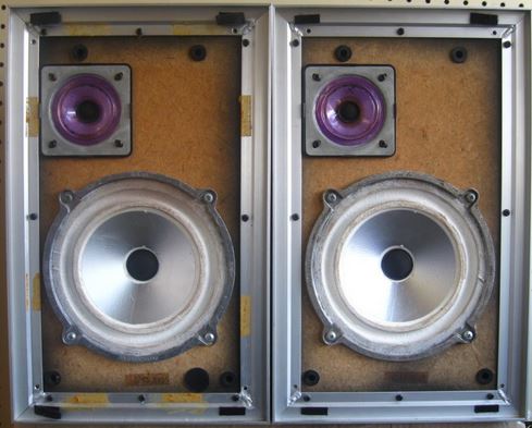

Looks like the old Wharfedale plastic mid/tweeter. 🙂

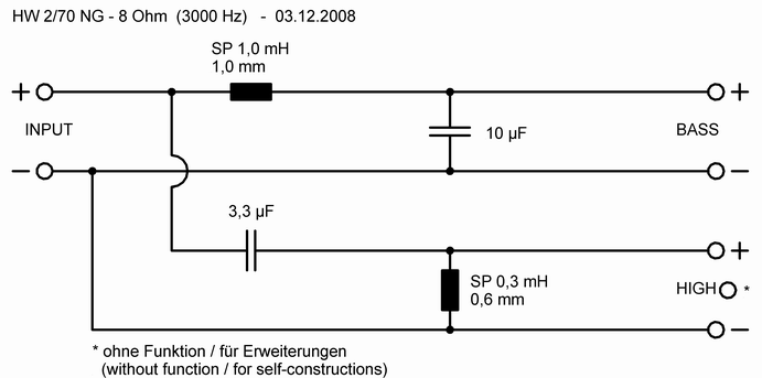

I do find they (cone tweeters) sound better with a second order filter. Improves power handling for one thing. Even something as simple as this 3kHz crossover might be worth trying with a bit of attenuation, say 22R across the tweeter and a series resistor in front. Close to the wall.
HW 2/70 NG - 8 Ohm

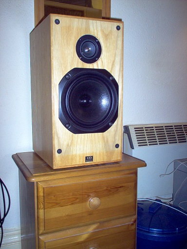

In order to to revitalise this very interesting and useful thread, I would like to add another classic from the UK.
Overall, I am not completely sold on BBC monitor derivatives due to their limitations, but it is impossible to ignore their (often) outstanding capabilities in the midrange.
I have no experience with the original (and 'ultimate') Mission 770's, but I have owned and/or listened to many of their later models that share their 'intimate musicality'. People who don't require high listening levels for complex music could be perfectly happy with these.

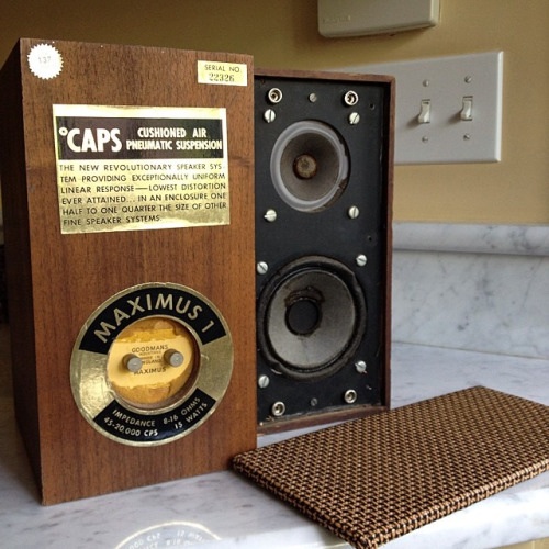

Godfather of the mini monitors?
The Goodmans Maximus from the mid 1960s. I have never heard these, but they are supposed to be excellent performers. Component wise they are truly high end compared to most loudspeakers available back in the day.
And a few more pictures:
Noticable are the steel baffle and that huge Alnico magnet.
Goodmans certainly knew how to make proper woofers and many have become classics and sought after.

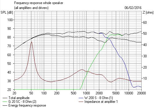

I look for a flat impedance these days. We found one in the classic two way BBC monitor the Rogers LS5/9.
It looks a bit like this:
Not bad, eh. One of the secrets, I suspect. You can calculate these things here:
mh-audio.nl - Home
3-4dB of passive bafflestep and impedance correction of the bass Le inductance. Sounds good by all accounts.

This is a monacor HT22/8. Very musical, if limited on dispersion at the 10kHz end, which might be curable with a supertweeter. I'm on it! 😀
And the tiny Goodmans Maxim uses those old cone tweeters I so enjoy. Best with a third or 4th order filter around 3kHz, IMO, because they do fight you a bit, but you can do a lower second order too if you can tolerate a bit of distortion in favour of musicality.
