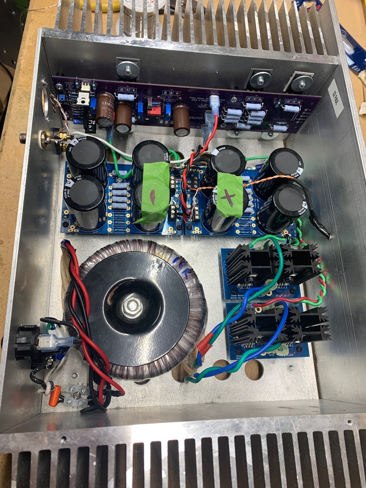

Recently I rebuilt a pair of Rawson Aleph 5 monoblocks and the sound took me right back to the Aleph 3 I bought 15 or so years ago. That was my first Pass amp, and it was glorious. Since I fired those A5’s up I knew I needed to make a classic Aleph amp. Every day after shipping the A5's to their owner I craved that Aleph sound. Thinking back – why did I sell that Aleph 3? It’s the one that got away. It’s why I’m on this forum. As always, Blame Pa, right? And a big THANK YOU to Pa for the green light on this!
Right after the A5’s I was working on the layout for Aleph 2 front end boards and MOSFET Daughter boards. I also got to talking with Jim "6L6" about the classic Aleph circuit. We discussed the concept of a single board Aleph with some options… Some brainstorming brought this concept forward:

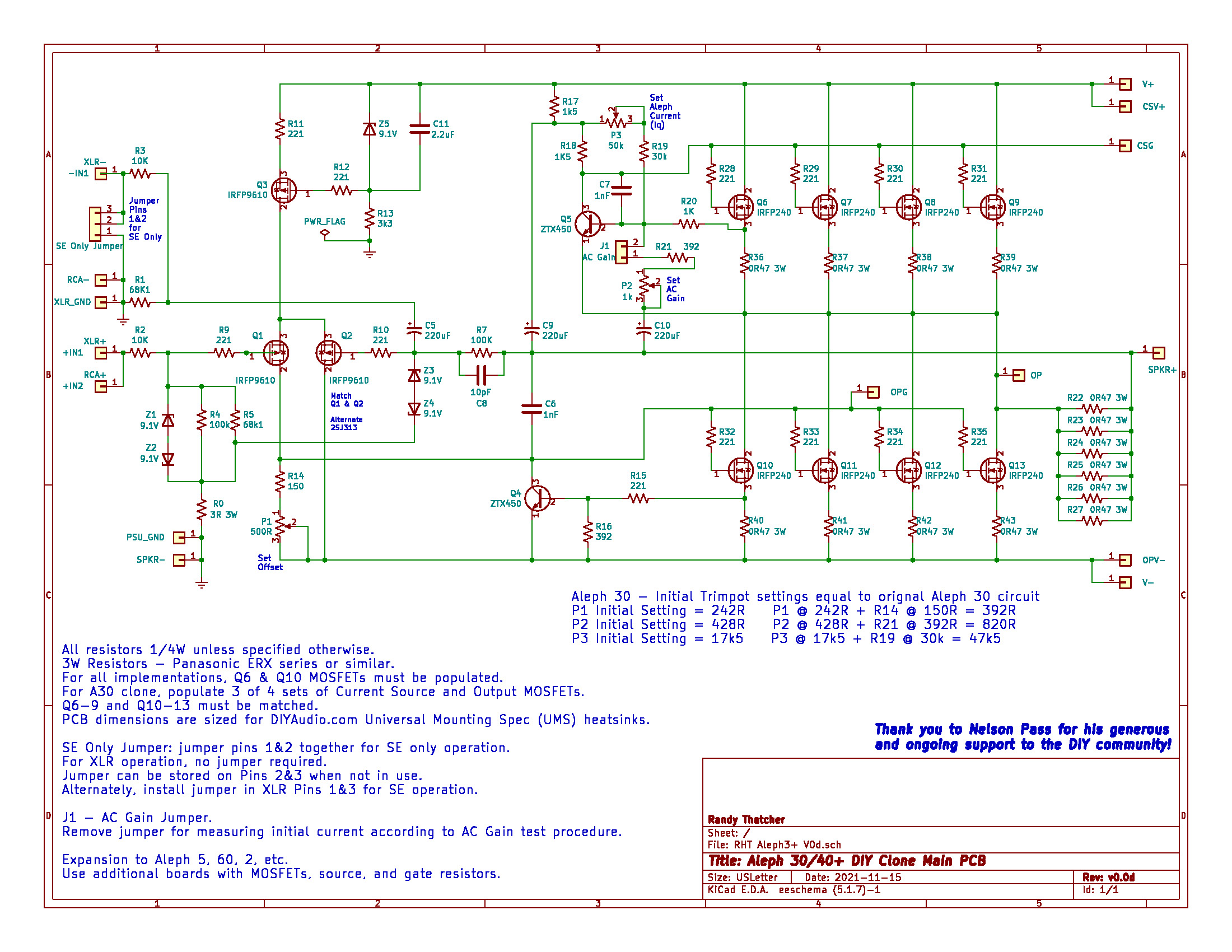

I started with the Aleph 30 schematic and added some updates based on DIYAudio threads over the years:

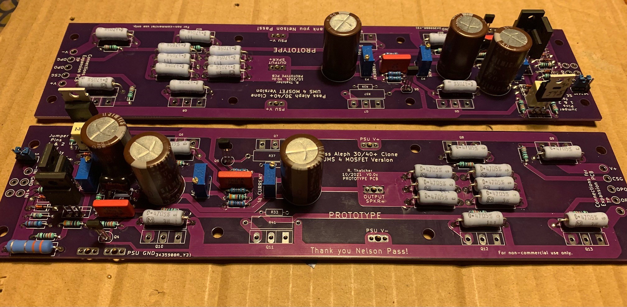

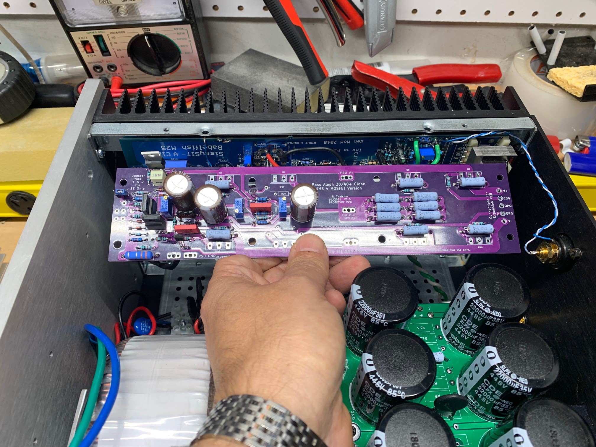

I built a prototype pair of Aleph 30 monoblocks last weekend for testing, using the 2SJ313's in the front end. The amps sound fantastic, as expected. Very authoritative lows with beautiful mids and highs. These went into a pair of monos that I rebuilt a few years ago. They had 20V donuts, not 18V – close enough.

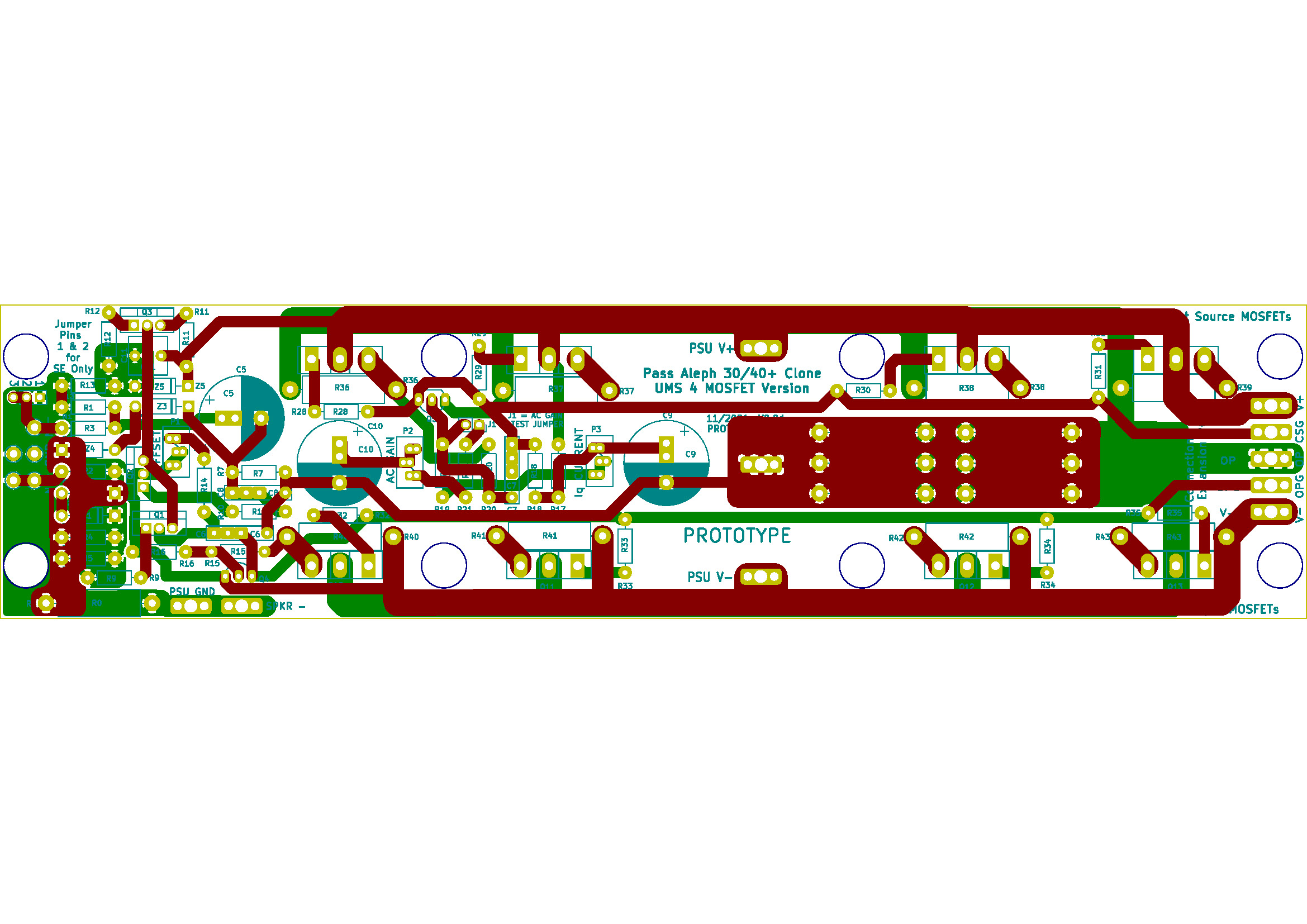

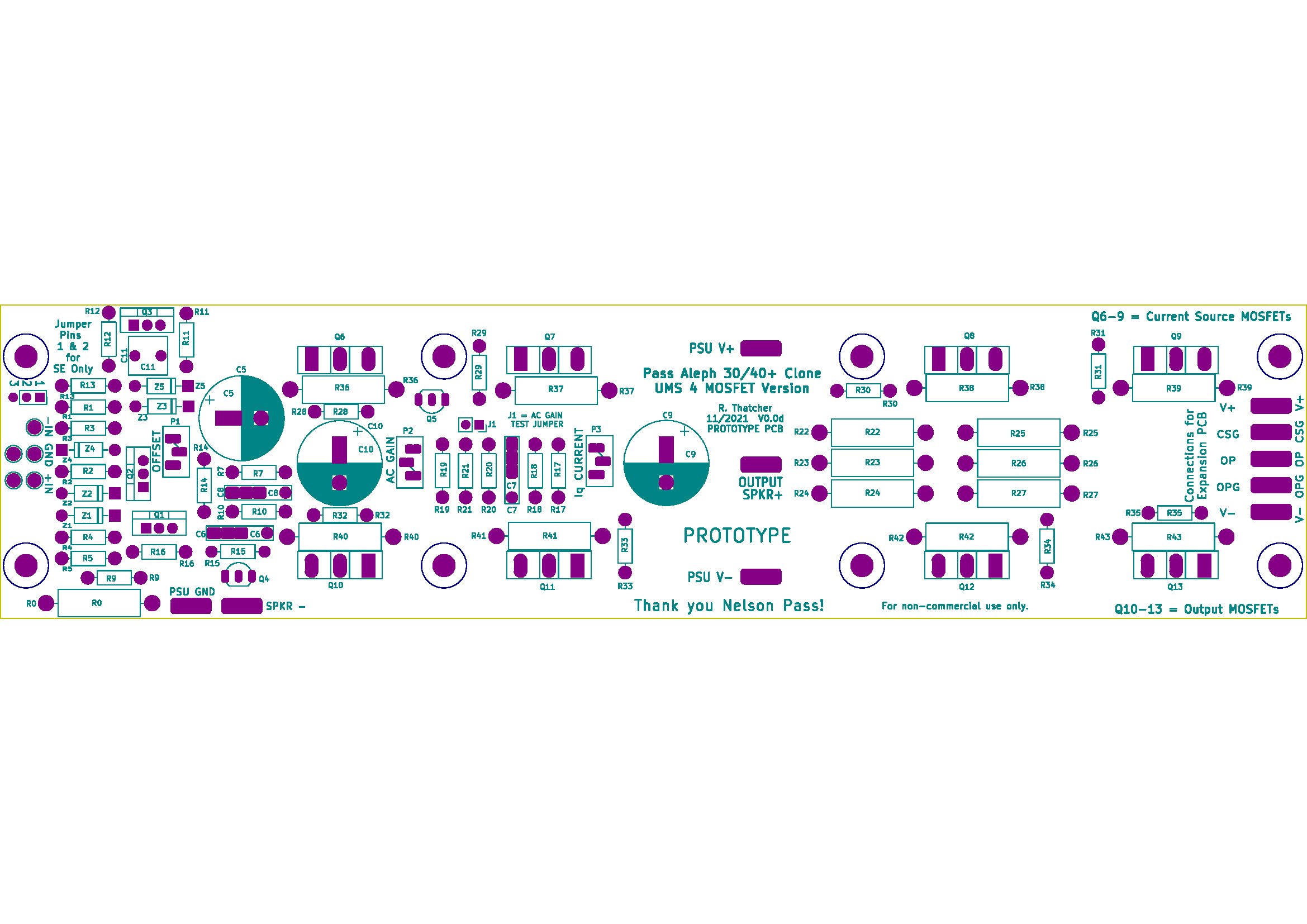

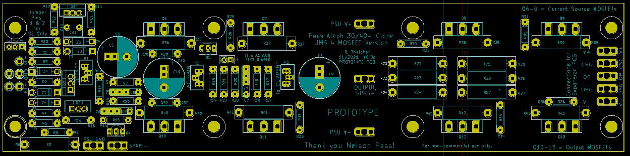

During the build, I noted changes that would make the next rev more user-friendly. Most changes were to pads and details on the silkscreen. Those changes are done in a new revision. The built boards are my V0.0c Prototypes. The render of V0.0d will become V1.0a
Highlights of the changes on the new revision include:
C5, C9, C10 (220uF) updated footprints with 5.0 and 7.5mm LS pads
Updated C6, C7, C8 footprints for 5.0, 7.5, 10mm LS pads.
Updated silkscreens details on PCB: V+, V- , Output/Current Source, etc
Add AC Gain Test Jumper
Changed ZTX450 footprints - spaced out and larger pads
Updated trimpot footprints for triangle / straight line pins
Updated pads on most component footprints to be larger
Added part designators / IDs on silkscreen so they can be seen when parts are populated
Moved power MOSFET positions with respect to UMS - moved inboard.
Updated daughter board connections
- Aleph Reloaded: 2SJ313 optional / updated R13 https://www.diyaudio.com/forums/pass-labs/267857-aleph-design-reloaded.html
- Bypass cap by zener Z5
- Added some trimpots for tweaking, added a jumper for AC Gain test (newest PCB rev)
- Added SE Only jumper by inputs – a tip of the hat to CSample on his F1 boards for that idea.
- Added an additional pair of MOSFETs on the base PCB

Couple quick questions:
For the ztx450, can the silkscreen also include the "CBE" pin designation (like in the store Aleph J board)?
Have you considered adding Allen Newby's clipping mod?

Are the transformer requirements similar to the other builds? Looks like it should be. I have a 20v x 2, 400va donut in the closet catching dust. I may be down for the group buy

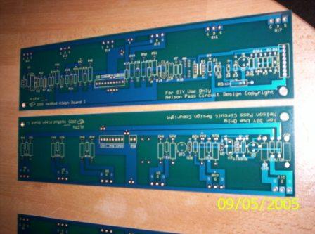

Brings back memories 17 some years ago of the HotRod Aleph. It's still here somewhere if you do a search. I still have the only stereo set of boards I had made and I plan to build it in retirement
Aleph Clipping Mod
CBE - done.
Clipping Mod - I can't see the pix on that thread. Does anyone have schematics?
That should be perfect for an Aleph 3/30 build!
I haven't seen that one. Google got me here, and I love it!
https://www.diyaudio.com/forums/pass-labs/51924-aleph-3turbo-hotrodding-a3-3.html#post596909

Nope. All parts are readily available (assuming you don't use 2sj313 for the input stage)

https://www.diyaudio.com/forums/pass-labs/45798-aleph-family-circuit-board.html#post512858
https://www.diyaudio.com/forums/pass-labs/48303-hotrod-aleph-circuit-board.html#post538915
The HotRod Aleph Circuit Board
Assuming I was, do they need to be matched?
It certainly helps, you've got the offset trimpot there, so maybe not as critical. I'm in for some boards, the world needs more Alephs!
