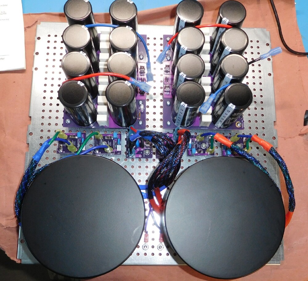

Transformers are mounted after pairing the primary and secondary wires in techflex and heat shrink.

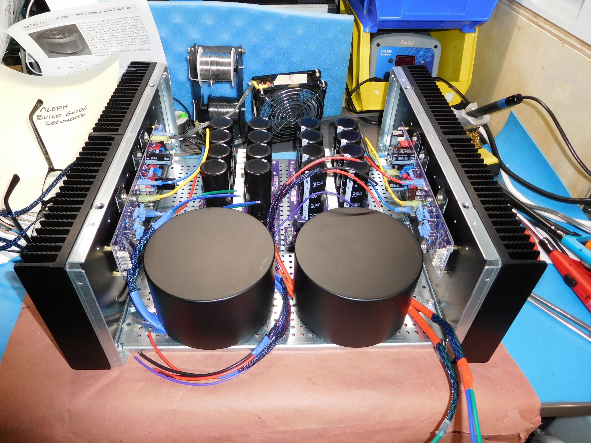

This thing is gettin' heavy! I might make a strut brace for the top to keep it from bending as I do more assembly.

How would using a 400va with 2x20VA secondaries for each Aleph 60 monoblock or would more power or higher rail voltage be better?

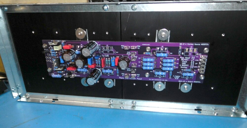

I can't quite tell which end will be the front and which will be the back. Since you're forced to have 4 MOSFETs on one half-heatsink and 2 MOSFETs on the other half, I'd orient the front panel to be on the side of the amp closest to the 4 MOSFET banks. This helps use the thick front panel as a heat spreader.

400VA 2x20 is good for an Aleph 30+ Few watts over 30... How many, I haven't tested. But 2x20 won't get you an Aleph 60.
From the Aleph 60 build guide:
Per Monoblock: Recommend 300VA Transformer (example: Antek AS-3225) Note: 25+25 Antek resulted in 31.5V rails in recent build.
To get 34 or 35V rails a transformer >25+25V will be required.
If using 26, 27, 28V secondaries, increase PSU capacitors from 35V rating to 50V Rating

Thank you,@ranshadow. Randy caught that and let me know last night. I had just looked at the 40W version with all 8 outputs installed, and in the back of my mind thought it would be odd to have 4 devices on one heat sink and 2 on another, but it didn't force its way through to actually moving one over. That's what I'll do today, so each heat sink on each channel will have devices. Also, the transformers are in front, the PS at the rear in my build. Thank you, both!
Also, as I've done with other amp projects, my plan is to attach the transformer shield wires to each respective PS filter board ground - does that sound right here?
I've always sent my transformer shield leads directly to the chassis ground. Never had any issues with hum.
Antek purple wire (shield ground) - just attach an "eye" connection to each and bolt to the swiss cheese chassis floor.
That is what I planned, with each bolt near the PS ground, rather than right at the transformer. Thanks!
Little time to work on the amp today, but got the outputs redistributed, transformer wires terminated and installed.
Almost there Greg. But you need "3 up, 3 down". Now I see "2 up, 4 down". Move Q13 up to 9 and you're good to go.
Purple wire location is perfect.

Oh jeez. 😳
(Self: "Dork")
Knew I shouldn't have tried to fit this in today - not focused enough!
Thank you, Randy.
(Self: "Dork")
Thank you, Randy.
