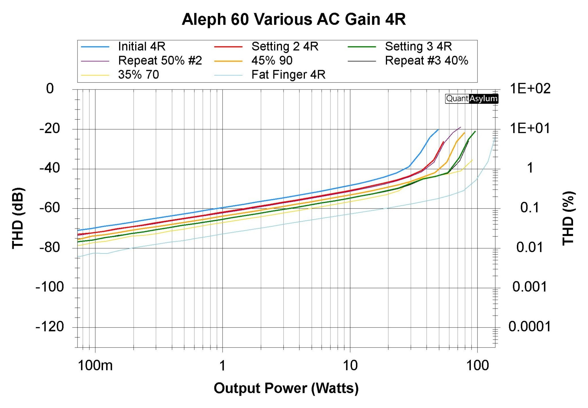

Here's a quick summary ...
I likely missed inputting 8R for the 'purple' in #953. That seems most likely. I told the computer it was a 4R measurement, when in-fact, it was likely an 8R load. I was in a rush. My apologies.
I was not able to replicate a that beautifully sloped graph showing 100W at 1% with 4R load. However, when I intentionally fat finger the result, you can see that shows the increase in power output. See the graph below with the appropriately labeled trace.
That's not to say that the 'current gain' doesn't affect power output at 4R. You can do some really, really, really funky things with it. With that said... in order to reduce (hopefully) confusion, here's a simple graph showing a few replicates done quite some time apart to help ensure repeatability and lack of fat fingers affecting posted results.
I'd love to see others' results and even better would be a test of a factory Aleph 60. If someone wants to send me one to test... 🙂
Also, here is a summary of various ways someone might run some math for calculating the setting. First is the way described in Randy's guide. The % is for illustration only, it is not meant to imply % current gain. It's just the % of the initial value.
This shows the contribution from each set of devices to the total. Jumper on.
What I'd encourage is that if anyone doesn't have a way to check distortion that they simply do it exactly as Randy described in the manual and leave it alone. If you do have a way to measure ... you can have some serious fun, and create some really funky results / performance. You might even be able to eke out a tiny bit "better" performance... at least on paper. The critical thing is to run the checks at outputs and loads that matter TO YOU. I have little concern for anything past about 10W, and I'm going to adjust my build to suit my tastes/needs/desire for a tad less heat. This was just for fun.
The "Initial" Value below is noted in the first chart along with the rest of the measurements. As soon as you progress past 45% into the 40% area, you start to see a "knee". As you progress further, it gets progressively more pronounced. As you bring the things into the 0% (as measured by the way I indicated) range and beyond, things start to get seriously funkadelic.
tl;dr - Randy has provided a wonderful way to find a great setting without much risk. Twiddle further at your own risk for your own reasons.

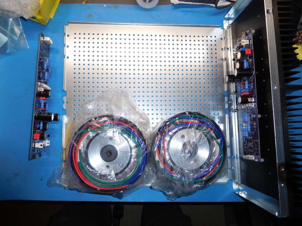

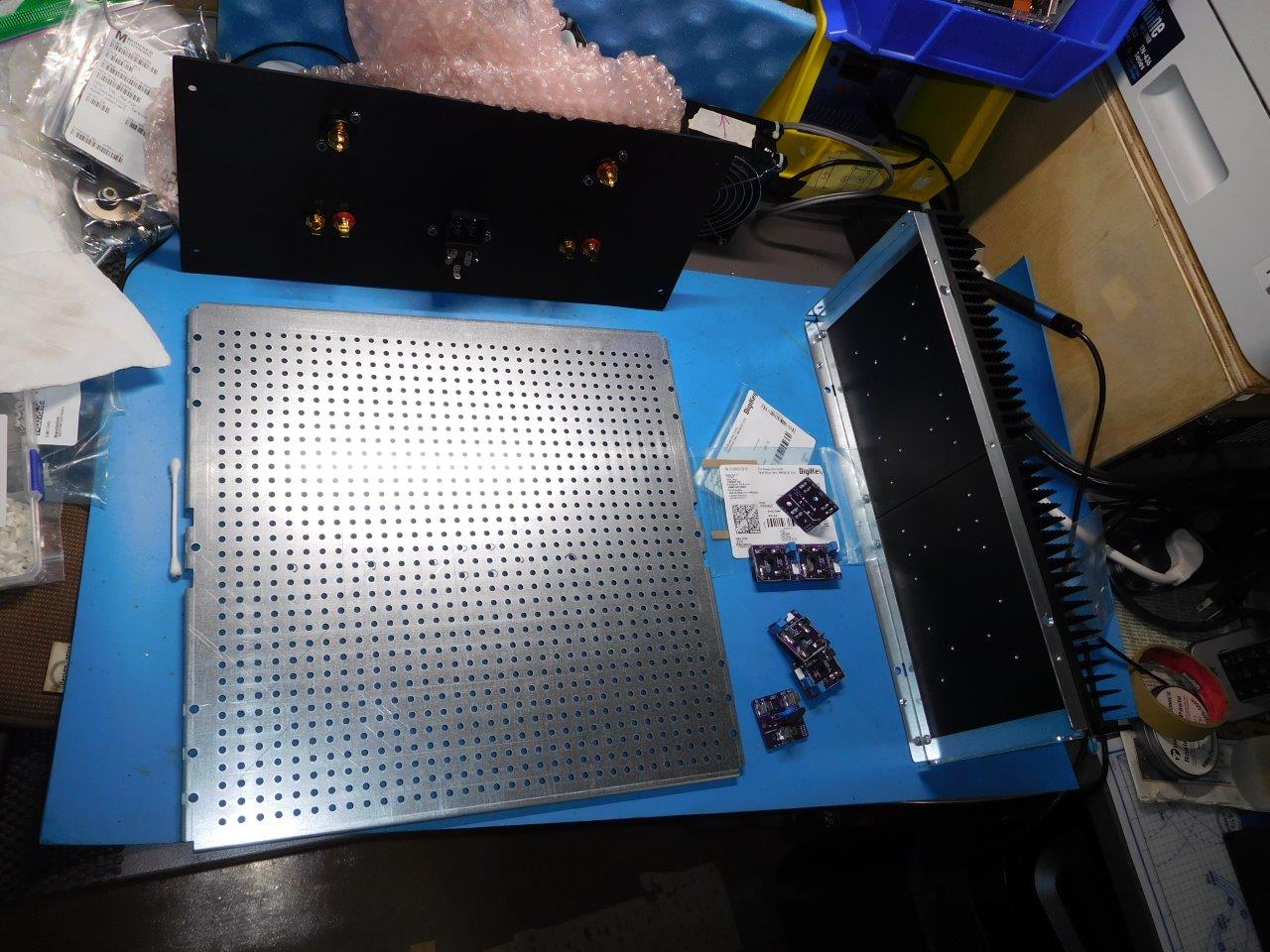

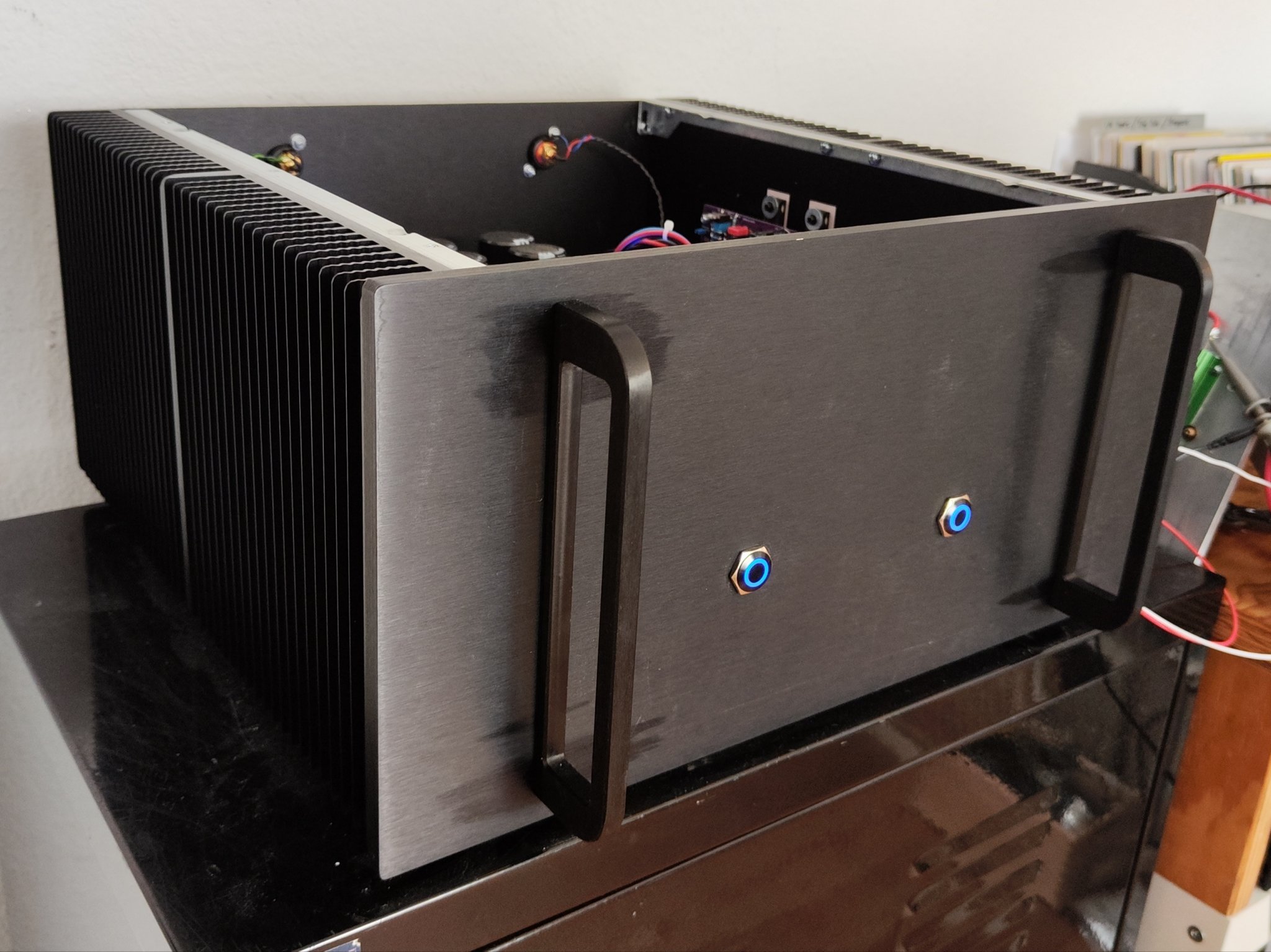

Well, better a little late to the party than miss it altogether. After getting lots of good input and suggestions from Randy and Jim (6L6) (THANKS, GUYS!), I bought boards and semis from Randy, a 4U/400 UMS chassis from Gianluca, parts for the boards, and Antek AS-3220 transformers for a dual mono, single-chassis Aleph 30.
Progress is being made in fits and starts - too many other projects and responsibilities getting in the way of hobbies, but after having to do a little extra work to get a mis-drilled heat sink to line up properly and completing the mockup, I'm about ready to start bolting up and wiring up the modules.

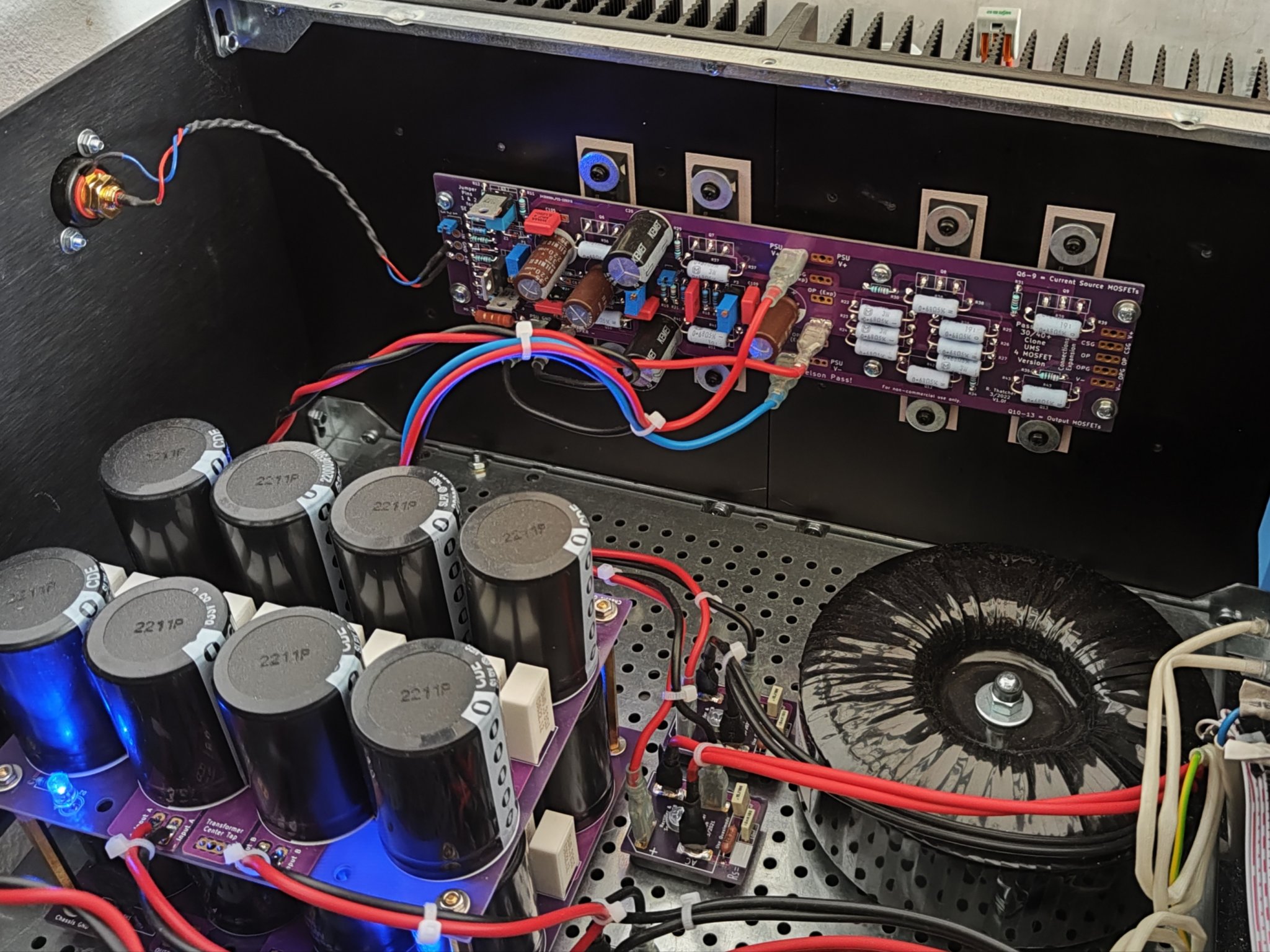

Decided to add spacers beneath the perforated bottom panel where they bolt to the side rails - otherwise, tightening the screws and nuts would distort the rail and the bottom panel a bit.

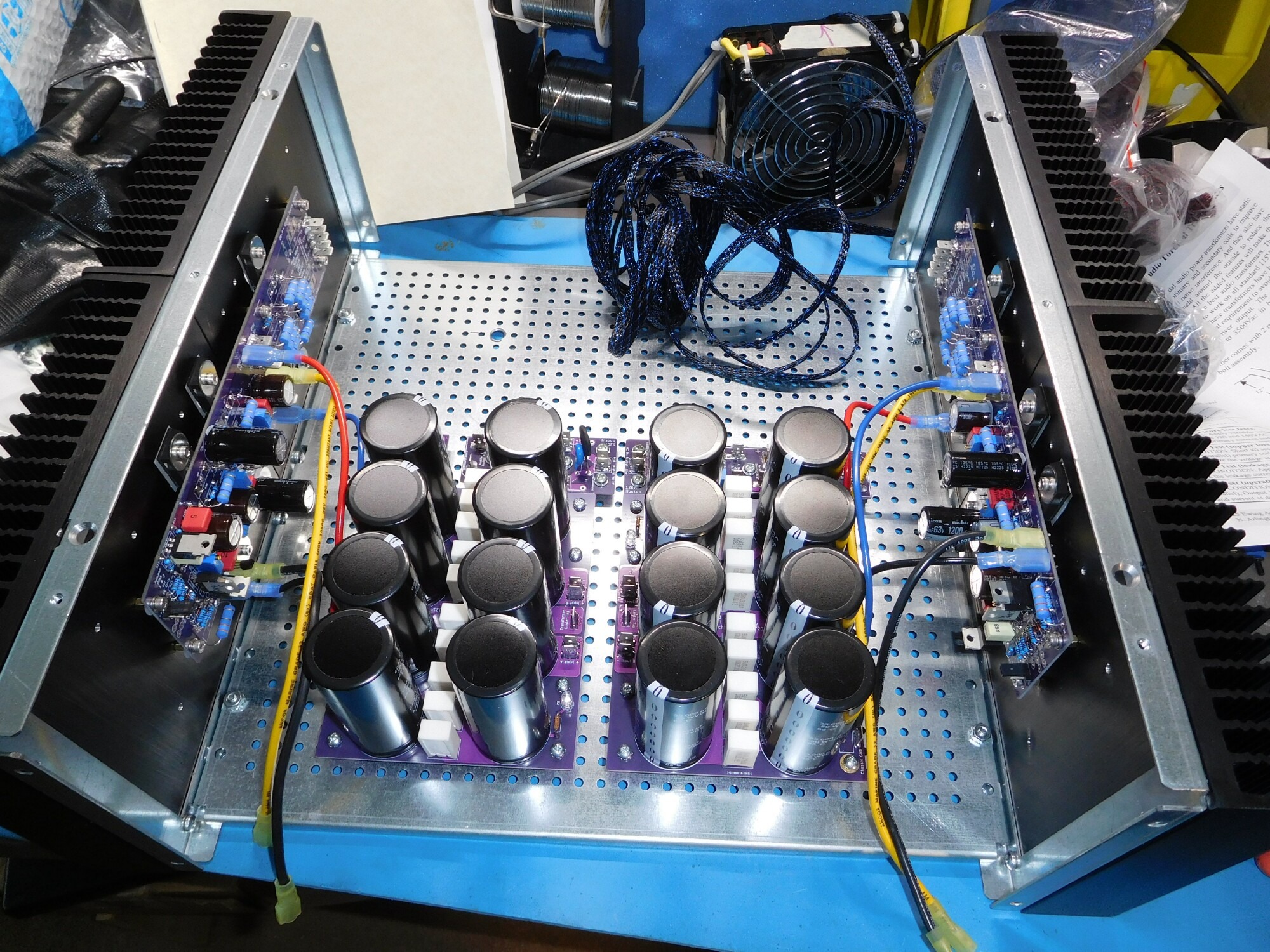

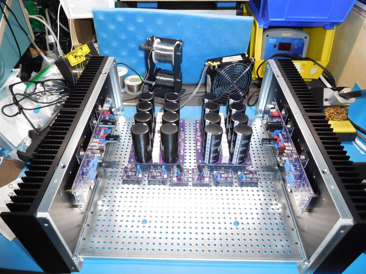

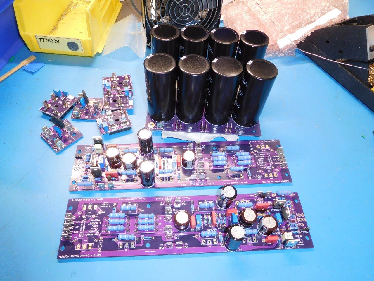

Supply wires to boards now fitted. Used 12 ga. for speaker leads, 14 ga. for power to boards. Techflex just arrived, so transformers will go in next, but AC supply wiring will happen after more wire shows up.
I decided to install the cyan LEDs on the V8 PS boards, and run fiber optic light pipes to the front panel just to be tricky. Still have to mill holes in the front panel, but still debating whether I use 1 per channel or 2, in what configuration, and how spaced/placed in the front panel. I'm not installing a switch on the front - just the LEDs.
Any suggestions anyone?
