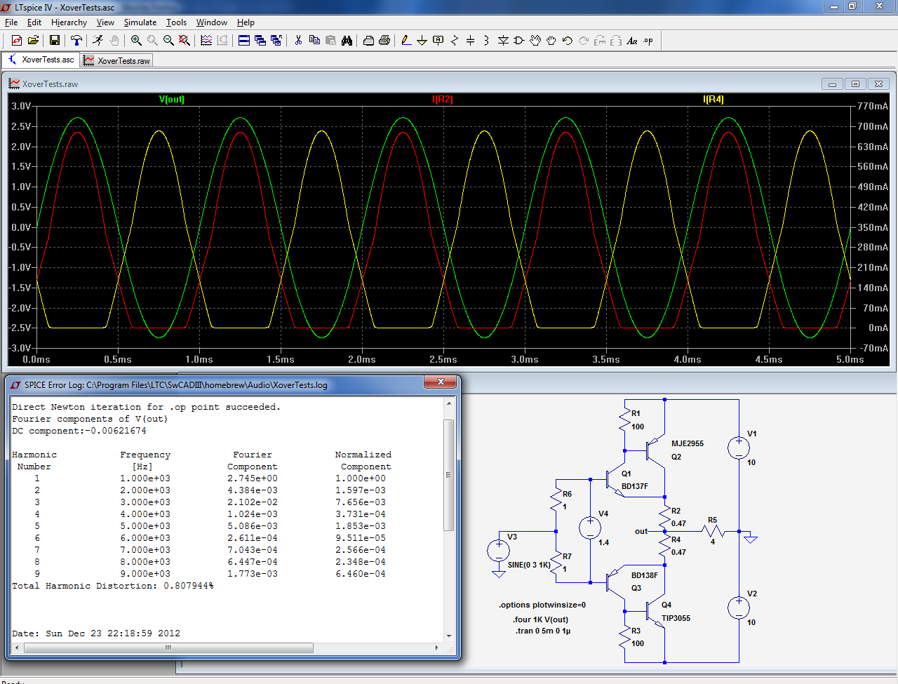

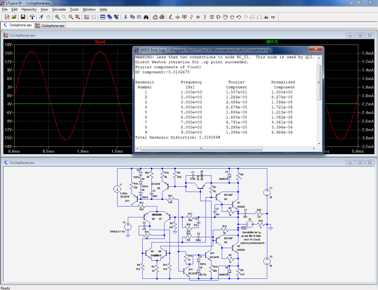

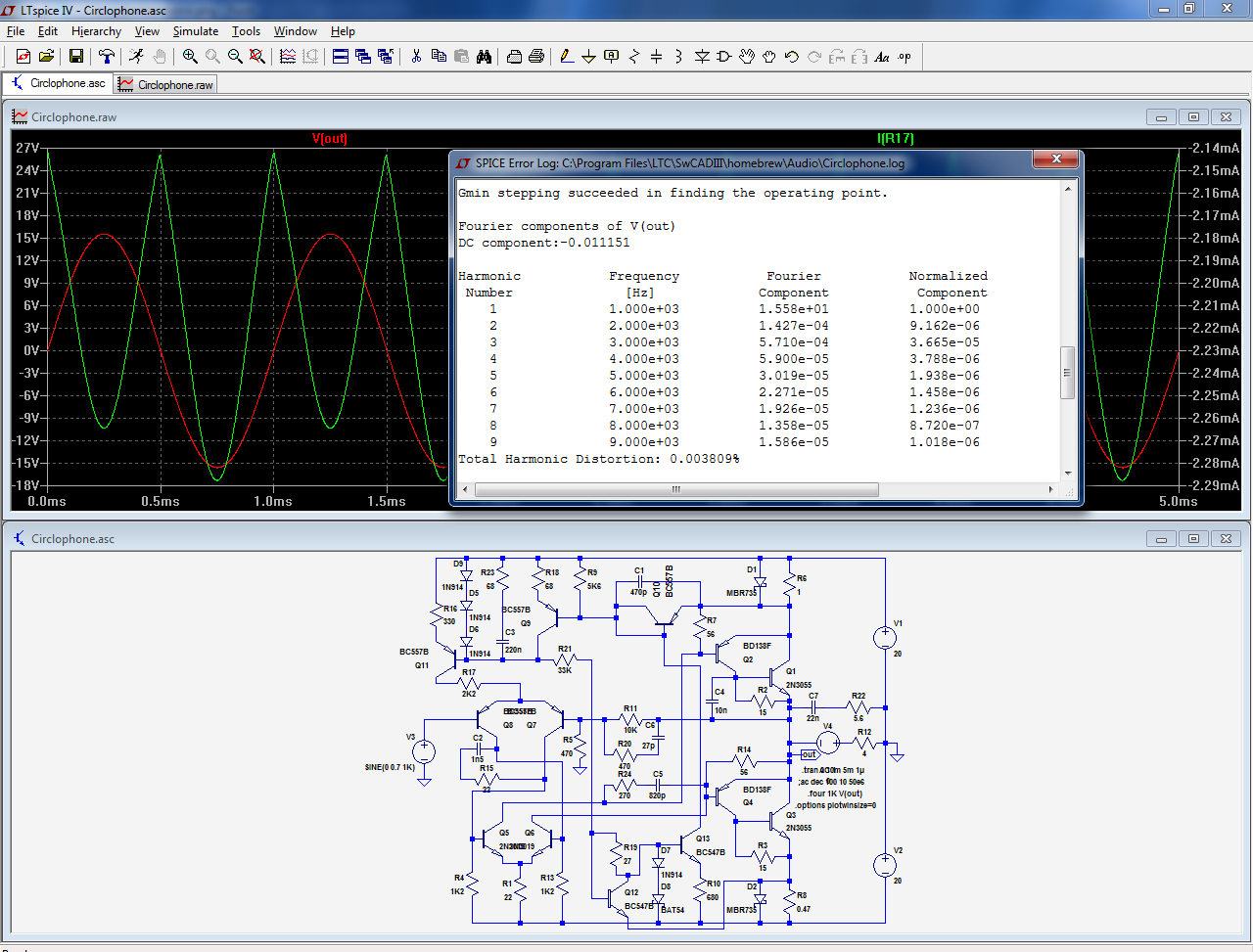

There are exceptions: I can think of at least two, the Renardson scheme, and the Circlophone.
In the Circlophone, the servo circuit participates to the global linearization of the amplifier.
This is easily seen by disabling the servo, and replacing it by a fixed bias of identical average value:
At first instance I also didn't believe my eyes when I simulated these circuits.

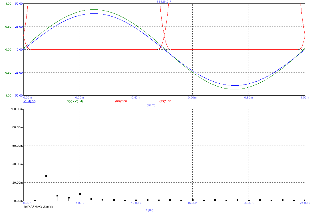

I hope it helps when I visualize the effect of common mode control loop. So let's look at the difference between input and output voltage of the OPS (i.e. the residual). Notice that the input voltage is defined as the mean value of the base (or gate) voltage of the 'top' respectively 'bottom' OP device (i.e. (Vb-npn + Vb-pnp)/2 ). This makes sense as in a typical amp with sliding bias, Cdom is split into two halves, one connected to the (input of the) top driver and the other connected to the bottom driver (see: Bob Cordell about the LT1166).
Fig. 1 depicts the behavior of an OPS with fixed bias.
Blue = output voltage,
Red = emitter currents
Green = residual
Black = harmonics.
The residual looks almost like a perfect sine and indeed, the distortion is quite low: 0.03%.; mainly 2nd harmonic distortion due to non-ideal complementarity of the OP devices.

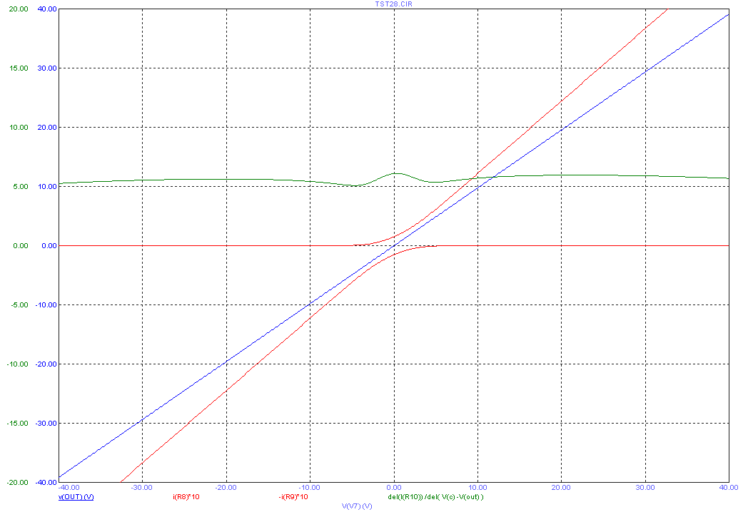

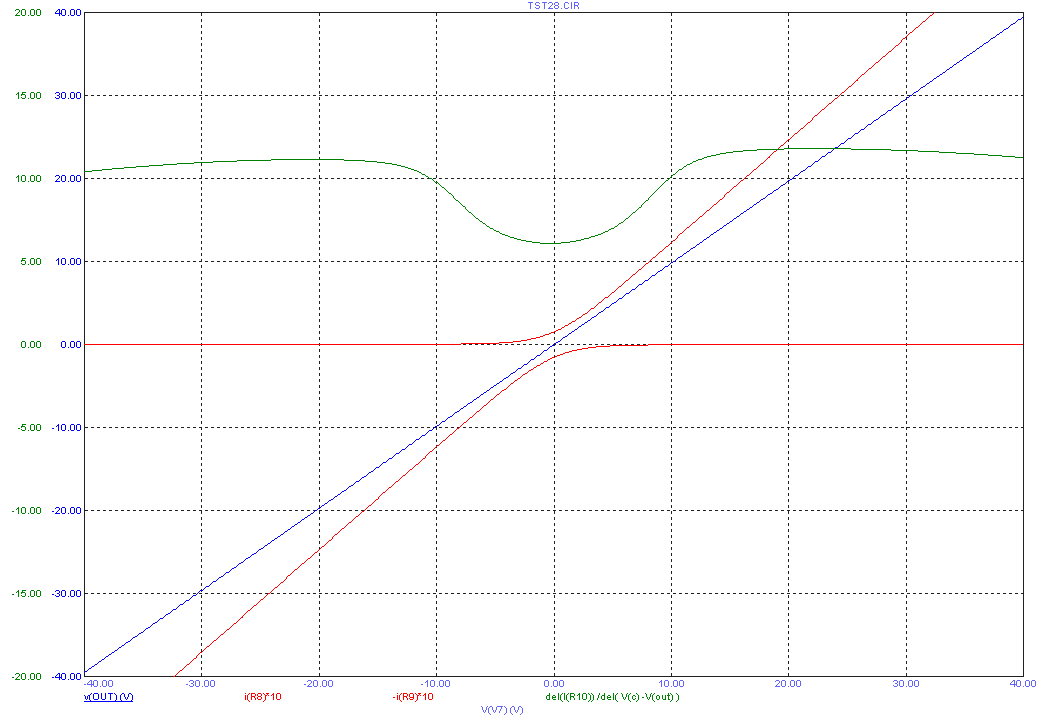

Fig. 2 depicts the behavior of an OPS with a sliding bias.
As expected, the amplitude of the residual is smaller. Simply because the OP devices are never turned off completely. BUT.... the shape of this residual is far more distorted. As a result, THD is about 2.5 time higher, mainly 3rd harmonics.
BTW, this has nothing to with gm doubling inside the crossover region, rather an increase of gm far outside the crossover region.
See fig.3: gm with fixed bias and Fig. 4: gm with sliding bias (green curves).
E.
