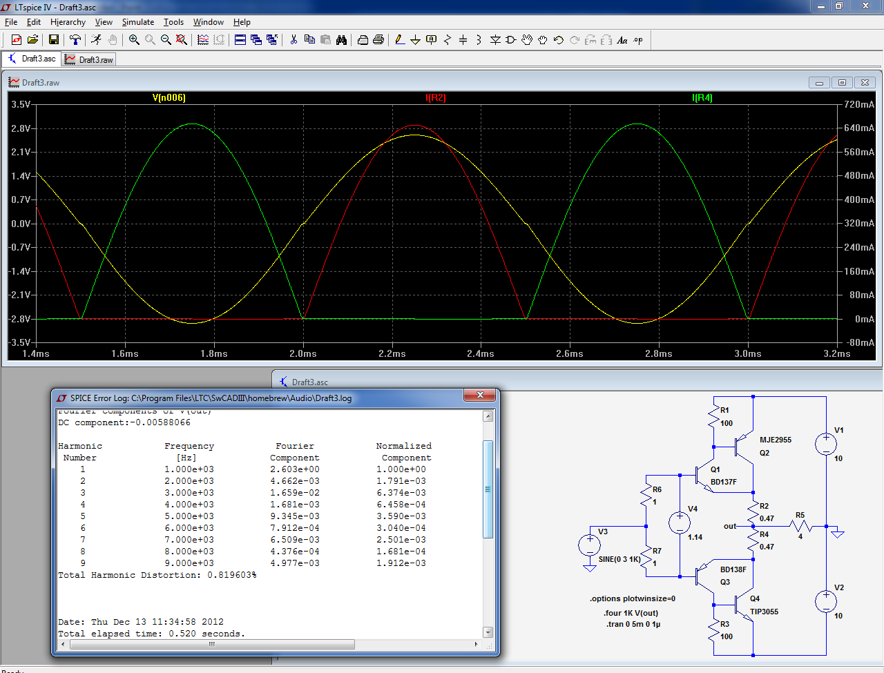

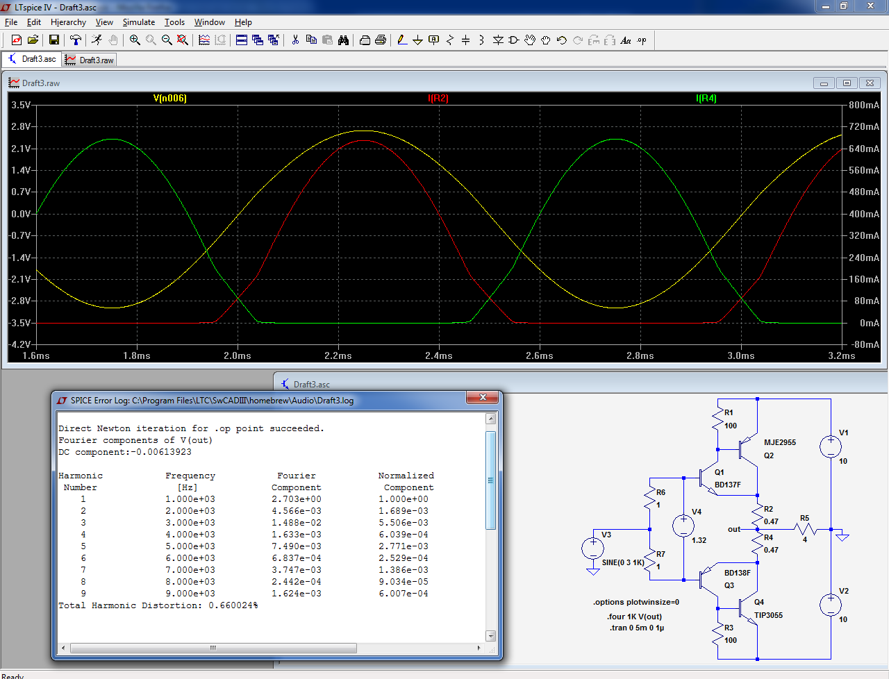

I more or less agree: that is the reason why I placed the sign ~ in front of doubling.As for gm-doubling - Oliver's term, also a great engineer in the early days of ICs - it is misnamed.
Actual doubling could only happen in extreme overbias situations.
What is generally observed is an increase of the apparent transconductance when the stage is overbiased.
This can be illustrated with this example. It is a CFP because it makes the phenomenon very clear-cut and easy to observe.
First, the situation with underbias: there is an increase of the output resistance (1/gm) in the crossover region, leading to Xover distortion.
Second, the stage is properly biased and the THD is minimal. Note that it is almost pure second harmonic, meaning it is caused mainly by the poor complementarity between devices, not by the biasing level.
And finally, the overbiased case: the THD has increased again, and if we look at the currents waveform, we see that in the part where they overlap, there is a change in slope: both output devices now contribute to the output signal, and each reduces its contribution by an inherent feedback mechanism, but the effect of the "~doubling" (see caveat above) remains, as the THD shows.
I have used a CFP because it shows very neatly the changes in slope, but the effect is present in any stage, even if it is somewhat blurred.
Why would one want to overbias an output stage, knowing that it leads to increases Xover distortion?
There could be a number of reasons.
-Although the THD in under/ overbias situations is comparable, the underbias one is much more objectionable from an audibility perspective, and since the bias setting is not very accurate, one prefers to remain on the safe side, even if it leads to increased distortion.
-Some people advocate a class AB, with a strong and wide A region, to move Xover problems towards a higher listening levels. I am not sure it is a good idea, but I do not judge the validity of one philosophy over the other, I simply examine the consequences.
-When the stage is optimallly biased, the output resistance is not flat for the Xover region, it has "ripples", which some feel are more detrimental than a continuously too low resistance. Here again, it is a matter of taste.

Post53 plots are very interesting and confirm what has been described many times before.
I note, for those that haven't spotted it yet, that the optimally biased has substantially 2nd harmonic, whereas the under-biased and over-biased have gross amounts of odd order distortions. Even the ninth of the under-biased is still more than the second.
In the over-biased operation the 7th and 9th have fallen to lower than 2nd. That seems to indicate a "sound" quality that may be better than under-biased. This is what an earlier poster stated, that if not optimally biased then over is better than under.
These high and odd order are Spikes that get added to the harmonious signal. It is the relative "size" of the spikes that makes them audible. They are narrow and thus contribute less to total percentage distortion than would a wide harmonic addition of similar "size". This gives an under representation of the "size" of the spike contribution to the signal resulting in the misleading impression that low numbers for crossover distortion cannot be heard.
0.1% of crossover distortion will sound quite different from 0.1% of second harmonic distortion where there are unmeasurable levels of the higher orders.
A blanket philosophy has developed that 0.01% of THD is inaudible.
I don't have the expertise, nor the instrumentation, to challenge that philosophy.
What I can do is recognise that 0.01% of low orders of THD are a very different animal from 0.01% of high and particularly odd orders of THD.
Simple total THD tells us virtually nothing, at least that's what I am led to believe. Aksa is a proponent of a gradual declining of all orders from 2nd down to wherever they become inaudible and/or unmeasurable, as an indicator of good sound.
Very few, if any commentators, have come to my notice to challenge this philosophy.
On the basis that some of the spikiness of crossover is what makes for bad sound then Optimal ClassAB bias must the the only way to progress if ClassA is energy wasteful and to be avoided by all that want to save the Earth.
